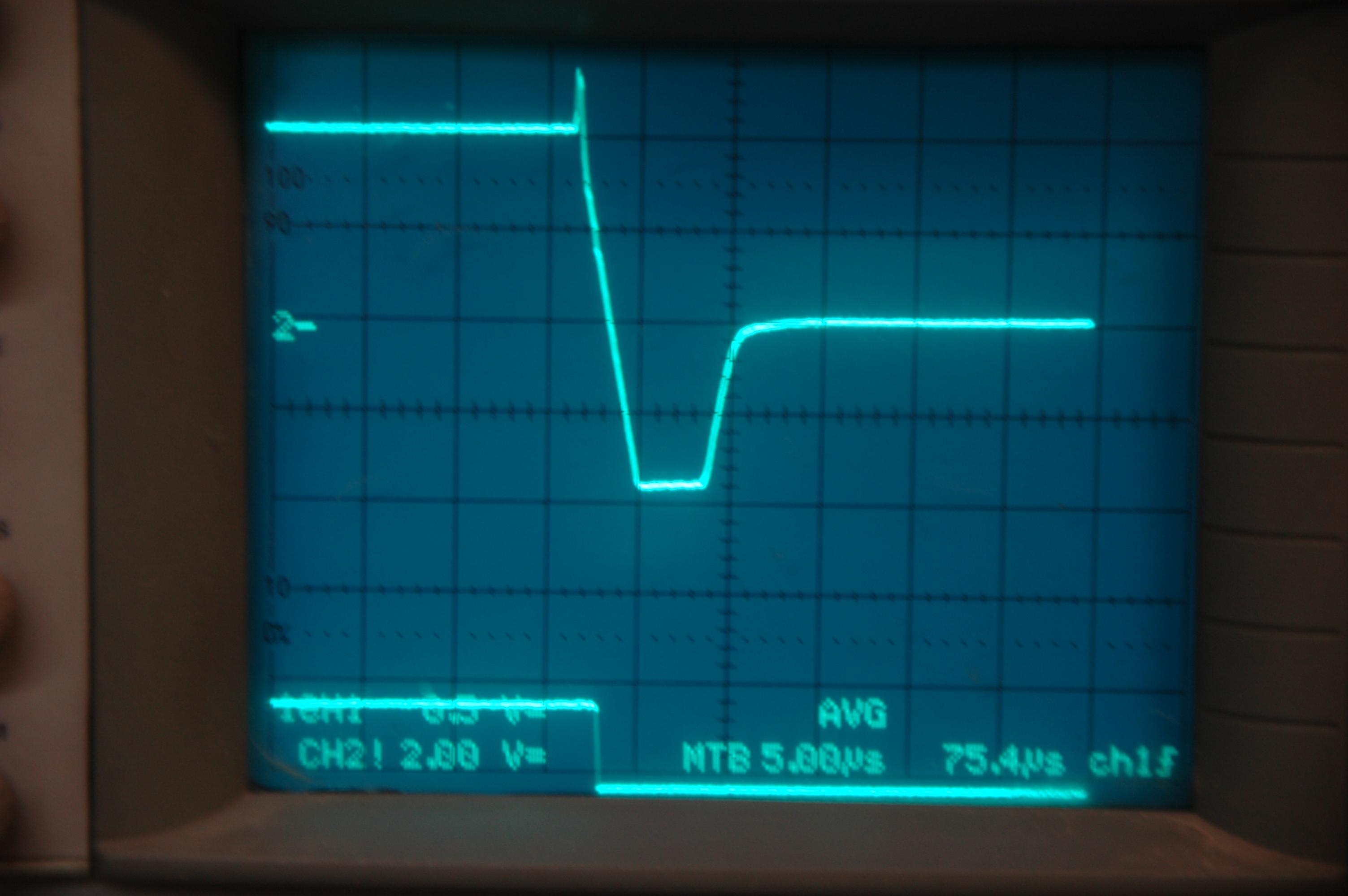

    I am at the preamp stage of the voodoo tonight i will progress.
    I tested the Voodoo preamp with a 300 uh 30 awg flat planar coil I knew was pretty fast.
    Just trying to get a idea of the Pi front end portion of the voodoos capability.
    the following shot is with a Maxim 412, I also tried a 4562, it was faster but it wasn't as clean.
    [ATTACH]53973[/ATTACH]
    I have only tested the dual d on the Mpp but I took off my preamp and went to stock except for a 4562 amp.
    this shot is of the coil balanced on a signal gen it worked pretty well but further testing and playing with the Rx coil I was able to get a little better performance bringing the nugget into play.
    This coil is pretty forgiving I can even stack the rx right on top of the inner tx.
    I don't know what to even call it it could be considered everything from a omega to a concentric and dual d. All depending where you put the Rx coil.
    I'm building two larger size Rx d coils to see what happens to the depth and sensitivity of this coil where the trade off is.
    [ATTACH]53974[/ATTACH]
    Thanks again for the great job on your videos.
    Thanks for the images. I do like the 4562 as well. You are doing good work with the coils.

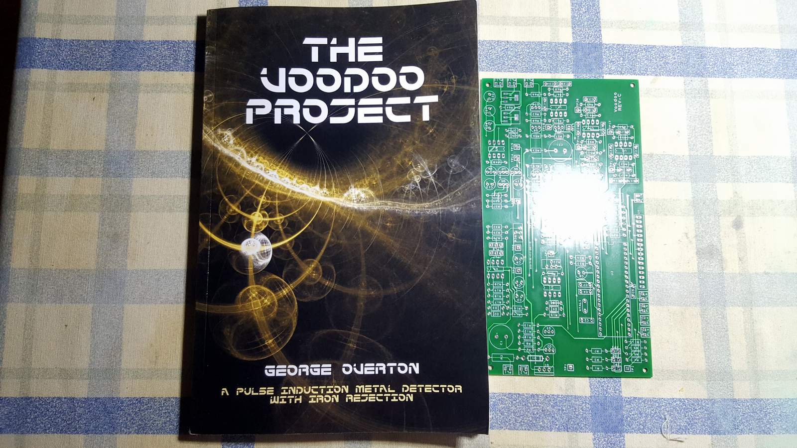

    • Finally arrived...
      • Reading a book...
        thoroughly and meticulously done... nothing less i expected from George.
        My hat down to this!
        Preparing order, component lists, tomorrow will place order to local supplier.
