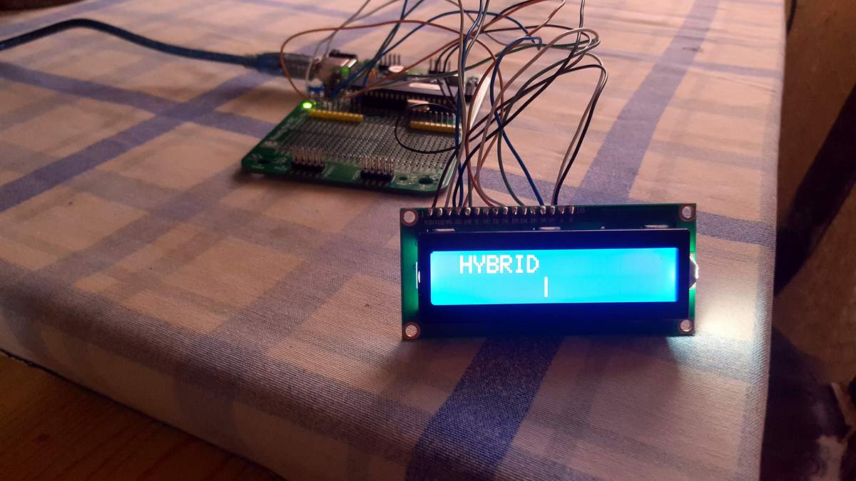

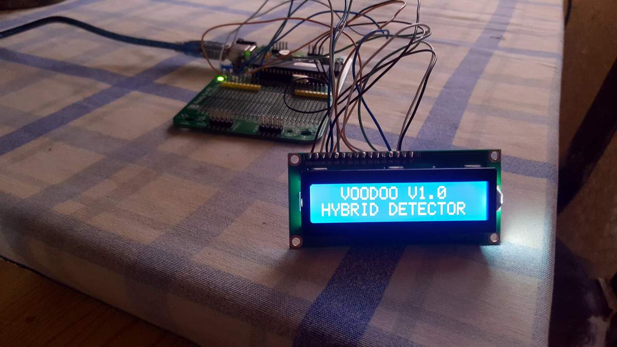

        • I don't know what happened in meantime... but today just for fun i tried again to build from source in mikroC PRO for PIC 6.6.3 and it DID !??
          No errors. Builds fast and fine.
          So i flashed 18F45K22 on "Ready for PIC" board.
          Ok, i assume when put in detector hardware; some functions will probably misbehave due differences between 18F4520 and 18F45K22.
          But this is at least something. Now i am sure i can use this development board for flashing 18F series.
          Also i can compile and build the code with mikroC PRO for PIC 6.6.3.
          As completely AVR user i see this as successful attempt.
          I was thinking to buy Pickit3 programmer especially for this project. Now there is no need. "Ready for PIC" is finishing the job just fine.

          To make this to work i had to change few lines in the code.
          Instead of this:
          Code:
          // LCD assignments
          sbit LCD_D4 at RB3_bit;                          // Data line 4
          sbit LCD_D5 at RB2_bit;                          // Data line 5
          sbit LCD_D6 at RB1_bit;                          // Data line 6
          sbit LCD_D7 at RB0_bit;                          // Data line 7
          sbit LCD_RS at RB5_bit;                          // Register select
          sbit LCD_EN at RB4_bit;                          // Enable
          // LCD Port direction
          sbit LCD_RS_Direction at TRISB5_bit;             // Register select
          sbit LCD_EN_Direction at TRISB4_bit;             // Enable
          sbit LCD_D7_Direction at TRISB0_bit;             // Data bit 7
          sbit LCD_D6_Direction at TRISB1_bit;             // Data bit 6
          sbit LCD_D5_Direction at TRISB2_bit;             // Data bit 5
          sbit LCD_D4_Direction at TRISB3_bit;             // Data bit 4
          I had to put this:
          Code:
          // LCD module connections
          sbit LCD_RS at LATB2_bit;
          sbit LCD_EN at LATB3_bit;
          sbit LCD_D4 at LATB4_bit;
          sbit LCD_D5 at LATB5_bit;
          sbit LCD_D6 at LATB6_bit;
          sbit LCD_D7 at LATB7_bit;
          sbit LCD_RS_Direction at TRISB2_bit;
          sbit LCD_EN_Direction at TRISB3_bit;
          sbit LCD_D4_Direction at TRISB4_bit;
          sbit LCD_D5_Direction at TRISB5_bit;
          sbit LCD_D6_Direction at TRISB6_bit;
          sbit LCD_D7_Direction at TRISB7_bit;
          // End LCD module connections
          Since previously i wired up the LCD according to LCD example that came from ME.

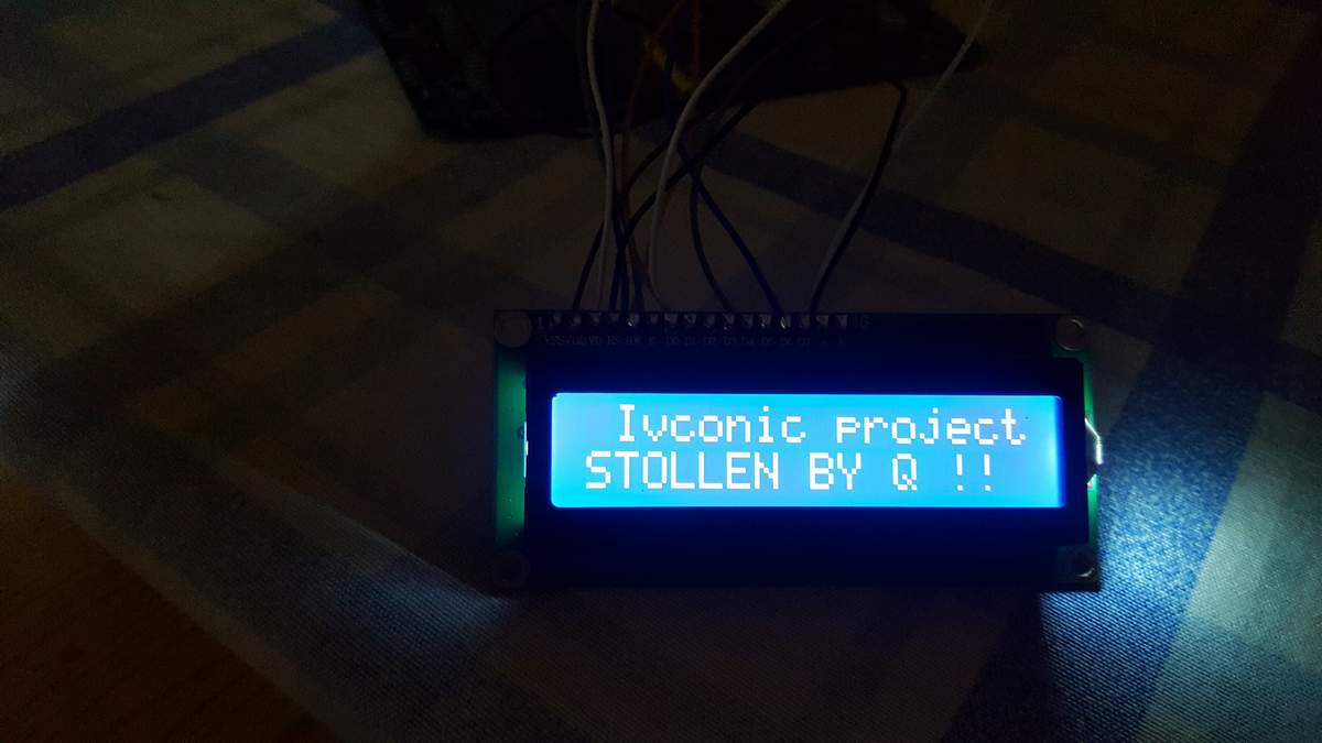

          • Wow!
            There is a eastern egg hidden in the code!
            Press all the buttons together and switch it On.
            Than it displays this:
            :rotfl

                But you've spelled "stolen" incorrectly. "Stollen" is a traditional German fruit bread that is eaten during Christmas. :lol
                  Vomiting?!
                  Oh no!
                  It is covid!
                  URGENTLY you must drink glass of bleach to save yourself!
                  Hurry up, minutes are in question!
                      Me?
                      Nooo!
                      I guess this is due incompatibility between 18F4520 and 18F45K22!
                      I'll have to obtain 18F4520 to straight this up!
                      BTW it makes sense.
                      When you put it in sentence properly than it says:
                      "It is traditional German fruit bread by Q !! "
                      But there is no place in 16 characters line for this.
                      All the troubles started because you didn't want to share with me you version of mikroC PRO for PIC!
                      Look what you have done!
                      :rotfl

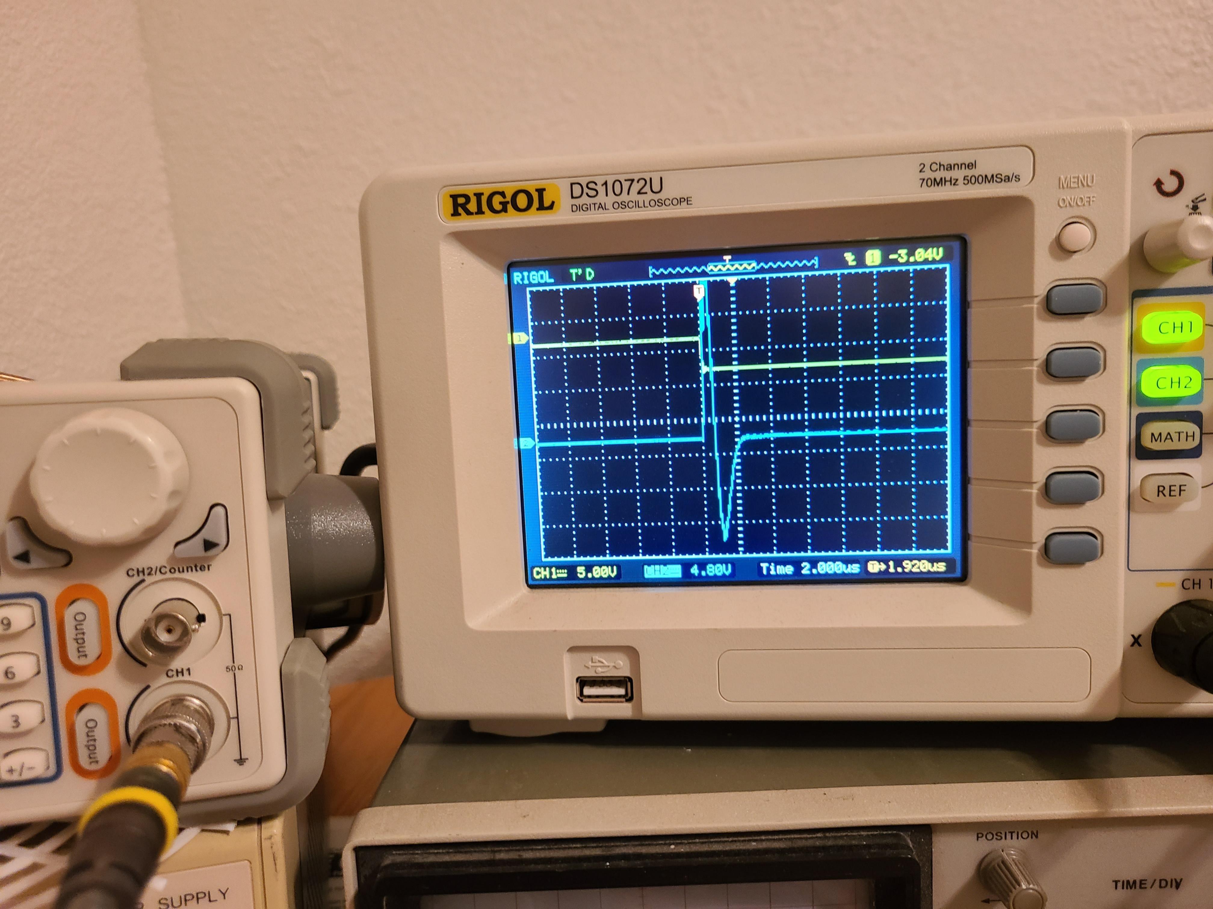

                        • Originally posted by surfdetector View Post
                          Hi, I am unclear if you are testing your DD on the Voodoo at this time or currently just on the MPP? I would like to see a scope shot of the pre-amp output if possible. Your experimentation is very interesting to follow.
                          Hi surfdetector,
                          I am at the preamp stage of the voodoo tonight i will progress.
                          I tested the Voodoo preamp with a 300 uh 30 awg flat planar coil I knew was pretty fast.
                          Just trying to get a idea of the Pi front end portion of the voodoos capability.
                          the following shot is with a Maxim 412, I also tried a 4562, it was faster but it wasn't as clean.
Name:	voodoo preamp .jpg

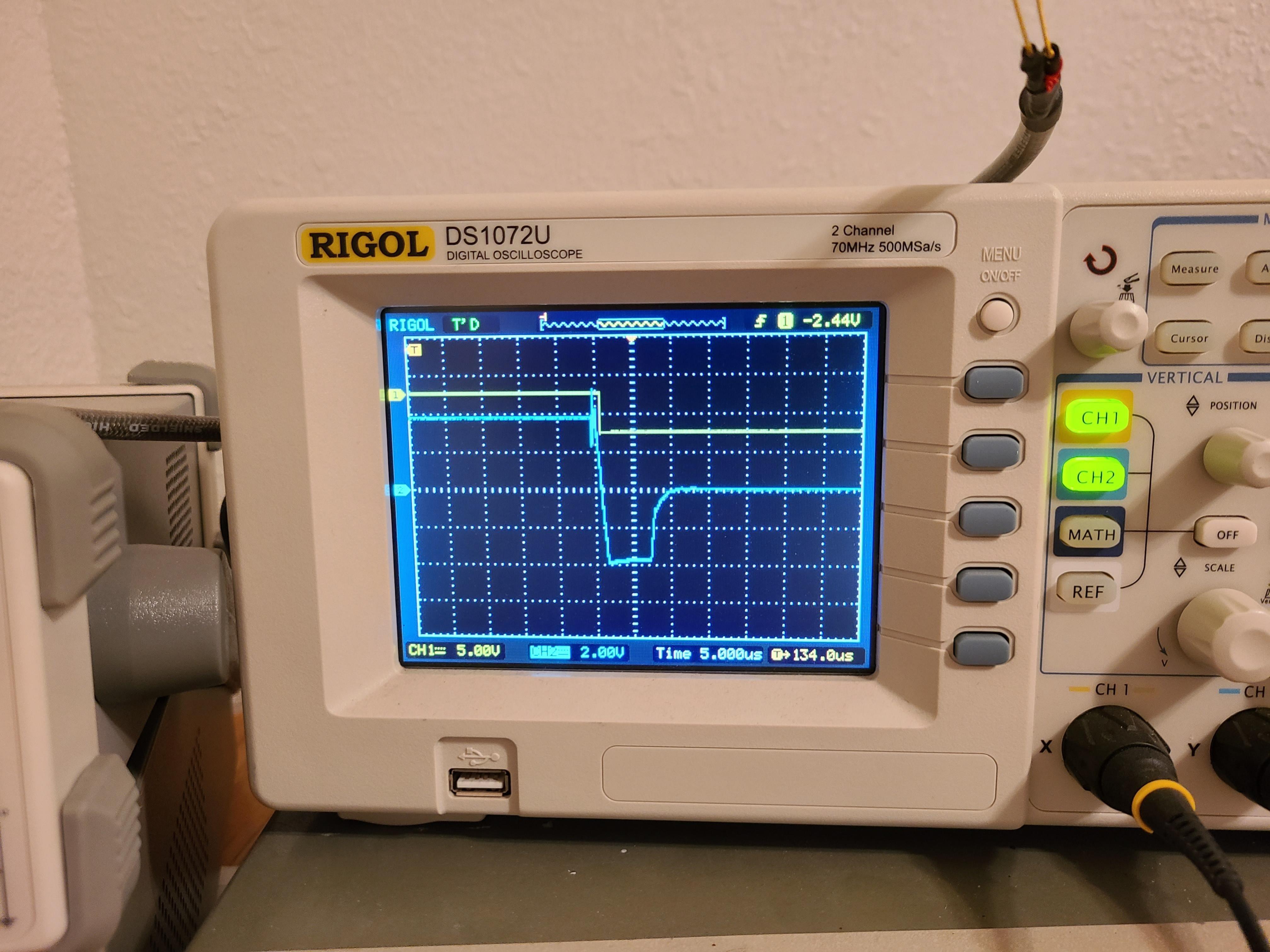

                          I have only tested the dual d on the Mpp but I took off my preamp and went to stock except for a 4562 amp.
                          this shot is of the coil balanced on a signal gen it worked pretty well but further testing and playing with the Rx coil I was able to get a little better performance bringing the nugget into play.
                          This coil is pretty forgiving I can even stack the rx right on top of the inner tx.
                          I don't know what to even call it it could be considered everything from a omega to a concentric and dual d. All depending where you put the Rx coil.
                          I'm building two larger size Rx d coils to see what happens to the depth and sensitivity of this coil where the trade off is.
Name:	dual d on mpp.jpg
