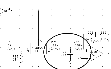

                  • Hello Don, would you know approx how many micro seconds after the TX pulse that your 4066 operates to take your Disc sample ?. thanks
                      I will check it out when I get a chance. It’s totally dependent on the resonant frequency of the RX coil. It will work over a wide range of frequencies as long as you can adjust your delay to cover the first cycle of the decaying sine wave. Also, the sample width needs to sample shorter than 90 degrees. If you check my previous post you can get an idea. I will take some measurements and post them up shortly..
                      • About DISC integrator, this is what I would intend to try:
Name:	Senza titolo.png

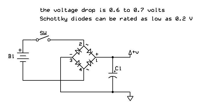

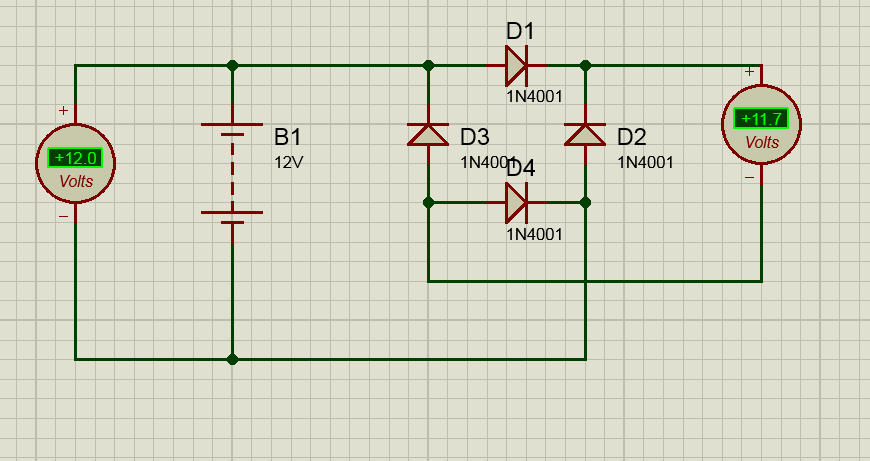

                            • Of course that's nice way to make protection.
                              But there are cases when you use high capacity batteries that usually provides higher nominal voltage than the working voltage in the device.
                              If you don't mind the voltage drop across the diodes; this circuit is the simplest but very effective possible protection against reversing the polarity.
                              I am using it at low consumption circuits (most of the I/B detectors) and when battery is with higher capacity.
                              Common detectorist in time becomes unsatisfied with frequent change of batteries and eventually one day decide to use "external" rechargeable accu with high capacity.
                              And that's where "tragedy" happens! After some time of use like that; it happens to reverse the cables that goes to battery and result is: lot of magic smoke around and dead detector.
                              I was pretty tired of such cases, some people will never learn, so after few repairs of the same damage: i started to use this protection.
                              SMW for example will run smoothly with 9v. Accu is usually 12V/1Ah. (charged 13.6v). So voltage drop across the bridge is not a problem.
                              You may call it stupid; but is saves the day. Users are satisfied and i am not annoyed to death by servicing same faults all over again...
