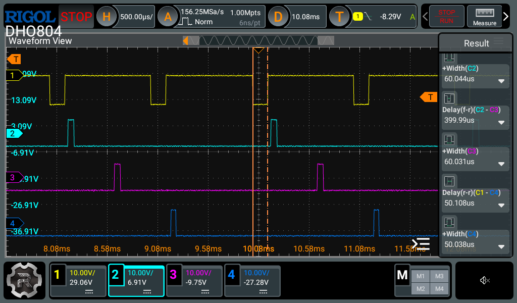

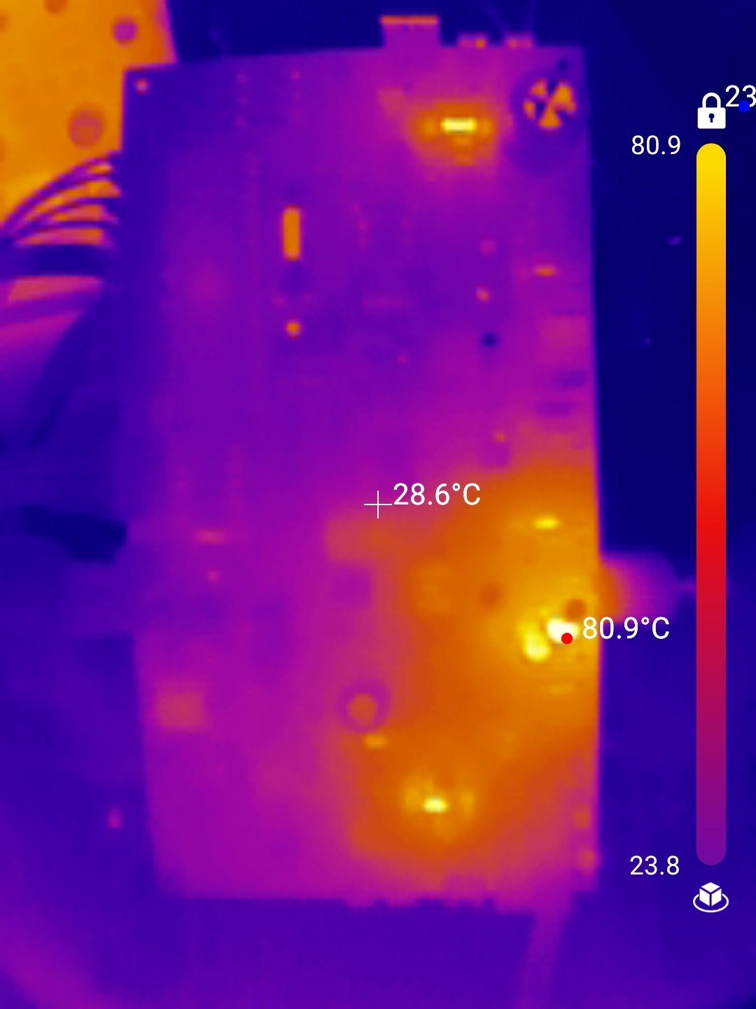

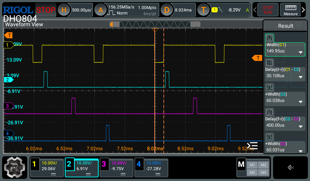

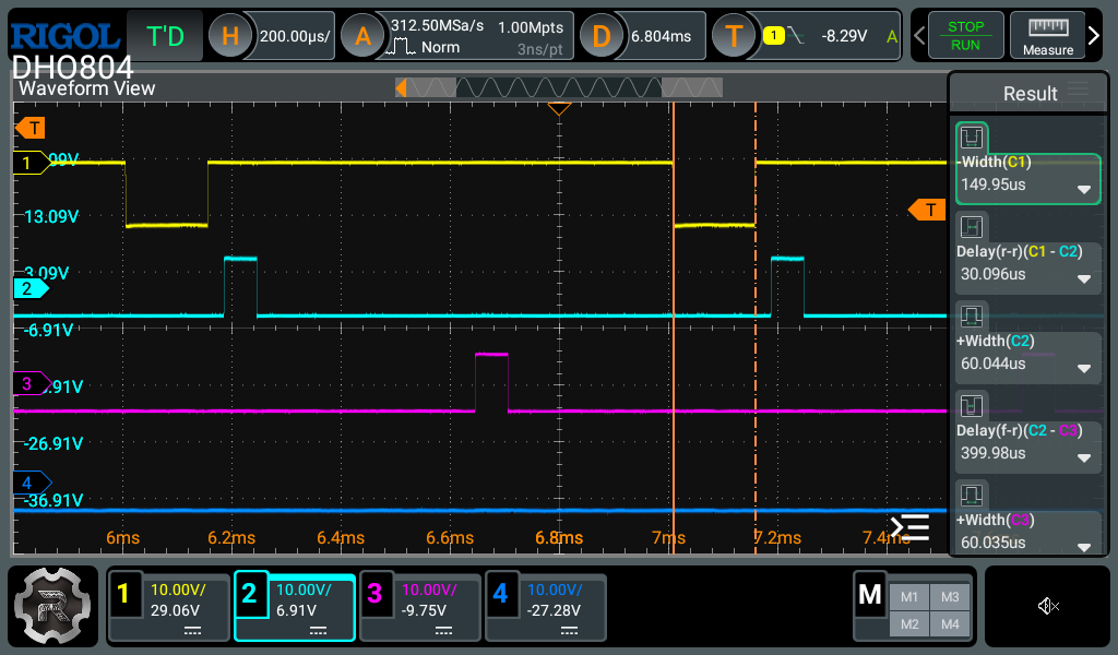

    • Hi all, as mentioned in a previous post here's an updated software for the Voodoo should anyone be curious. Details are in the previous post. I've included some scope screenshot showing pulse and hybrid modes.
      Yellow trace is Tx pulse at the junction of the anode of the diode and 470 ohm dummy load resistor.
      Cyan trace is the main sample pulse at TP10.
      Magenta is the EFE sample pulse at TP6.
      Blue is the Disc sample pulse at TP11.
      I've also included a thermal image of the board with dummy load. No surprises that the 75L09 regulator is getting pretty hot with almost 100mA total current draw from my PSU.
      You can see the alternate disc pulses appearing in hybrid mode from the scope pics.
      • Looks good.
        • Thanks George, I'm really pleased with the resultant super stable pulse trains and faster loop time in the software. Hopefully someone with a working detector can give some feedback on the performance vs 2.02. Sampling should be super smooth too.
