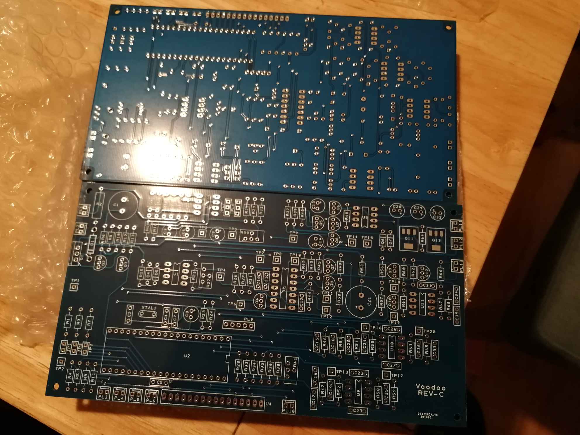

                • Hmm yummy yummy pcbs has arrived
                    [ATTACH]53583[/ATTACH][ATTACH]53582[/ATTACH]
                    it's beautiful ...
