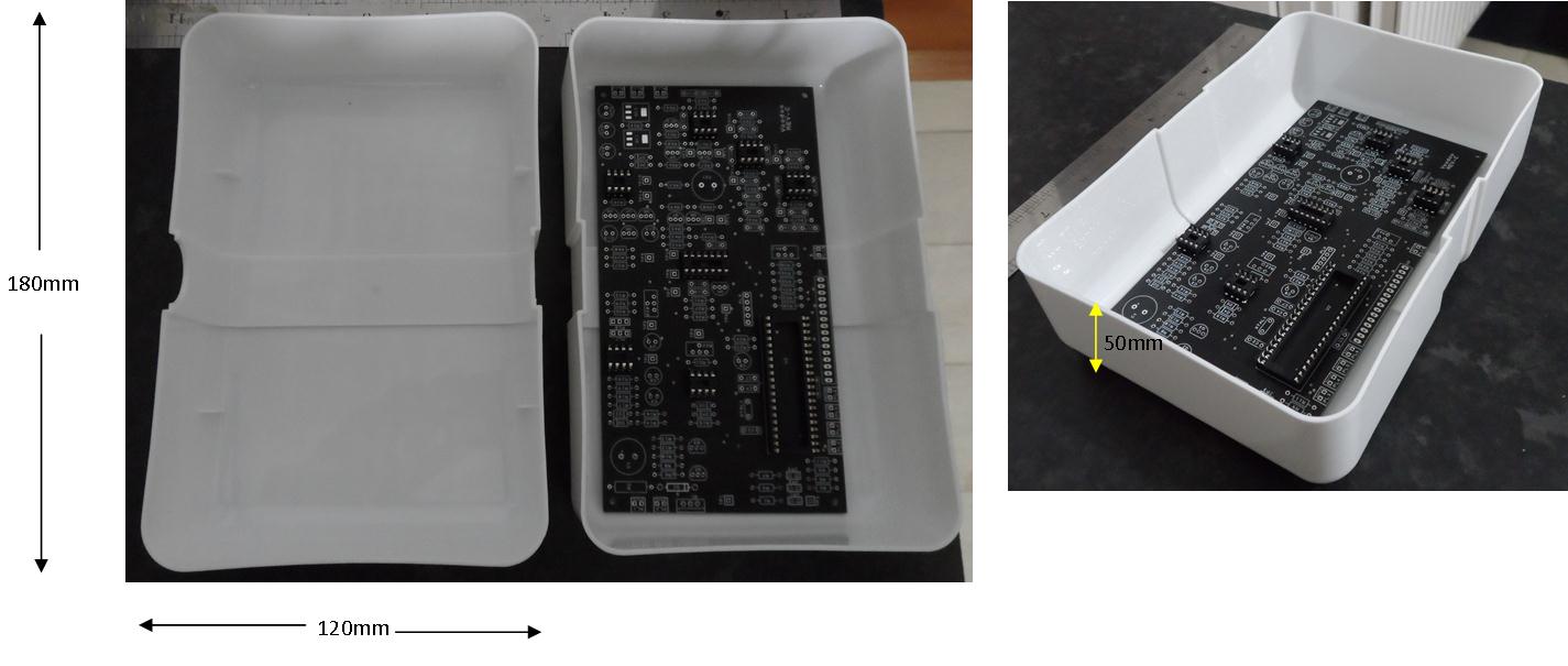

  • Hi Alec,,,I have a plastic enclosure that I may use but I haven't fully decided on whether to use it or not yet. I posted a pic of it with the dimensions. It is 50mm deep but if I decide to use it I may cut the top off it to make it around 35mm deep or so that there's just a bit of clearance on the tallest components. The lid fits snuggly over the bottom part. I don't intend including the Battery charge board and battery in the same enclosure as I want to be able to use 18650 batteries and change them as they deplete in the field. This enclosure is only a 'Maybe' at the moment. The handle is going to be made in 2 parts with a hollow centre to accept the LCD/Menu button cable and will join to the top part of the enclosure that will slide directly over the detector shaft. I have some other ideas so I won't know which enclosure I will decide on until I reach the LCD Section of the build. I'm enjoying your 'HammerHead' build videos!,,Do you have the Gerber files for that particular pcb you're building on the Video? With the Mirage being my favourite detector I've always wanted to tackle the HammerHead and the Crossbow to add to my collection. Stay safe Alec, Regards, Marty.

        I don't intend including the Battery charge board and battery in the same enclosure ...
        The battery charger not intended to fit in the detector enclosure. It is an external unit.

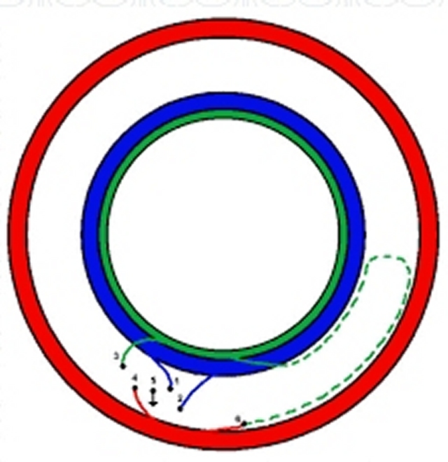

                • Here is a slight variation on the concentric coil it has a small loop for fine tuning the null.
                  • hi 6666
                    i am thinking you must connect the end of the red wire to starting of the blue wire not the green.
                    in this case that is difficult to nulling the concentric coil and you cant add or reduce laps the green wire for best inductance and best nulling .
                    best regard
                    zakari

                      I think that in the picture the Green bucking coil is actually sitting on top of the Blue RX coil. If so, that enables you to adjust the Green bucking coil, which makes the connections shown to be correct.

                        correct,
