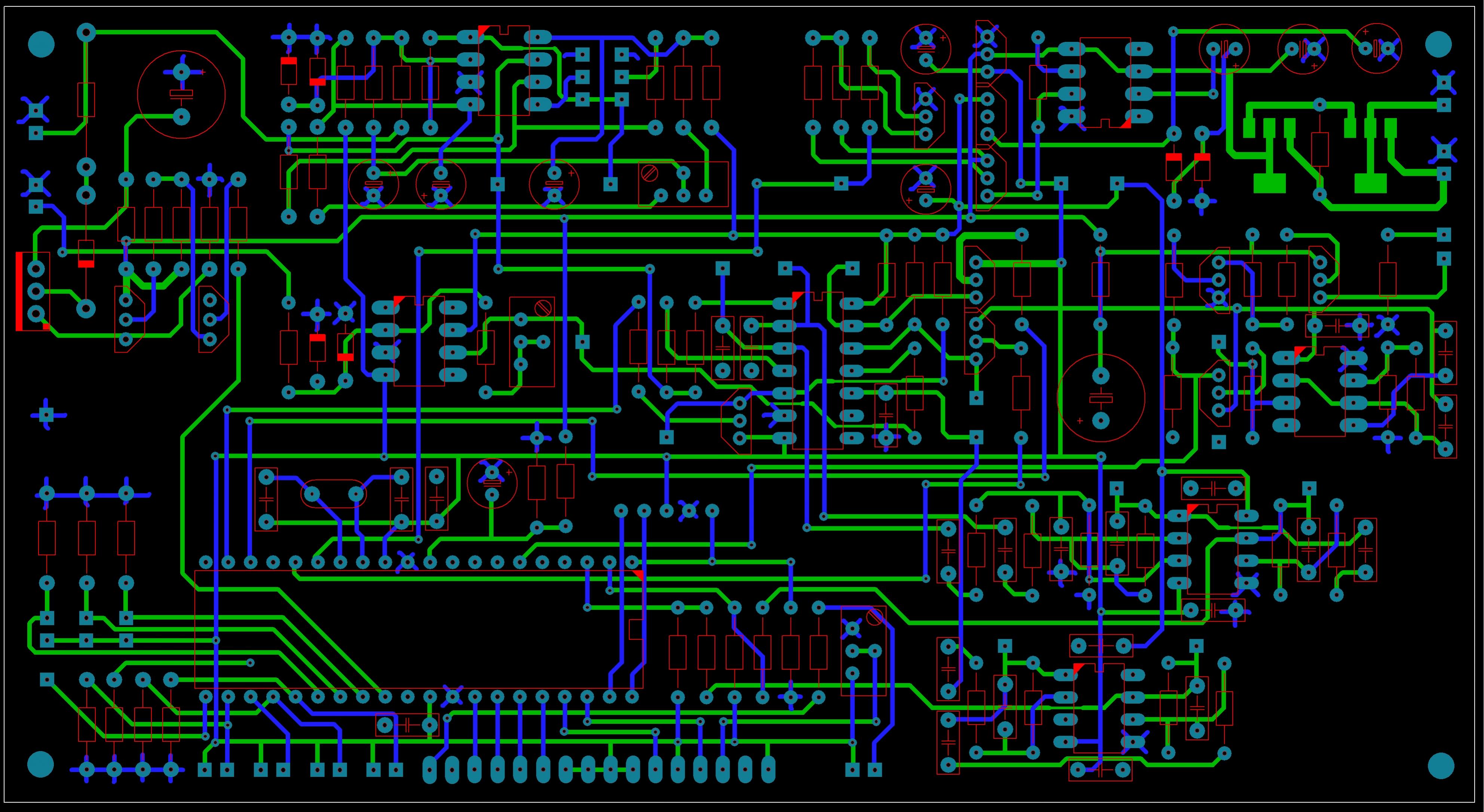

    Hi, thanks for the gerbers , this is a big pcb, 89x165mm, just before I order them so they get here before the book, are you reasonably convinced all is correct on the pcb ?

      Sorry to say; pcb is just awful.
      Kind a war crime... the pcb!
      Everything i hate to see on pcb... is there!
      Very thin traces, small transistor footprints, traces goes between chip pins etc.
      Pins are just too close, clearance is very small... THAT'S BAD FOR DIY AND HOBBY!
      And yet ... PCB IS SO HUGE! Lot of unused space on it!
      This kind of pcb standard is not suitable for hobby and diy. This is disaster.
      One who makes lot of diys and solder too much joints; knows what i am talking about.
      This is suitable only for manufacturer who makes devices and sells them without worries what happens later.
      Even if this pcb is made by JLPcb in highest quality standard; it will be hard to solder components on it neat and clean.
      Simple because footprints are so small, especially on transistors and regulators.
      Like i said; not for hobby. Far from it.
      Vias diameter is also too small.
      Writing all this i am having all the time picture in my mind about what will happen later if we want to service it or mod it?
      I am telling this from 32 years of experience in dealing with such stuff.
      Obviously George is using some garbage software for drawing pcbs. Seems no triangular transistor footprint in there?
      This pcb must be completed once and than never touched again. It must work correctly from a start.
      Once completed; just "lock" it in enclosure and never again try to work around it.
      So even now from this point; forget about any eventual modding on it. Simply because it will be total mess once you try to unsolder some of those components.
      Or move some legs, pins, or replace something. Thin traces will break. Soldering will not be neat etc.
      George please do not take this as attack, offend or anything similar. This is just very friendly constructive criticism.
      It must be drawn another better and far smaller pcb for this.
          Plus voltage as ground plane?
          Why?

            It is quite a large board, but was made to fit a particular enclosure. Obviously it could be made smaller, or even a different shape.
            There are many ways to skin a cat, and people like to take different approaches. I'm sure there are other ways to implement the Voodoo concept (using different processors, etc.) and I look forward to seeing what others come up with.
              The PCB used in the book version is REV-B. and the Gerber files are for REV-C. The only difference is that REV-B had a connection missing to 0V in the audio oscillator circuit. I corrected that in REV-C.
                I would have been surprised if you'd said anything different.
                I have the latest version of Easy-PC.
