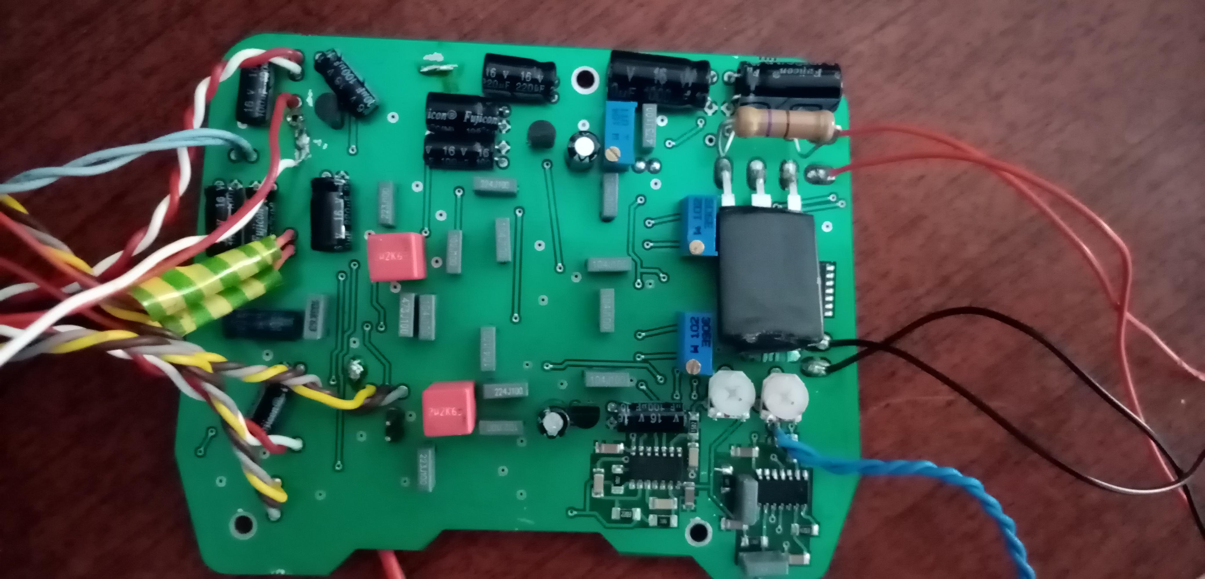

                            • The best pulse detector with 90 percent discrimination as vlf is in my opinion one detector and the only one for now is the new detector from the picture I will set the top side of the pcb..It can work with both mono and dd coils depths indisputably similar to gpx minelab I am sincerely delighted, The tdi-sl that I finished but not in the box is also very good but I am bothered by tc holes this pulse has almost no tc holes at all!Click image for larger version

                                The TDI has target holes because it attempts to discriminate using conductivity, whereas Voodoo has not target holes since it provides true ferrous / non-ferrous discrimination.
                                The Minelab GPX iron reject works differently to all other detectors. When the coil passes over a ferrous target, it momentarily blanks out the threshold but doesn’t go completely silent. It also creates an audio "tail" as you move away from the ferrous target. Apparently it works this way to avoid missing certain gold nuggets that may also get rejected.
