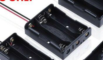

    Im using 12 cells at 16 volts then stepping it down. Because with 3 cells you only use around 30% of the battery. With 4 you use around 40% of the battery. Minus the little you use in the converter.
    just use one of these, and reverse the center or end one, so you get 12 volts, youll want 2 negs and 1 pos on one end.
Name:	3x18650 holder.jpg
    J $2.69 with free shipping from ebay
