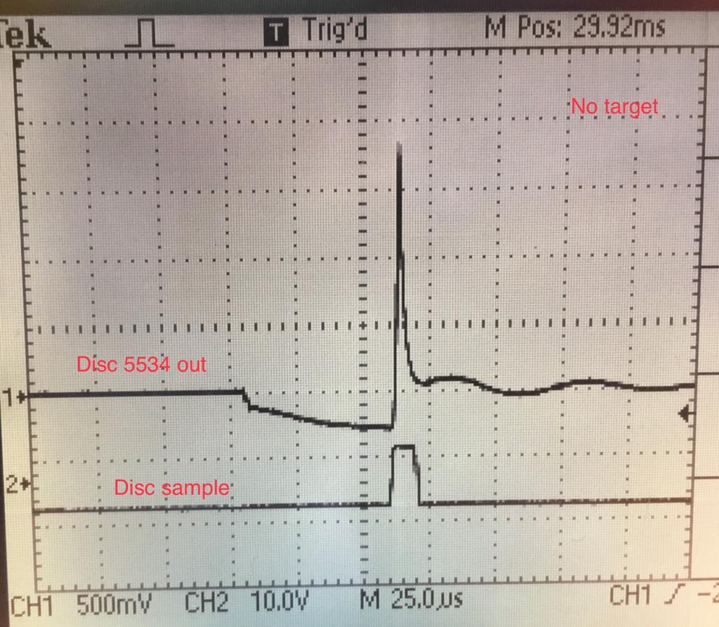

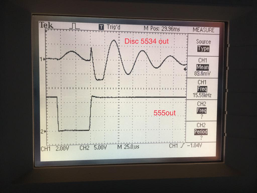

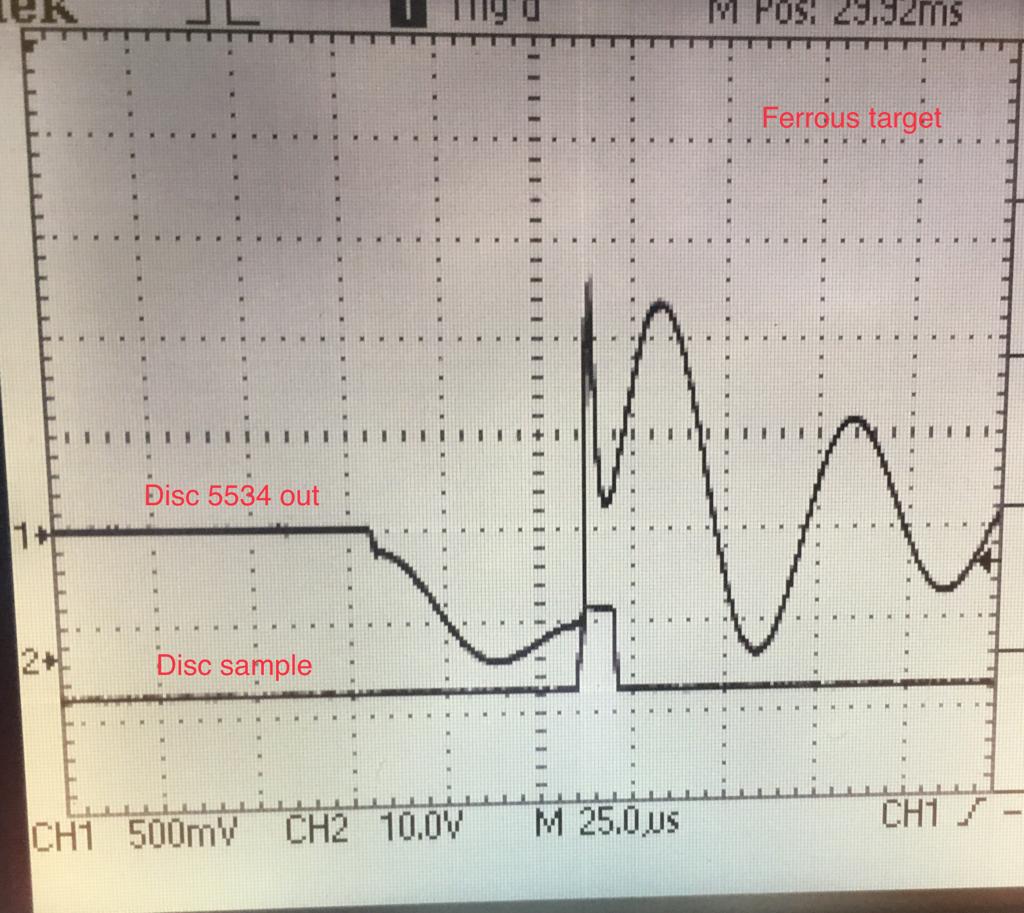

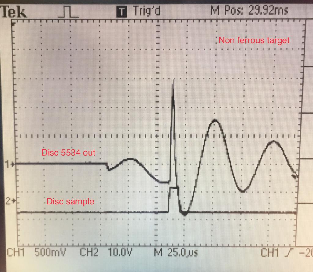

Your DISC sample appears to be in the wrong place. It should be sampling on the ringing part of the waveform after the flyback.Originally posted by ionut_mtb View PostCame up with these waveforms from Mr DFB setup, now i'm waiting for the uA meter.
Not sure if i need dumping for the Rx or if the sample is in the correct position. Thing is that the sample delay is at max on the right side (100k delay pot max resistance, i tried put 20k series but nothing change)

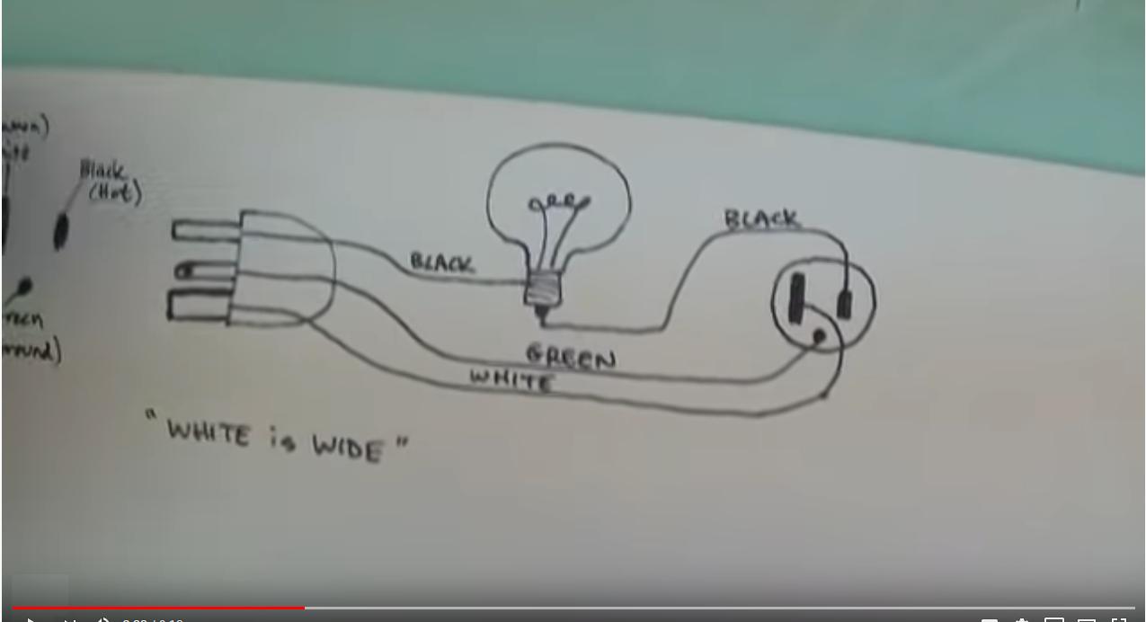

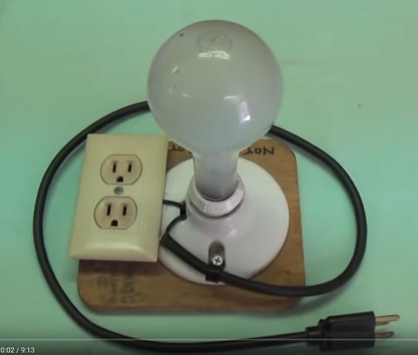

Originally posted by SilverSurfer17 View PostOk i will hunt down a 40 watt bulb. Ill order the bms also and the converter.
this is how to build a house supply current limiter, for just a few dollars,the plug on the right side of picture is just a standard 2 socket you use in a wall. the light buld could be 20 watt night light, and the light socket is the clay one that gets used in closets, 20 watt still be to much in a MD circuit
