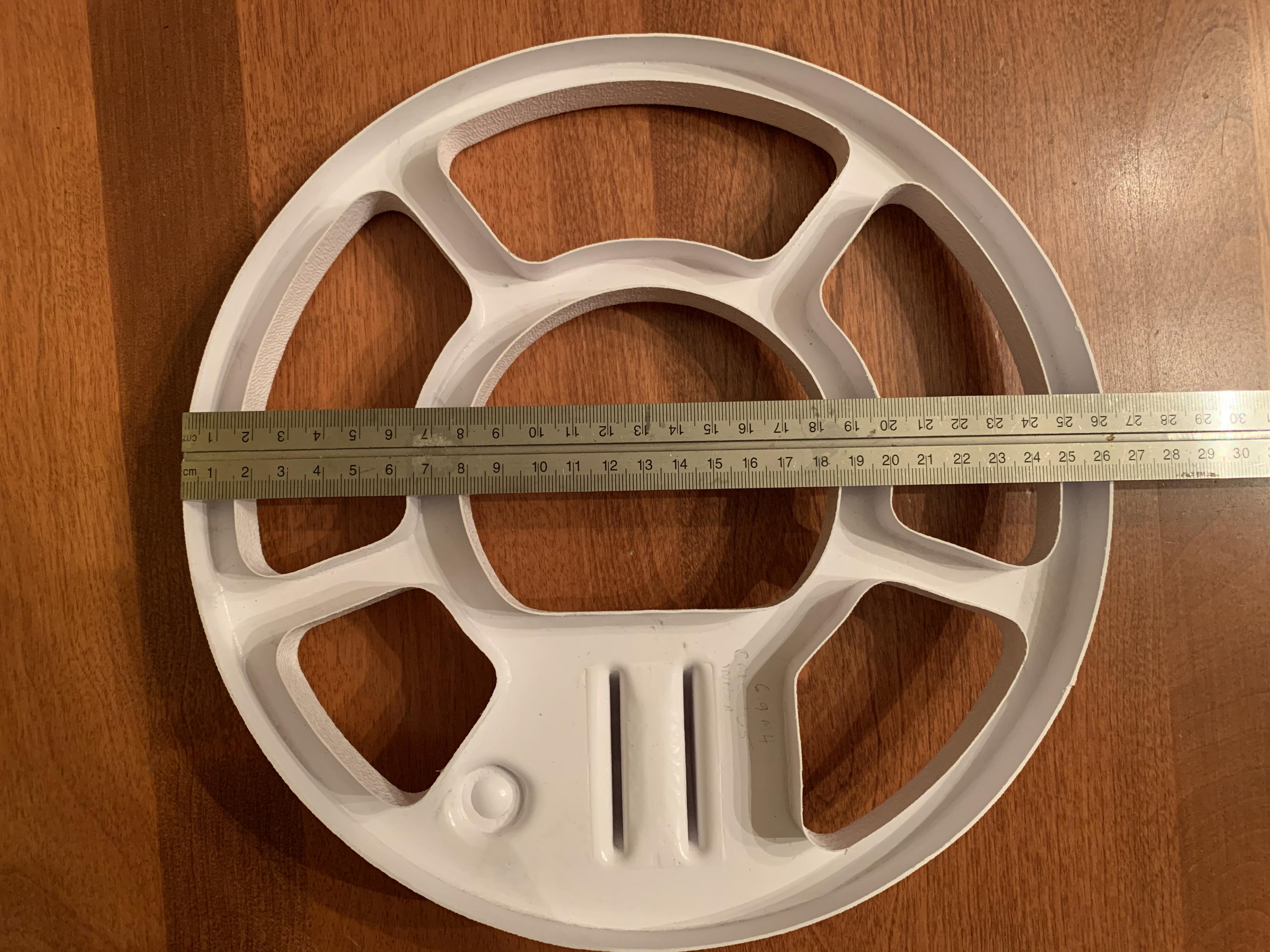

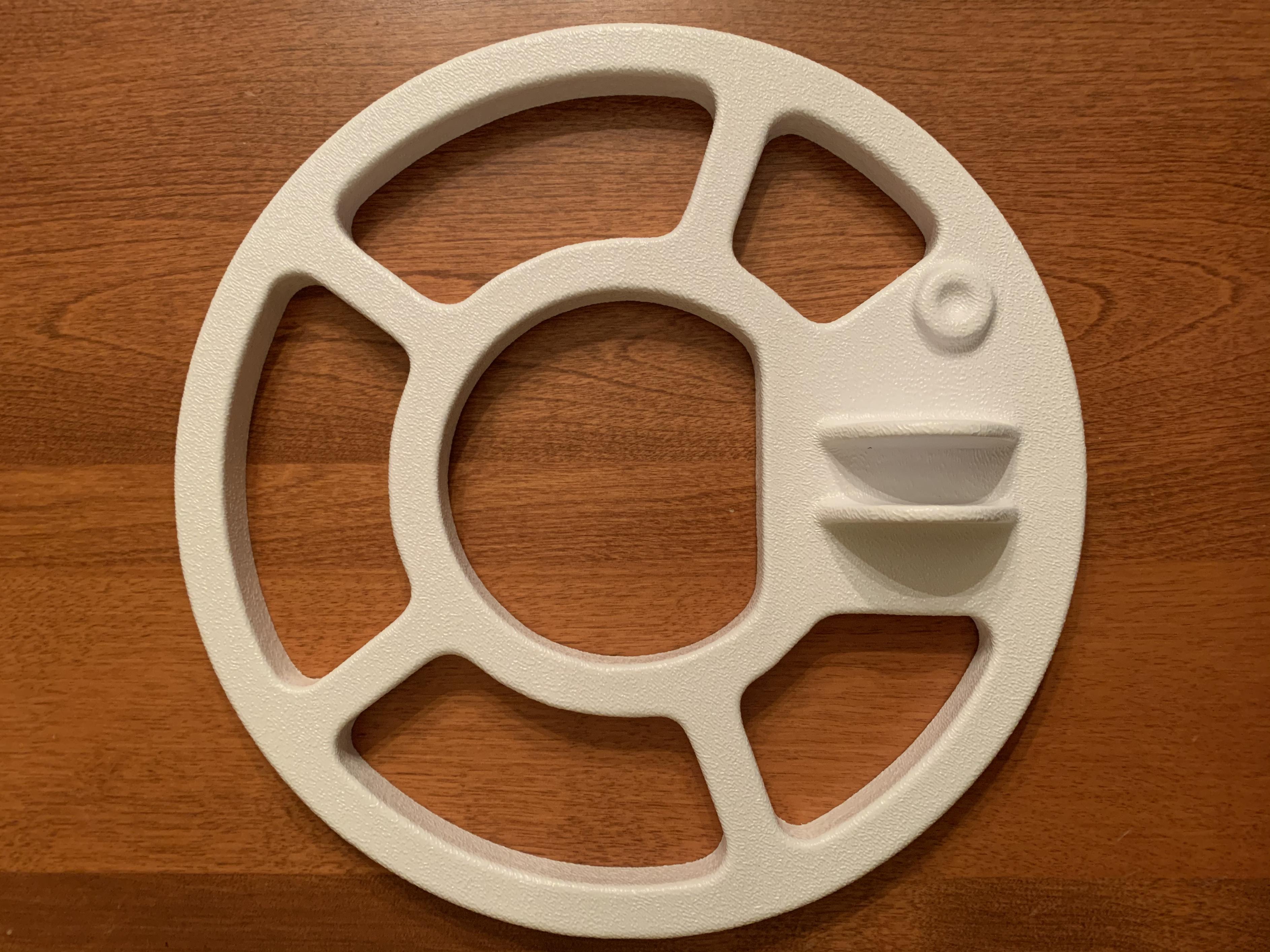

I can send 10 inch shells to anyone who might want one. I have not made any covers yet and mine are meant to be epoxy filled as they are only 1/16 ABS. Tabs are 17mm made for Whites lower rods. If there is enough interest I can make an 8 inch Black or white.
One essential thing I ran into is spool is needed for the RX as it becomes a handful to wind a bucking coil without one. I may be able to provide parts for a spool too..
10 inch makes pinpointing tough.. plus you get to the point of diminishing returns on size vs depth and weight. I Donno about carbon fiber but since its conductive there might be trouble.Originally posted by SilverSurfer17 View PostYeah a 10 inch is to big i stretched it already from 7 because i know 10 is suppose to be a perfect size but for where im gonna be using it thats to big and yes ive seen some spools made out of foam can these Coils be covered with carbon fiber or does the carbon affect the coil ?
Also the open center coil introduces a new challenge in that you have limited area to make a fine tuning loop at the end of the bucking coil. I have been just doubling back through one of the spokes when the coil gets to a null.

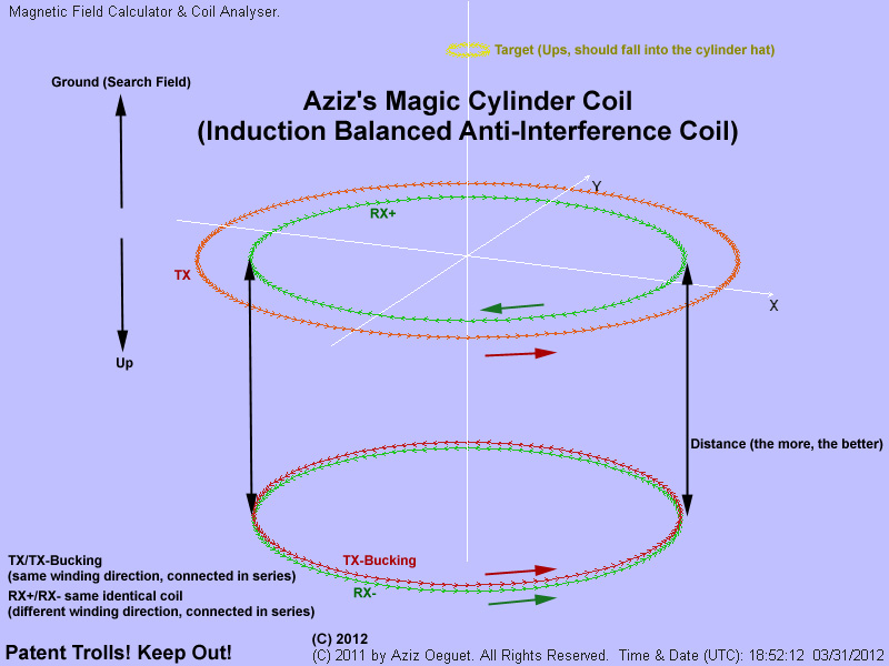

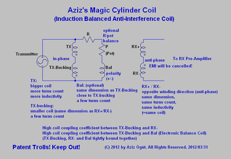

Could you post a photograph of what you are seeing on your scope?Originally posted by lamoiz View PostYes . 3 superimposed coils Rx- / Tx / Rx +. I made one for the test. But not had good functioning. failed to make the Rx "invisible" on the oscilloscope. If anyone here knows this method, I'm very happy if he explains how to do it, or what I've done wrong ... but for voodoo it would be a good idea.

The bucking coil is not a big deal as you only need 5 - 6 turns to cancel out the main coil. Just continue winding the end of the TX wire the opposite direction around the RX coil.
Thing is, you will almost always end up with some fraction of a turn at the end and you need to stop when you hit the null of the coil or it will be no good. I usually double back the other direction against the TX coil when I get the null, or leave a small loop of wire at the end, under the tabs area and move it around and glue it down to do the fine tuning.

Hi lamoiz, thanks reply, would your pancake coil also be known as coaxial coil , some years ago Aziz did some work on coaxial coils he called it his "top hat coil", been looking for his posts about it, but I think he found he had to separate the coil windings by 80-90mm in height.Originally posted by lamoiz View PostYes . 3 superimposed coils Rx- / Tx / Rx +. I made one for the test. But not had good functioning. failed to make the Rx "invisible" on the oscilloscope. If anyone here knows this method, I'm very happy if he explains how to do it, or what I've done wrong ... but for voodoo it would be a good idea.
