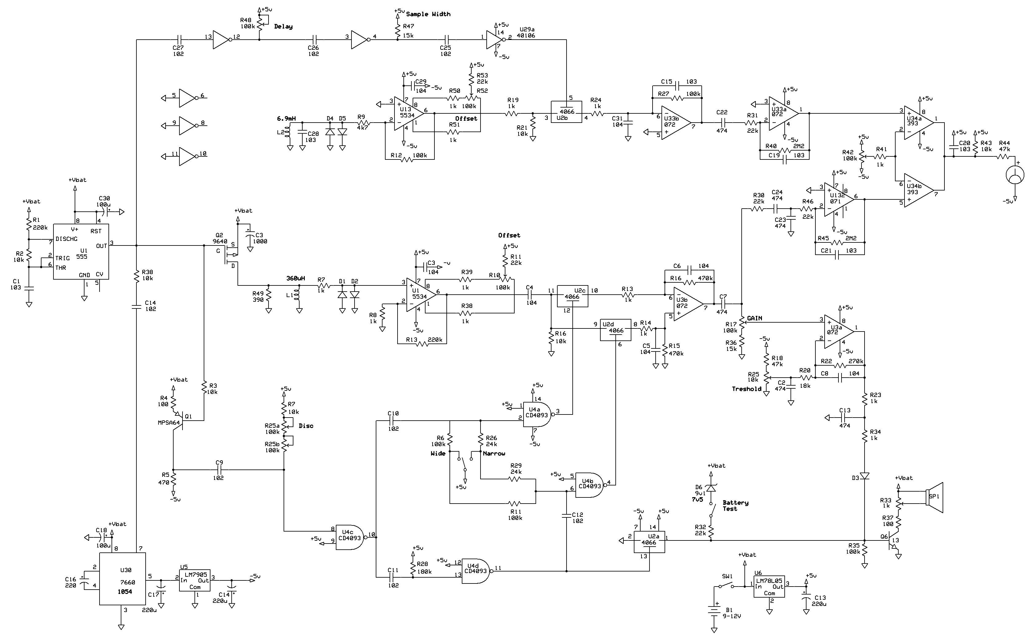

    U2b,R24,C31 = Sample And Hold, SAH.
    Although i am not sure about the value.
    100nF shall do.
    So C31 is "Hold capacitor".

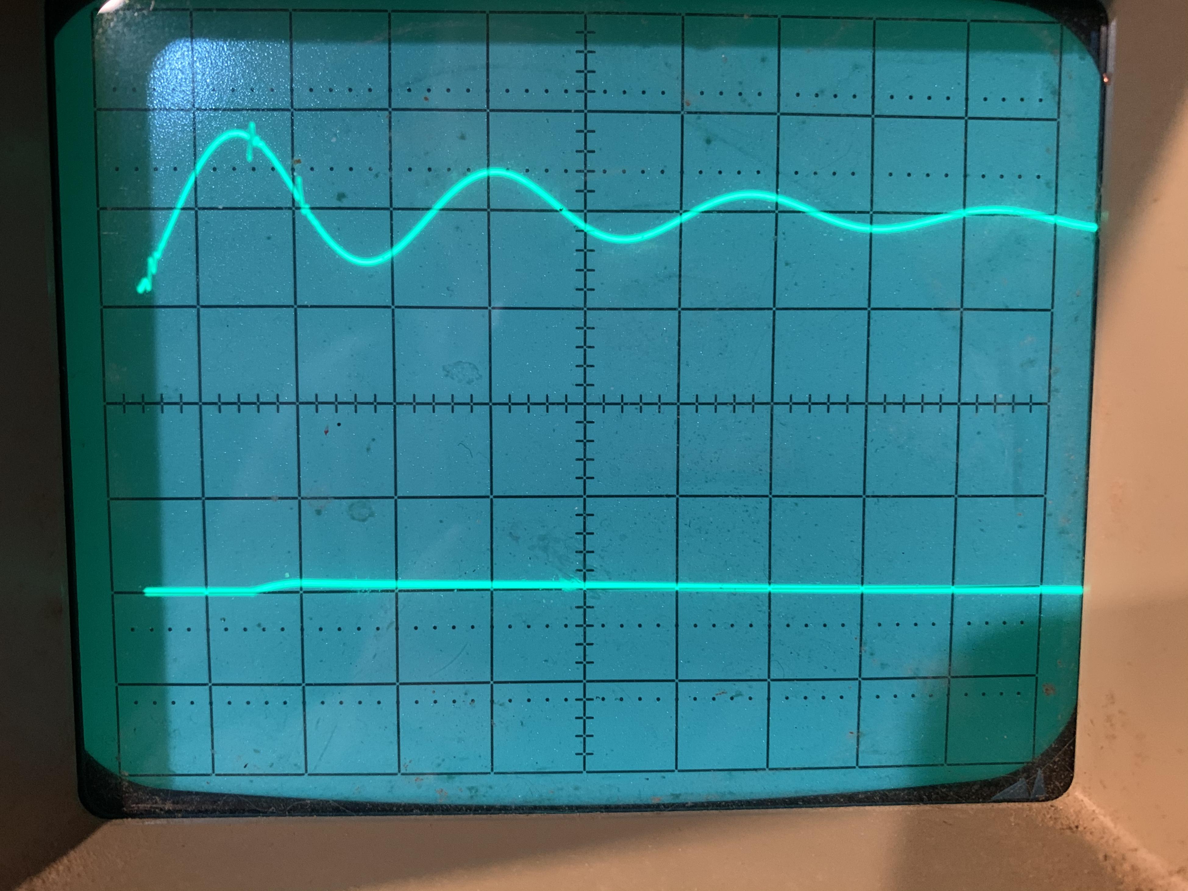

    Here is the sample with and without the 100n cap. Perfect sample for non ferrous detection is on the declining slope of the oscillations. The net signal will decrease in amplitude for non ferrous and phase shift right plus increase for iron... same for the ground signal so it seems best to sample on the declining slope between 90 - 180 degrees.

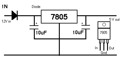

      Could you also include a series idiot diode in power line , needs slightly bigger holes thanks
      Sure,np.

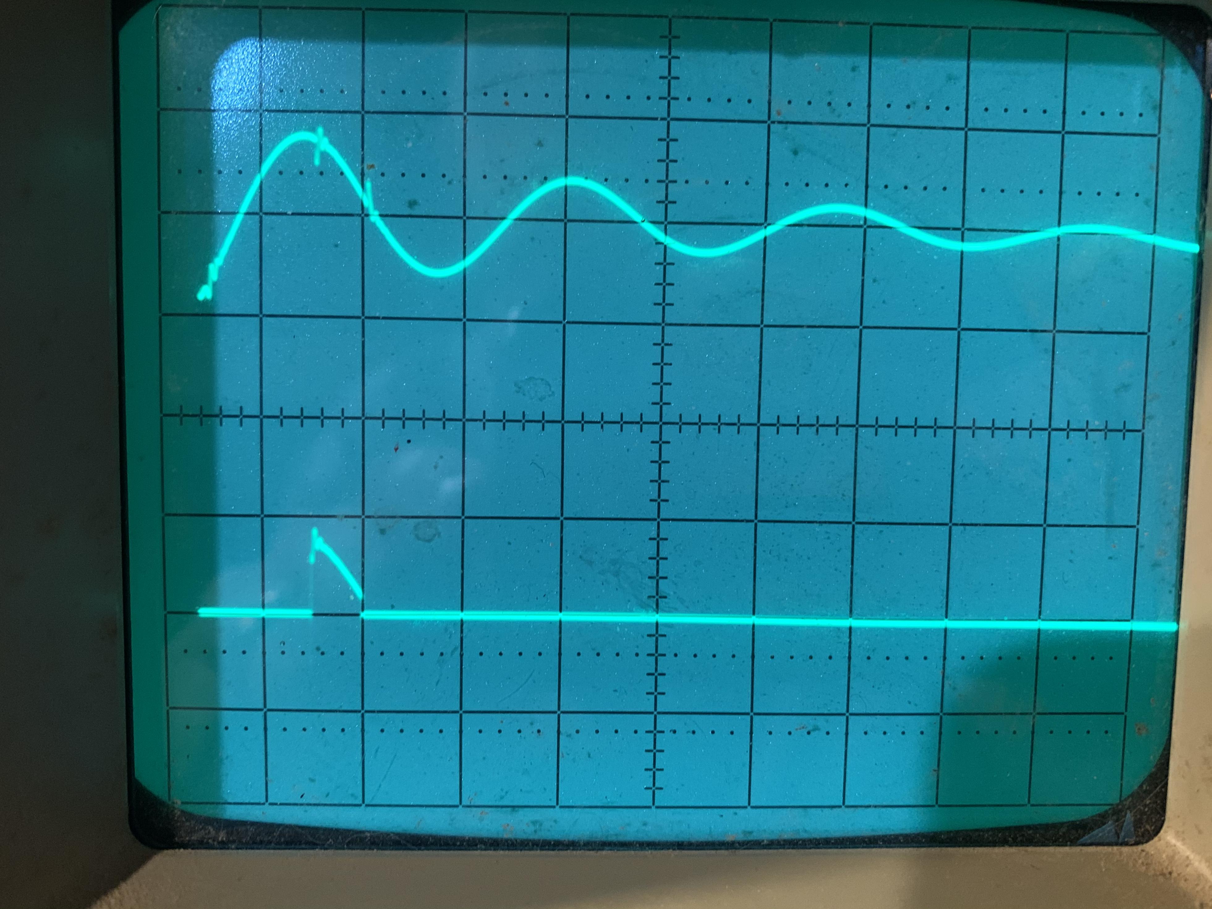

                    The extra capacitor is not necessary in the Surf-PI derived circuit because the sample gates and the opamp integrator together form a "sampling integrator".
                    In the Voodoo circuit the filters are differentiators, so there's a capacitor at the output of the sample gates to create a sample-and-hold circuit. Without the SAH capacitor the signal suffers a large drop in amplitude during the TX period.
                      Which capacitor are you referring to? I've been looking at C31 top of schematic. Doesn't look like a differentiator. https://www.geotech1.com/forums/atta...2&d=1609969536
                      • This need to be checked by "neutral eyes":
                          it's not a differentiator, it's a sampling integrator.
                          The differentiating filters I was referring to are in the Voodoo circuit.
                              Hi Ivconic , good work, I have had a look at the diode I requested but it appears to be drawn in parallel which requires a fuse to be placed in power lead which is ok it will work, but people seem to get it wrong and dont add the fuse
                              but what I was asking for was a series diode something like a 1N5822 40v 3A Schottky, if people dont want it they can short it out, what are your thoughts ?
