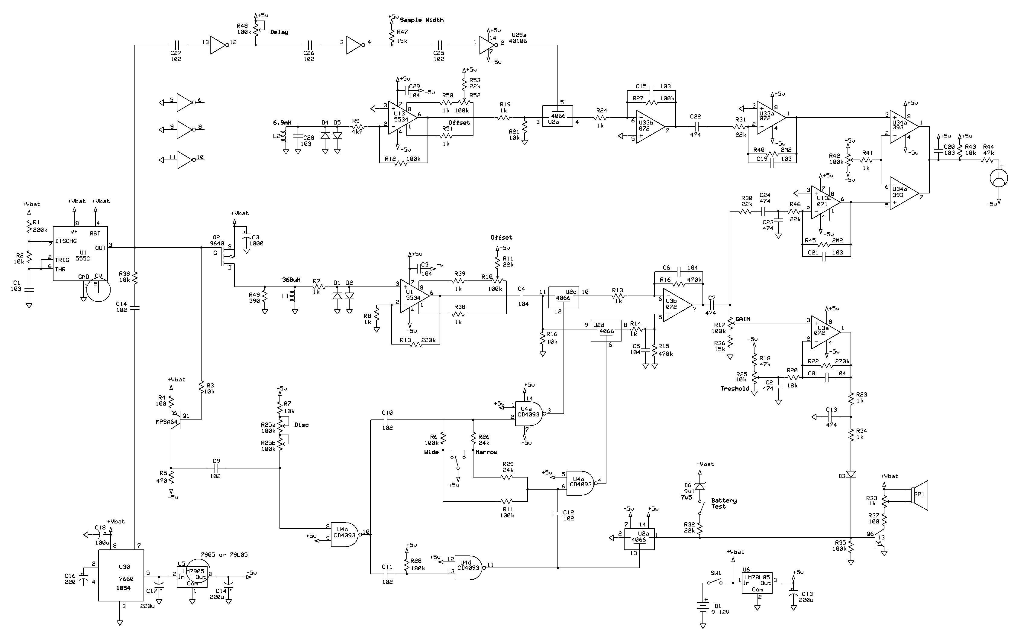

  • I also have 4 questions for Don, i put circles on schematic where i need clarifications.
    Corrected:
    • You can remove the 1k resistor.. just a leftover from a previous drawing. It works without an offset because it get filtered out later on but good idea to add one. The other two, I Donno but will check my original board.
      also, playing around, its best to keep the sample width a little smaller. I changed R47 from 22k to 15k.

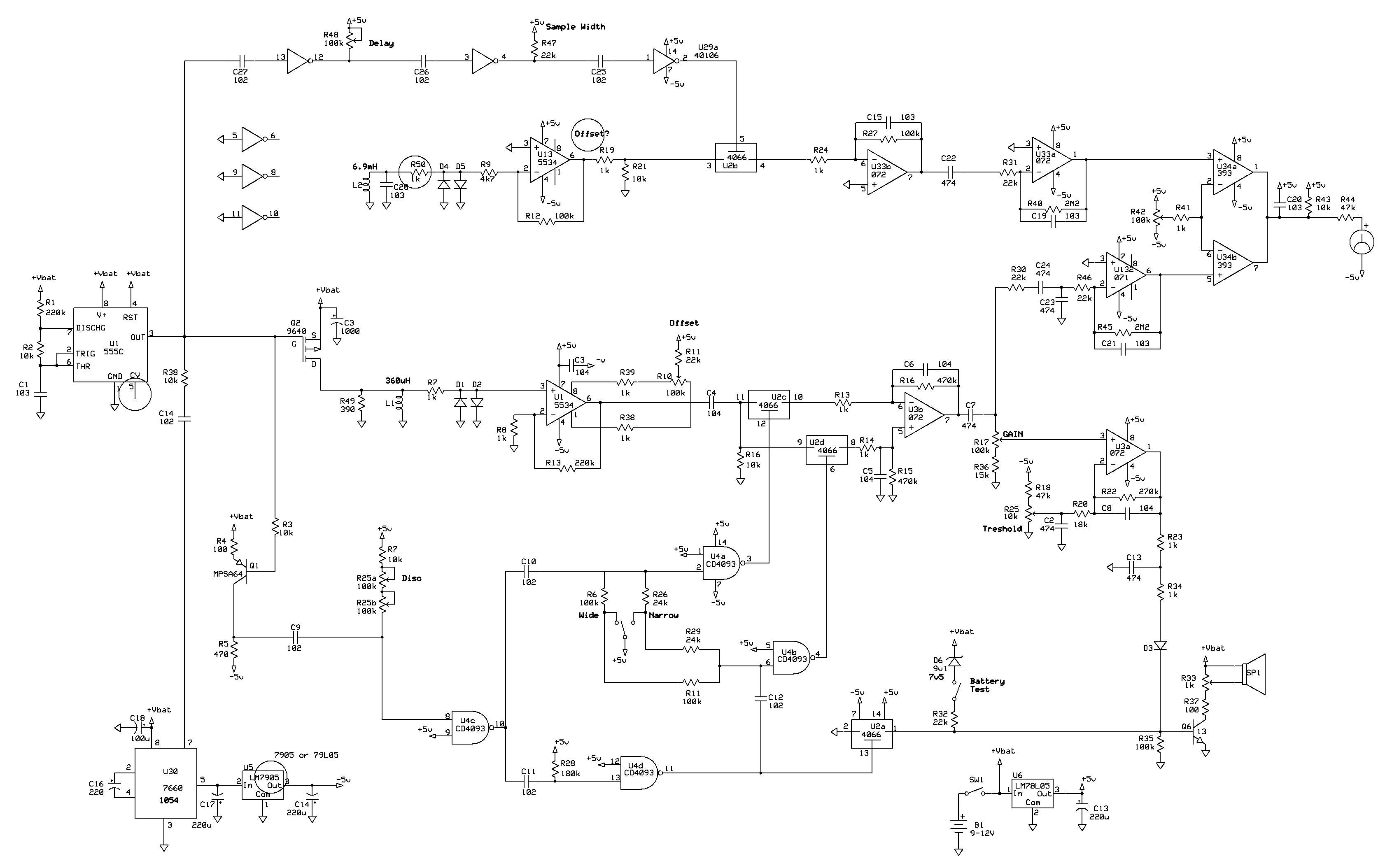

      • Done:
          Could R47 be a Pot instead?
            Done:
            [ATTACH]54139[/ATTACH]
            Great work, for U1, I would use a normal 555 with a 100uF across it.
            • Yes.. that would be a great idea. If nothing else this has been a fun experiment, I will probably try to move everything off my breadboard onto a copper version next and try real world. Also looking forward to assembling the VooDoo!

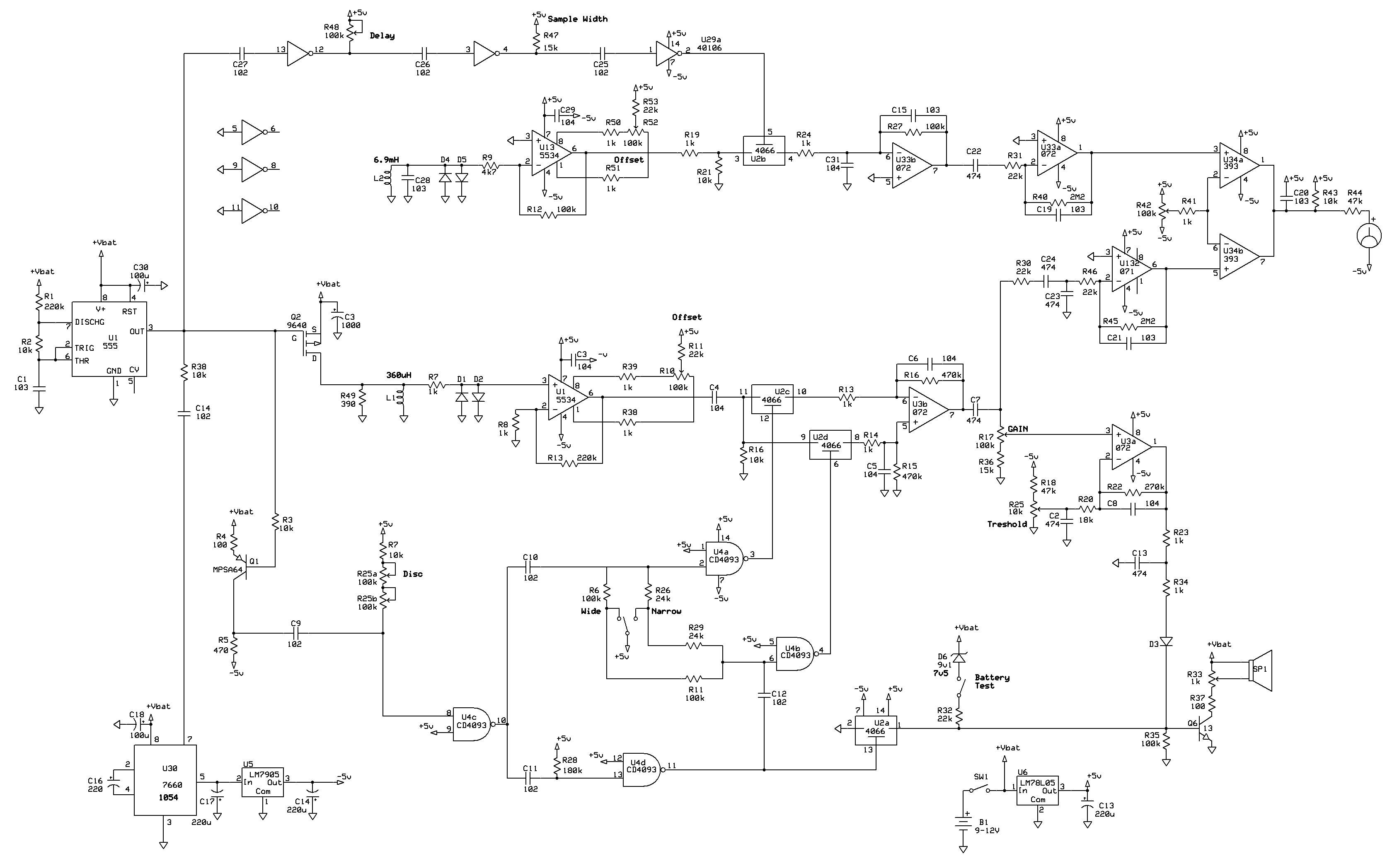

              • Originally posted by Altair View Post
                Don, I would have expected a capacitor after the CD4066B to hold the sampled voltage; it's really missing?
                Hi Don, did you catch this question ?
                  Work fine without one. It?s getting averaged out but ideally should have one.
                    Thanks.
                      Ivconic, I think is better left space for a capacitor on PCB (if you agree)
                        No sweat:
                          No sweat:
                          [ATTACH]54142[/ATTACH]
                          What does C31 do?
                            What does C31 do?
                            I put 100nF, it can be higher value.
                              What does C31 do?
                              U2b,R24,C31 = Sample And Hold, SAH.
                              Although i am not sure about the value.
                              100nF shall do.
                              So C31 is "Hold capacitor".
