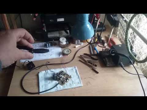

          • Easy guys, George has provided us a new experimental project, it will take some time to have a working unit and to experiment to see how it performs, I hope to finish mine in January, but then I have to make a coil for it, so vlf coils are new for me as I am a pi guy so I am finding it interesting making something new, have a good Xmas.
              I have just finished populating the board tonight and hope to start testing next week. I also have another detector project ready for testing and hope that the two machines will complement each other in my search activities. My coil materials are due to arrive in the New Year so maybe I will something fully working by the end of January. I have learned a lot from this project and the positive contributions posted by you guys. Keep up the good work.
                At least air tests... it is a good project, but clearly not tested, like a spice simulation, nothing else. Sorry, this is my opinion.
                You are incorrect in your assumptions.
                Voodoo has been built and tested outside in the real world, and it really works. The purpose of the project is to demonstrate true ferrous / non-ferrous discrimination. There is always room for further development, in which (as you can see) others are willing to participate. Before you can have an opinion (and not an assumption) you must read the book, and possibly then construct the project yourself. You may then have better thoughts on how to make improvements.

                  there is a guy here who has videos of his building this, and has helped others, and is working on a coil and finishing to use at his beach, when it is completed im sure he will make a video, surf detector is his name and i am subscribed to his youtube channel, and watch his vids, which are great to us.

                      • I am sure it can be done easy on the same board, with just few small corrections.
                        RA4 should provide PWM (if possible, if not; cut existing track, disengage RA4, use another PWM pin and piece of wire... simply will do).
                        PWM to connect to NE555 and "bias" its threshold.
                        RA4 can even stay there and still switch the audio.
                        Few different solutions on the same board, without much of a changes.
                        Without me reading the PIC datasheet, a question: are there any free PWM pins?
