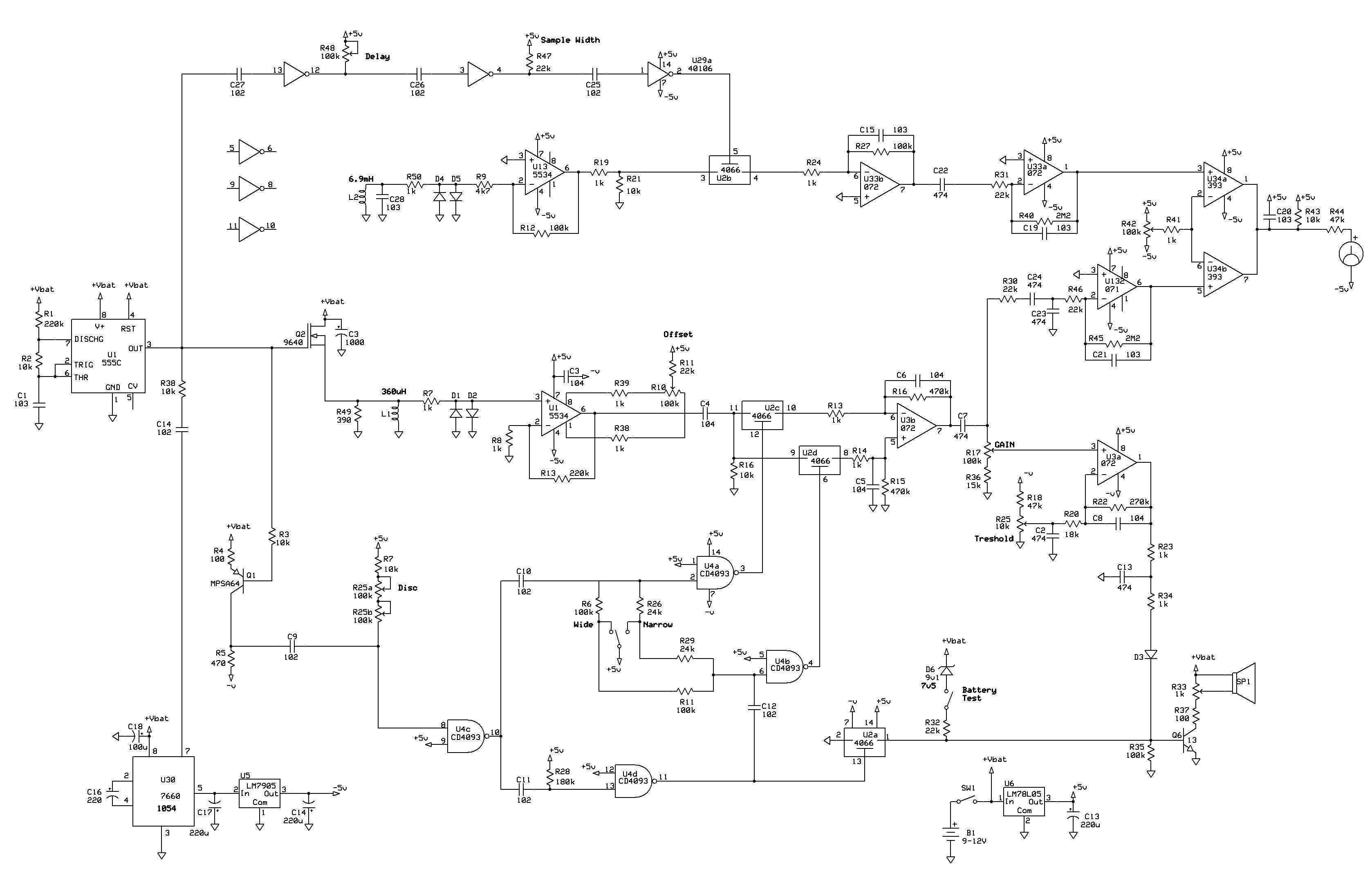

          Here is what I have been playing around with. I can disc iron or non ferrous depending on where the sample it taken. The ground signal seems to have no overall effect. Since that original PI audio is left uncorrupted.. no double beep. All that is needed is to look at meter deflection. I can disc through two layers of brick and which is probably a stronger ground signal than my actual ground. It?s still on a breadboard but I can move my coil off the bench to a bed of bricks to test. If nothing else it had been a fun experiment!
          Don, I would have expected a capacitor after the CD4066B to hold the sampled voltage; it's really missing?
          • I put all in one schematic for easier insight.
            Don can you please check this and see if i did it right?
            Also i think this deserves own topic, to avoid to mix in here and make confusion.
            I would start new topic but it's your work so is better you to start it, i think.
            If there are no mistakes; i can start drawing pcb.

                [ATTACH]54127[/ATTACH]

                  Ivconic, don't forget to reference unused gates, e.g.: pin 5,9,11 of 40106 to 0V.

                    Wow .. impressive. You are truely a wiz at that! I will check it over carefully when I get off work later today.
                    a few notes.. the reference pot around the LM939s can be improved. A few microvolts over ground is all that is needed. Pots can be noisy and I have had better success with a pair ok slightly mismatched resistors.
                    It doesn’t need to be that PI circuit. It’s just what I had laying around that worked.
                    There are two sweet spots on the delay pot. One will reject ferrous, the other non ferrous. I’m king of liking the ferrous rejection setting.
                    RX coil frequency can be played with quite a bit. As long as you can do less than 90 degree sample and cover the first 180 degrees of the first oscillation everything should work. I have not paid any attention the the load on the regulators.. I need to make some measurements to see that there is enough headspace but I have not seen a problem yet.

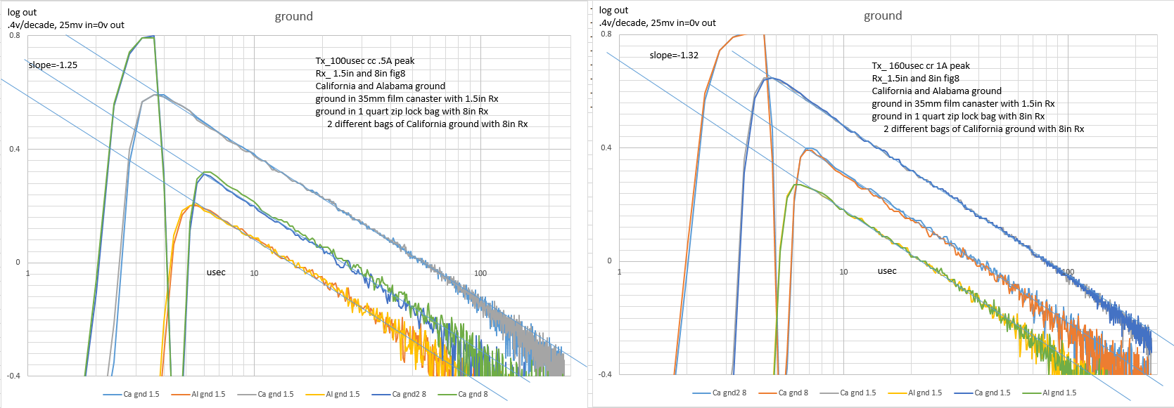

                      In a VLF design the problem with heavily mineralised non-homogeneous ground arises in the GB channel, because the selected GB sample point cannot handle the varying ground conditions. The same applies to the GB sample method used in PI detectors, because the target hole created by the GB sample also cannot handle the varying ground conditions. On the other hand, if the ground mineralization is homogeneous then either method would work.
                      Think I've read somewhere that ground X signal varies and ground R signal doesn't. I have some hot ground from California that GB(R signal)with subtraction at the same settings as ground from my yard. Tried looking at X signal when Tx on with IB coil. Requires different sample settings to GB. Recording I made awhile back shows ground decay slope changes with different Tx profiles but the two different ground R signals act the same. Anyone know where to look for some test information that shows ground R signal not the same with different grounds?
                      Chart Tx,(cc)constant current,(cr)constant rate

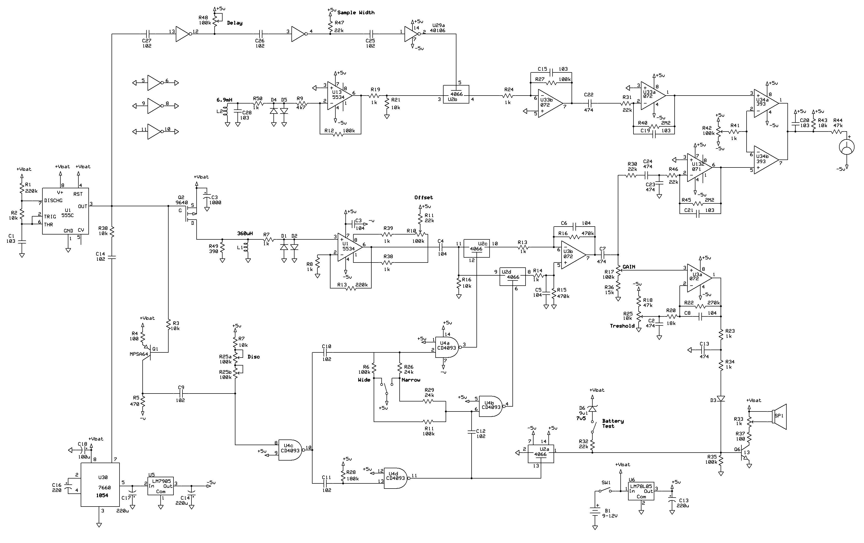

                        • Ivconic,
                          the IRF9640 is a P channel, not N as in yours schematic and his S and D pins must be swapped.
                          Moreover, sometime you name -v the -5V.
                          • I corrected those.

                                [ATTACH]54131[/ATTACH]
                                .... out pins 6,8,10 of 40106 must be left open!
