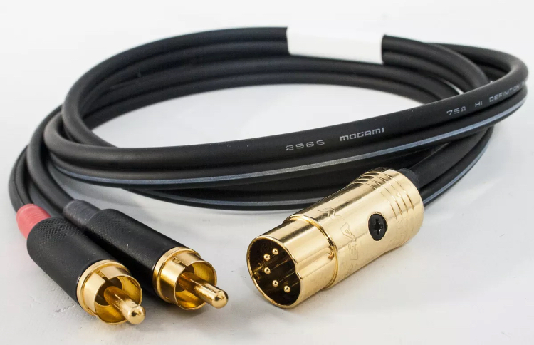

Twin individually screened coax, but there are no markings on the cable to help identify it.Originally posted by SilverSurfer17 View PostI saw the post on the three different types of cable to use ill have to order mine soon i was wondering anyone know what Minelab uses thanks or can narrow it down to whats best to use
