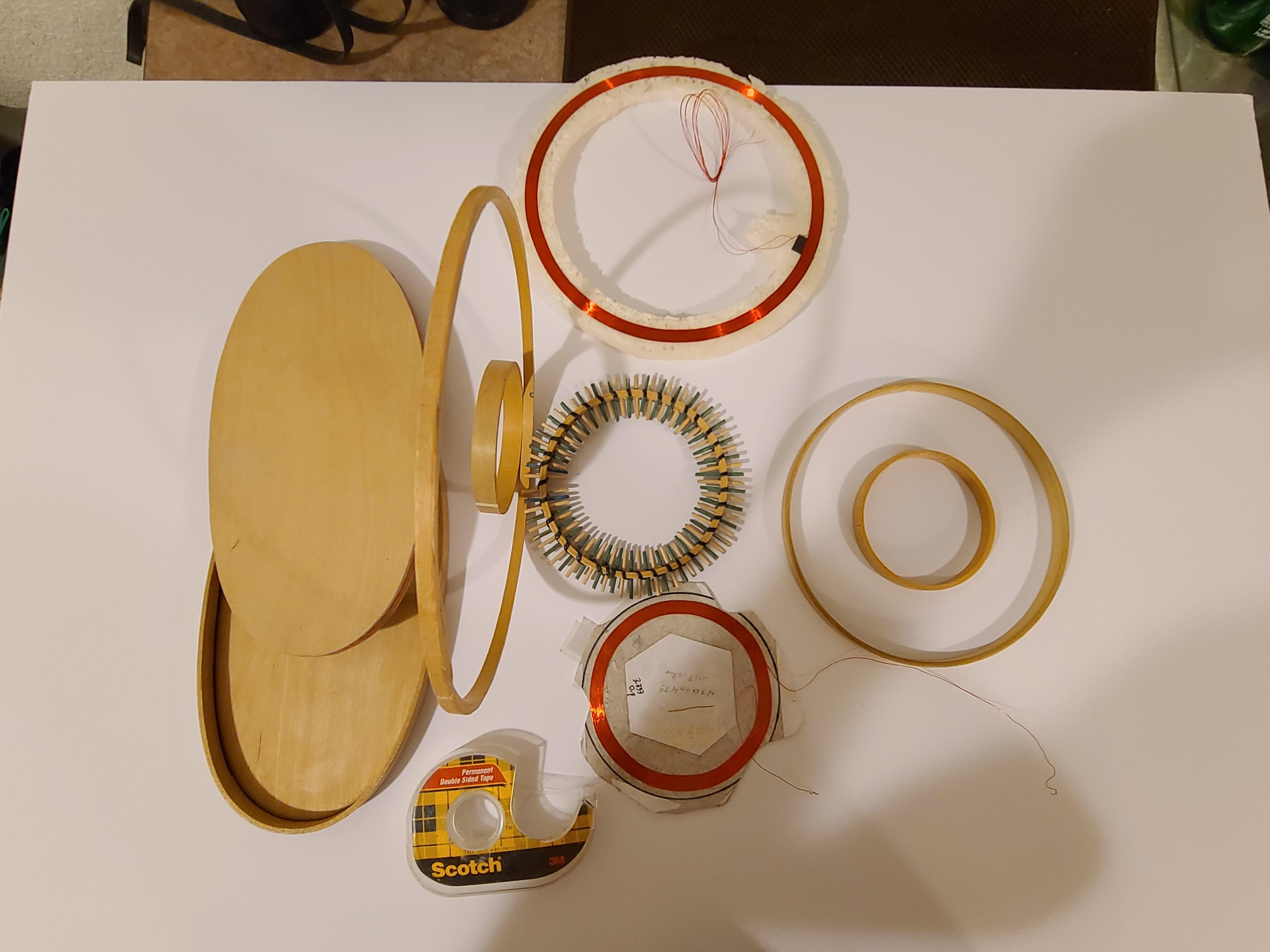

                  First the forms,
                  I used embroidery hoops to make the bobbins they come in round and oval.
                  I used a 4 inch and a 8 inch and super glued 1/8 inch foam board to each side to make the bobbin's. Most are about a half inch thick.
                  you can also use them for coil shells if you wanted.
                  In this pic are a couple different ones the one standing up is cut in half to show you could use them for a thinner bobbin if you wanted.

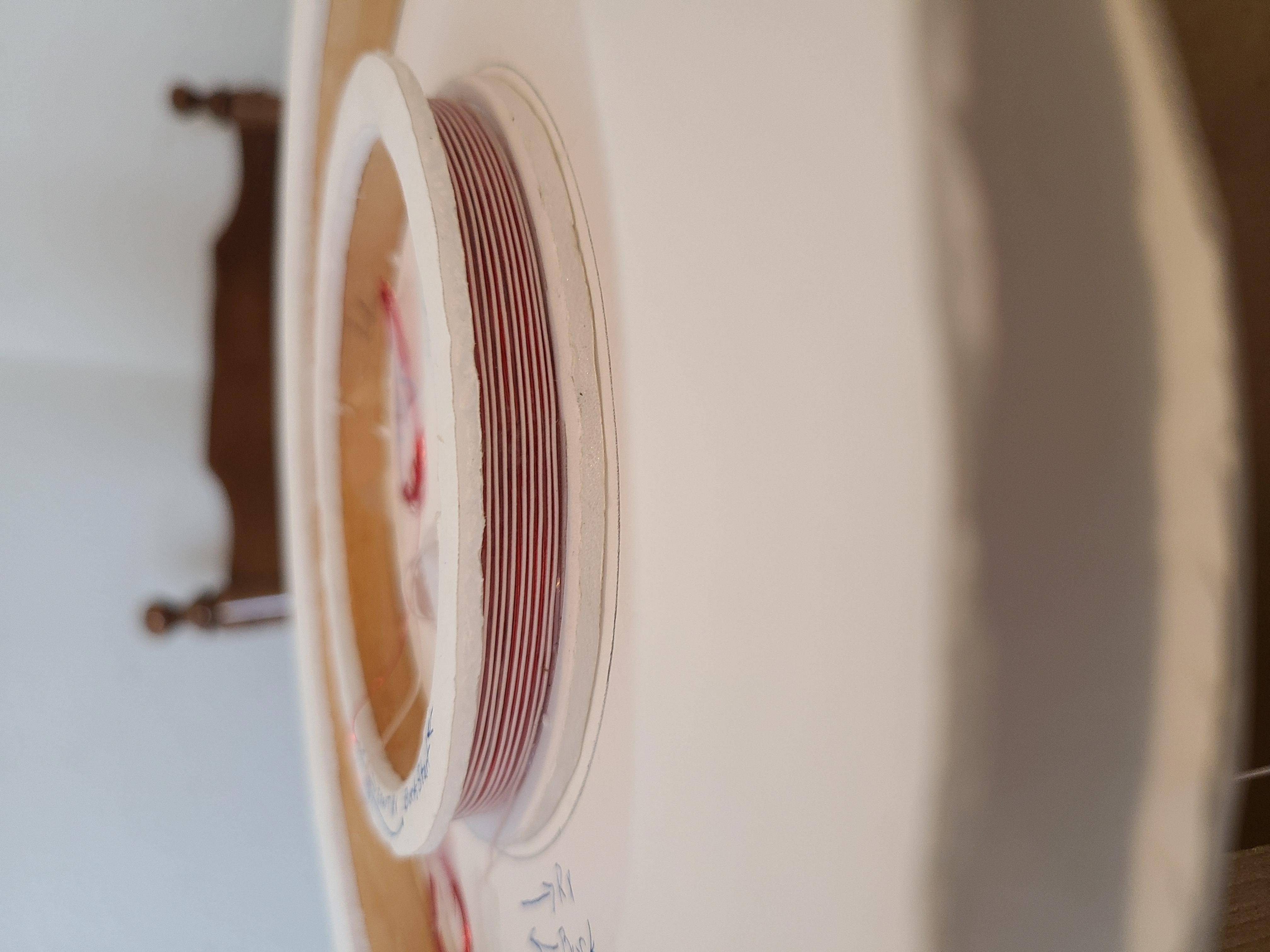

                  The Rx coil is built first, always add extra wraps so you can adjust it to your desired inductance by removing wraps at the end.
                  I had intended to make the rx coil a verticle and started out that way but ended up just doing a spaced bundle kinda.
                  I wrapped 20 wraps then wrapped that with a layer of tape then 30 , tape 20, tape 30 for a total of 90 wraps.
                  I removed 10 to tune it to 2nH so 80 wraps 30 awg magnet wire.
                  Then you want to wrap the coil in one last layer of tape this time it needs to be double sided to hold the bucking coil in place.
                  The Scotch in the pictures is the only one I've had good luck with.
                  Next is the bucking coil,
                  I wrapped it from the top to bottom with 9 wraps it was figured for 7
                  I eyeballed the wire spacing and the double sided tape holds it in place so you do not need a spacer. Its a test coil a final production would be done a bit better.

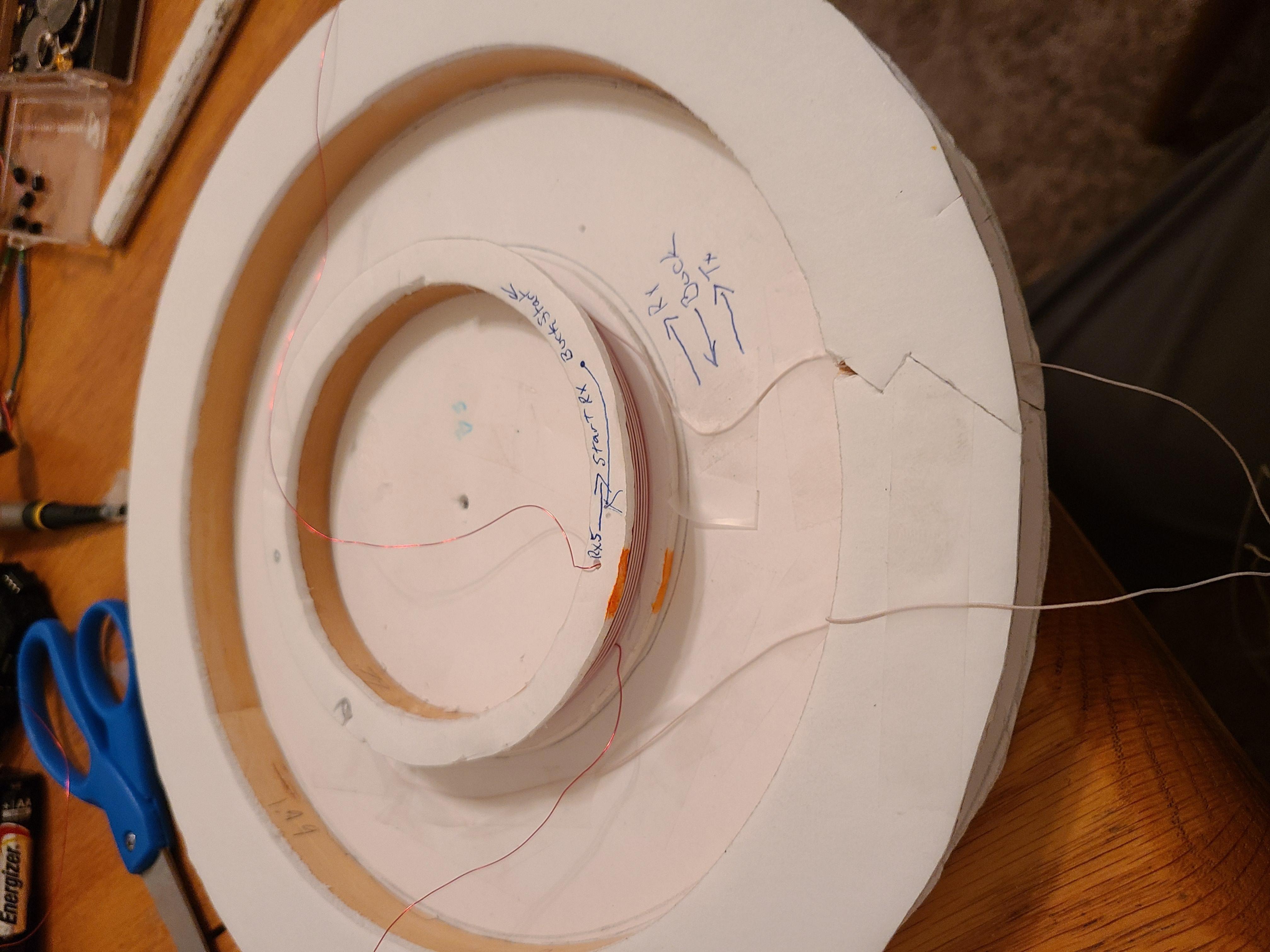

                  Then Attached the rx and bucking coil to the Tx form.
                  I used double sided tape so I could adjust it if I wanted.
                  Cut a slot through the foam board on the Tx where you want it and cut a grove in the bobbin to inset the Tx wire.

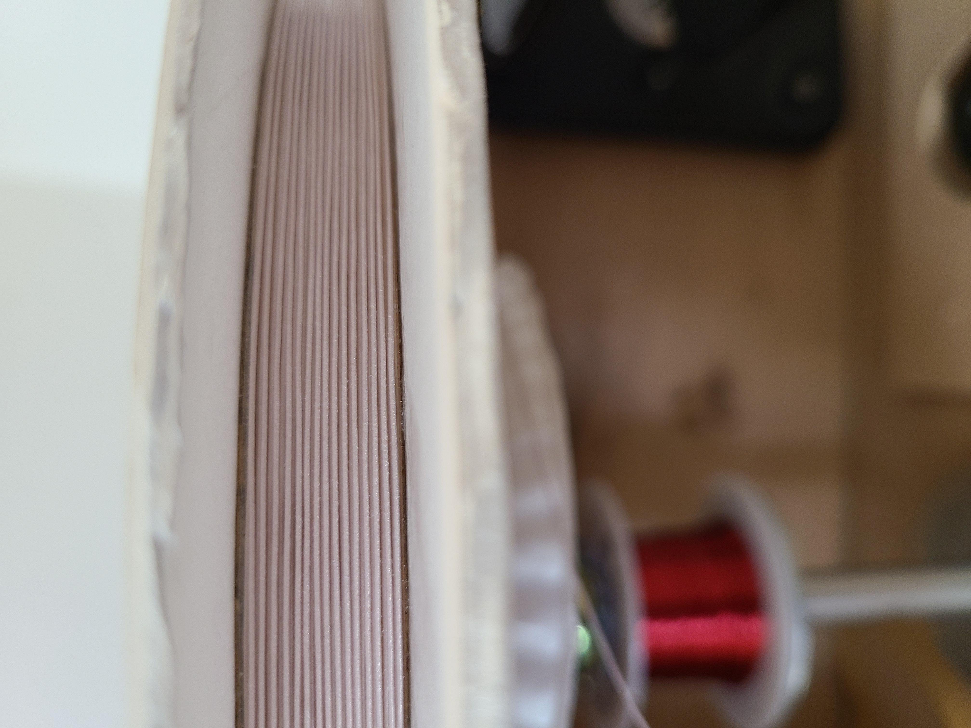

                  Now wrap the base of the Tx spool with double sided tape and you can start the first layer.
                  I went 15 wraps keeping a space between the wires then another layer of double sided tape and 15 more wraps and a third layer of tape and 10 wraps.
                  for 40 wraps . I way over did it.
                  At 40 wraps though for info it was exactly 1nH inductance. I removed 13 wraps for a inductance of 385uh.
                  TX stack

                  Here is a top view if the coil you can see where I cut the slot to start the tx wind.
                  Now to null the coil you just remove a couple wraps and get it close as you can but do the final null in the shell so its attached to the cable and everything can be locked down.
                  Keep in mind this coil has never been tested I need to build a regular bundle with the same spec to compare to just to have a base line.
