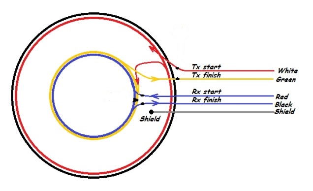

[ATTACH]53681[/ATTACH]
this is the first one Ive built, in the picture everything is over wrapped a few turns.
Final #s are 30 awg 40/46 wire 27 turns 4" I.D
Tx 385uh Rx 2.04nH. 30 awg magnet wire. 8" I.D
Bucking coil ended up 6and about 34 turns with a final null at 0 to 800uV.
One down .
Hi GD, is this basicly how you wound it ?Attached Files

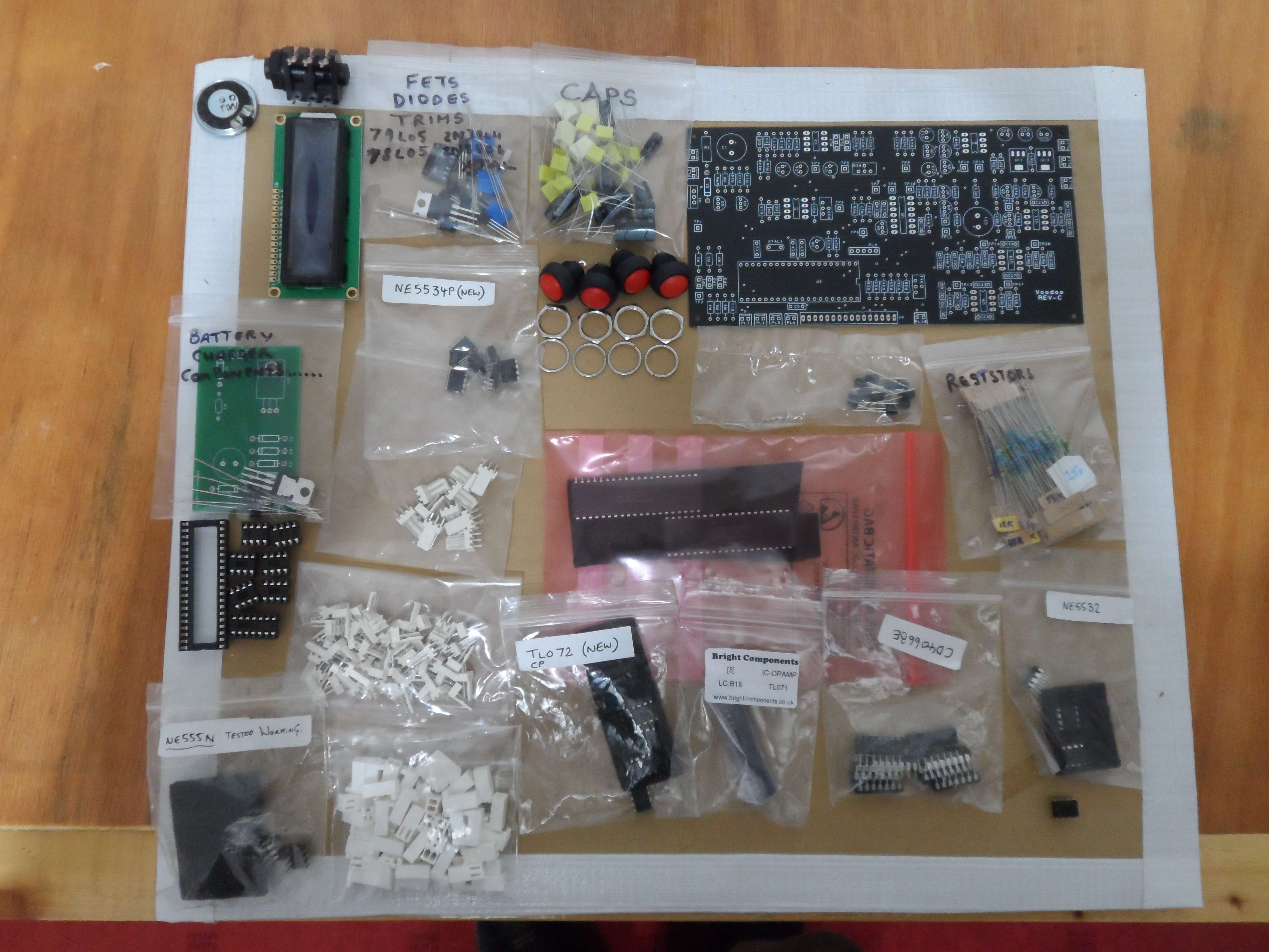

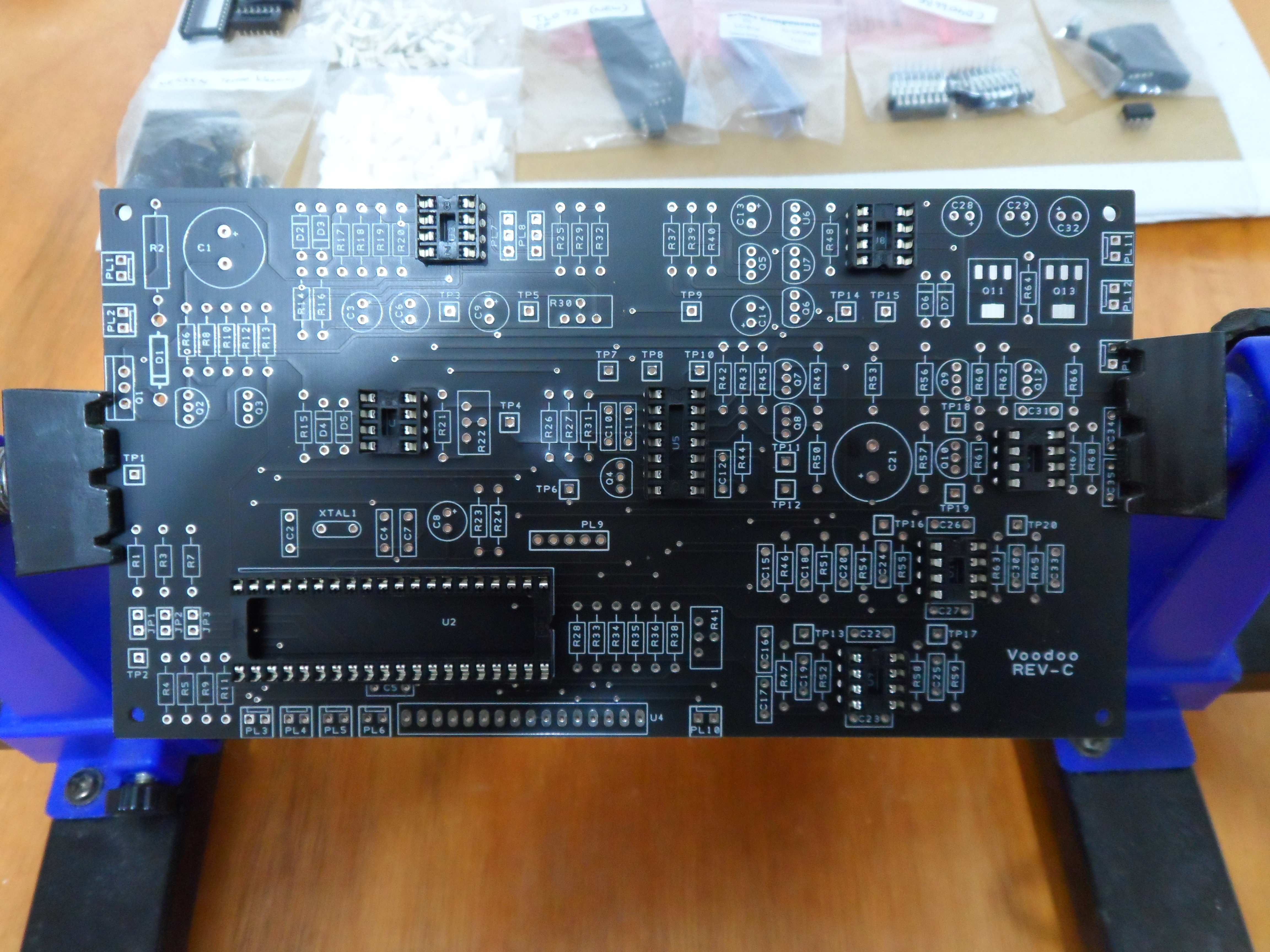

Hiya Lamoiz, I won't be starting just yet. I only recieved my 79L05's and PIC IC Sockets today. I'm planning to build in stages and take my time as I want to make a record of my build so I will be taking my first photos and notes tonight. Tomorrow I will make a start by installing the IC Sockets first then building the Power supply. Are you building yours in steps? I wouldn't just install your components as they arrive or you may run into problems. As George said, You should build the Power supply first, then the Transmitter circuit then the LCD circuit so you are able to check your voltages before you move on. I hope you have a successful build Lamoiz. Regards, Marty.
no I have all the components, and I'm going to do everything at once .. this evening I soldered all the resistors .. tomorrow after ...Originally posted by MartyJ1963 View PostHiya Lamoiz, I won't be starting just yet. I only recieved my 79L05's and PIC IC Sockets today. I'm planning to build in stages and take my time as I want to make a record of my build so I will be taking my first photos and notes tonight. Tomorrow I will make a start by installing the IC Sockets first then building the Power supply. Are you building yours in steps? I wouldn't just install your components as they arrive or you may run into problems. As George said, You should build the Power supply first, then the Transmitter circuit then the LCD circuit so you are able to check your voltages before you move on. I hope you have a successful build Lamoiz. Regards, Marty.
