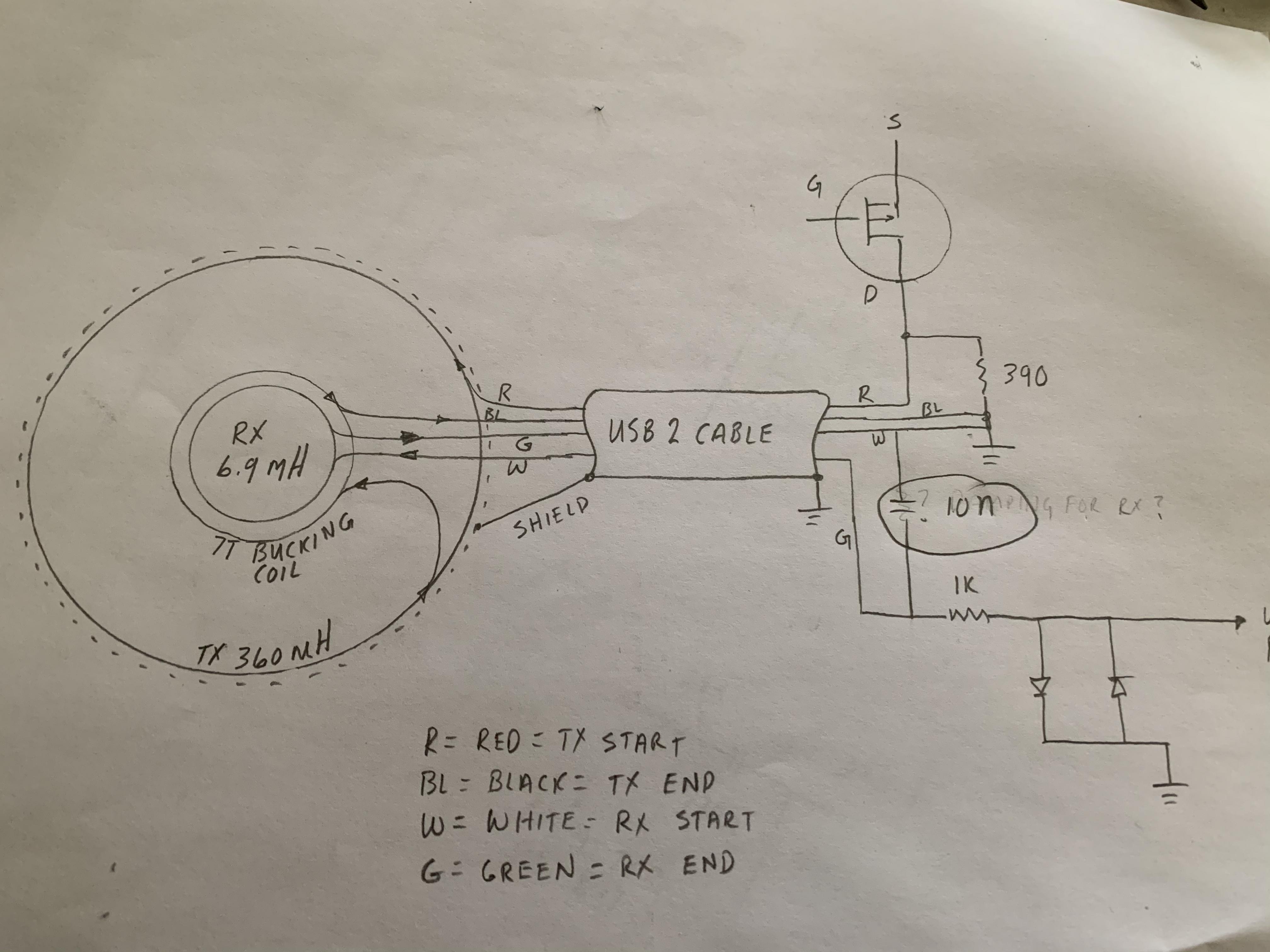

          Here is what I have been playing around with. I can disc iron or non ferrous depending on where the sample it taken. The ground signal seems to have no overall effect. Since that original PI audio is left uncorrupted.. no double beep. All that is needed is to look at meter deflection. I can disc through two layers of brick and which is probably a stronger ground signal than my actual ground. It?s still on a breadboard but I can move my coil off the bench to a bed of bricks to test. If nothing else it had been a fun experiment!
          Found my first mistake.. add a 10n cap across the coil.
                    If I understand your schematic (and correct me if I'm wrong) the audio is only driven from the PI channel, but the signal prior to the SAT circuit is sent to a differentiator located on an add-on board. The DISC channel is also single-differentiated, and the output is wire-ORed so that the meter only responds to non-ferrous targets. This is analogous to the signals in pane 2 of Table 7-4 on page 81. If the lower connection on the meter was connected to 0V, I presume it would swing right for non-ferrous, and left for ferrous? The only problem would be non-ferrous targets would first swing to the right followed by a swing to the left. Ferrous targets would do the reverse. So I suppose that's why you've connected the meter to -5V?
                    This means that the detector will beep for all targets, and reliance is on the meter to indicate the target type. Have you tried using the meter signal to disable the audio for ferrous targets?
                    I have experimented with a single-differentiating topology on a previous version, but separation of targets was poor. In my test garden (which is littered with ferrous trash) it was impossible to identify the location of the buried coins.
                    I would be interested in what you discover when you take the detector outside.
                    Good work by the way.
                      Scheme I can't put because it will be a commercial detector the project was given a well-known companies ... But I can send it to you a snapshot of how the detector works!
                      Yes please. That would be interesting.
                        Thinking about that some more ... I've probably got that wrong. With the meter connected to 0V the non-ferrous would swing right and then left, but the ferrous targets should do nothing. This is (of course) assuming the meter was adjusted so that the needle is in the middle.

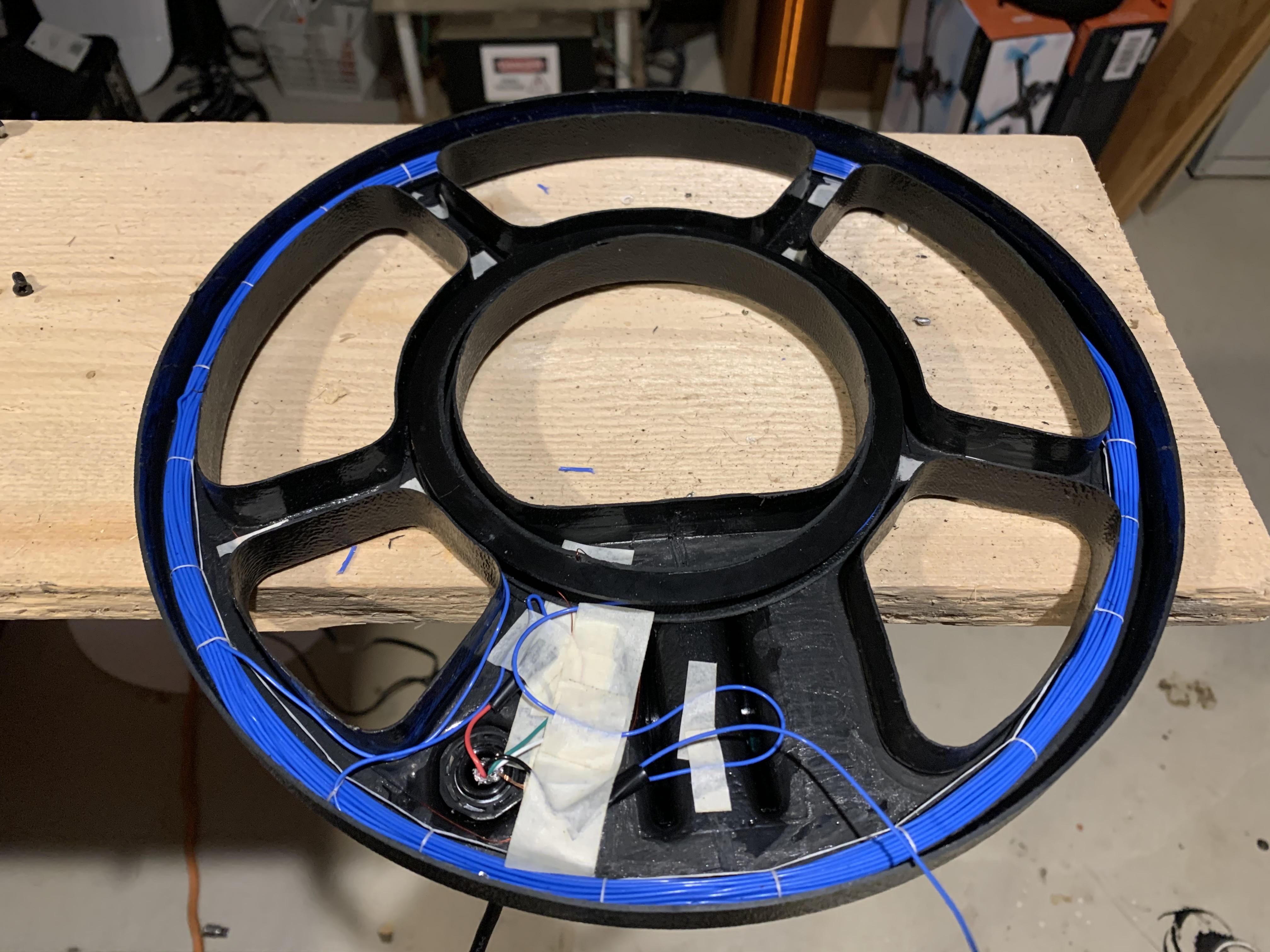

                              Great work Don, with your conc coils how much tail do you leave between the TX end and bucking coil, so you can make a nulling loop ?
                                Yes, exactly. I used the area under the clevis tabs to make the fine tuning loop. Then several pours of potting compound until I got it close. It was a whole new challenge working around the open center coil! It's much easier with a solid center.
