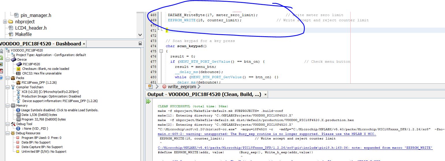

                    LCD code is done, ADC has been coded, port pins all ok, EEProm needs to be coded as the routine has been dropped from MC library for a lot of devices.
                    Its ok with PIC16F not 18F.
                    It is now replaced by the DATAEE library and MCC does not support a lot of the earlier devices including, unfortunately, the PIC18F4520.
                    I am currently working on a routine.
                    Good news is that I have also ported most of the Voodoo code to PIC18F45k22
                    Looks like I'm going to build the hardware sooner than I planned so I can test both of the ported codes.
                    Will post the PIC18F4520 version once I write that EEprom routine.

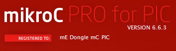

                            • Qiaozhi what version of mikroC PRO for PIC you used?
                              Since you gave source code; i was thinking to analyze it and see if there will be possible to port it to some Atmega too.
                              I am having this version installed:
                              And it gives me lot of errors while i try to compile the source code.
                              • Originally posted by Mdtoday View Post
                                Maybe a bit too fast...
                                [ATTACH]53908[/ATTACH]
                                Cheers
                                I am interested in PIC18F45k22 version, if finished, tested and correct.
