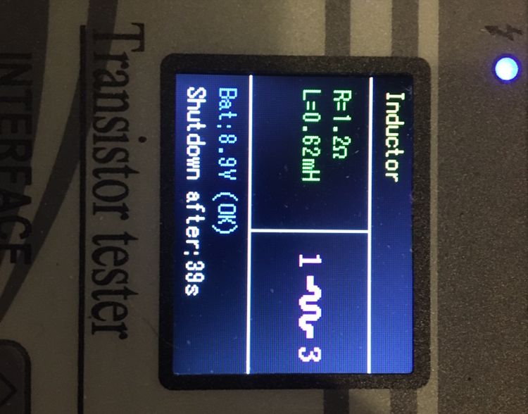

    • George should i make a mono coil of a certain inductance to match the basic settings like to match the tx loop of troy coil this is what ive been messing with its 20 gauge and a 8 inch i dont have a cap installed i have lots of 20 gauge magnet wire

          • I realise the Voodoo is a PROOF OF CONCEPT (not that there was ever any doubt George would find a solution). I am talking about developing the idea further to gain more performance. I'll probably fail, but I'm going to see if it is possible.
            I have a few analogue and digital design trick up my sleeve that I can apply. See where I get to, but FIRST..... I'm going to build a stock Voodoo and see how it performs.
            I'm NOT knocking the design, it's wonderful, but I want to play with it, see what is possible.
