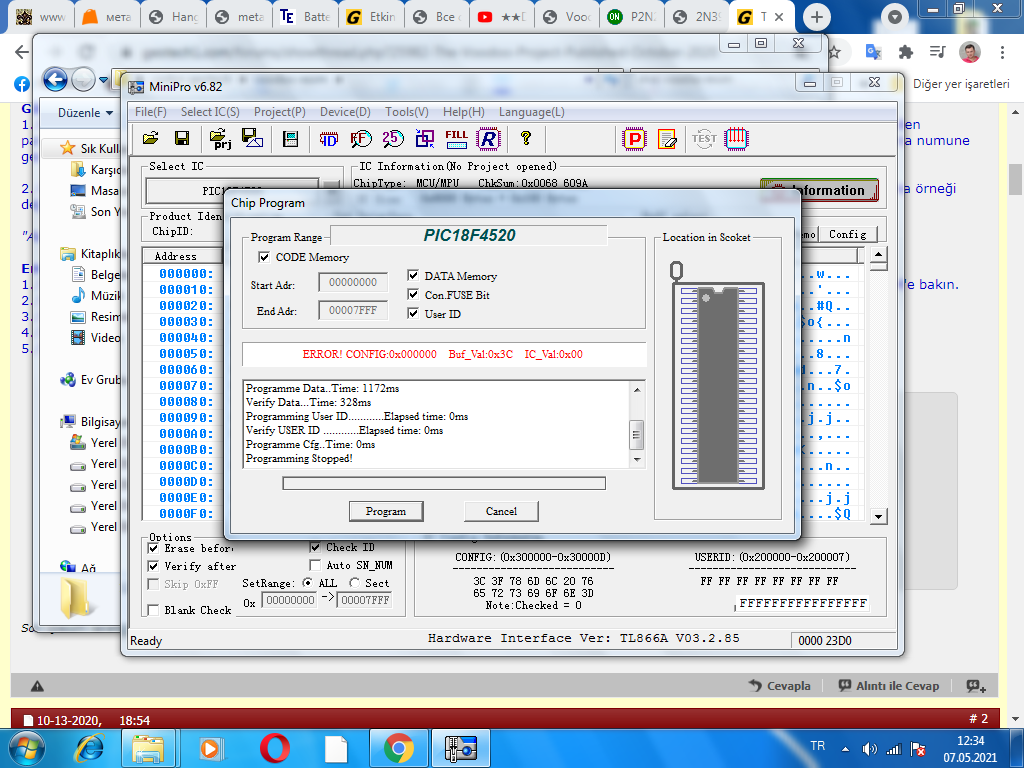

      • How is the correct fuse settings for the PIC18F4520?
        I am getting an error with TL866A minipro programmerClick image for larger version

        • Originally posted by andon80 View Post
          I am getting an error with TL866A minipro programmer[ATTACH]55139[/ATTACH]
          I think most of us used a PICkit to load the hex file
          • The hex code contains the fuse settings, and a PICkit uses those when programming the PIC.
            I've never used a TL866A minipro programmer. What does it require for fuse settings? Is it a file, or do you simply type in some numbers?
