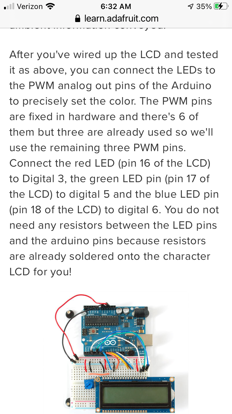

              • Hey George i have a question i have a rgb 16x2 lcd and i had it wired wrong its a 18 pin and 16 17 and 18 are the 3 led lights they can be controlled by microcontrollers its controlled by negative side anyway of wiring it where it will work with this microcontroller to change colors instead of using switches for each color this is how it get wired to a adrino Click image for larger version
ID:	359099 i know its not a 5 minute project just wondering if its possible without adding more pcb and parts
                • Never mind i see i need pins 16 and 17 the pwm pins and the screen shot i have has that part cut off so i have to go find a clear shot of all the pins and see if thats connected to anything or being used then figure out how it uses 3 wires but only 2 pins to control 3 different led colors learn the lcd library and make up some new symbols
                  • i have a rgb lcd and want to add functions to the menu to change the color hopefully with the pwm if its not used for something else and dont want the extra buttons on the case ill leave connected with switches for now to change the color any chance you can see if this possible with this project ?

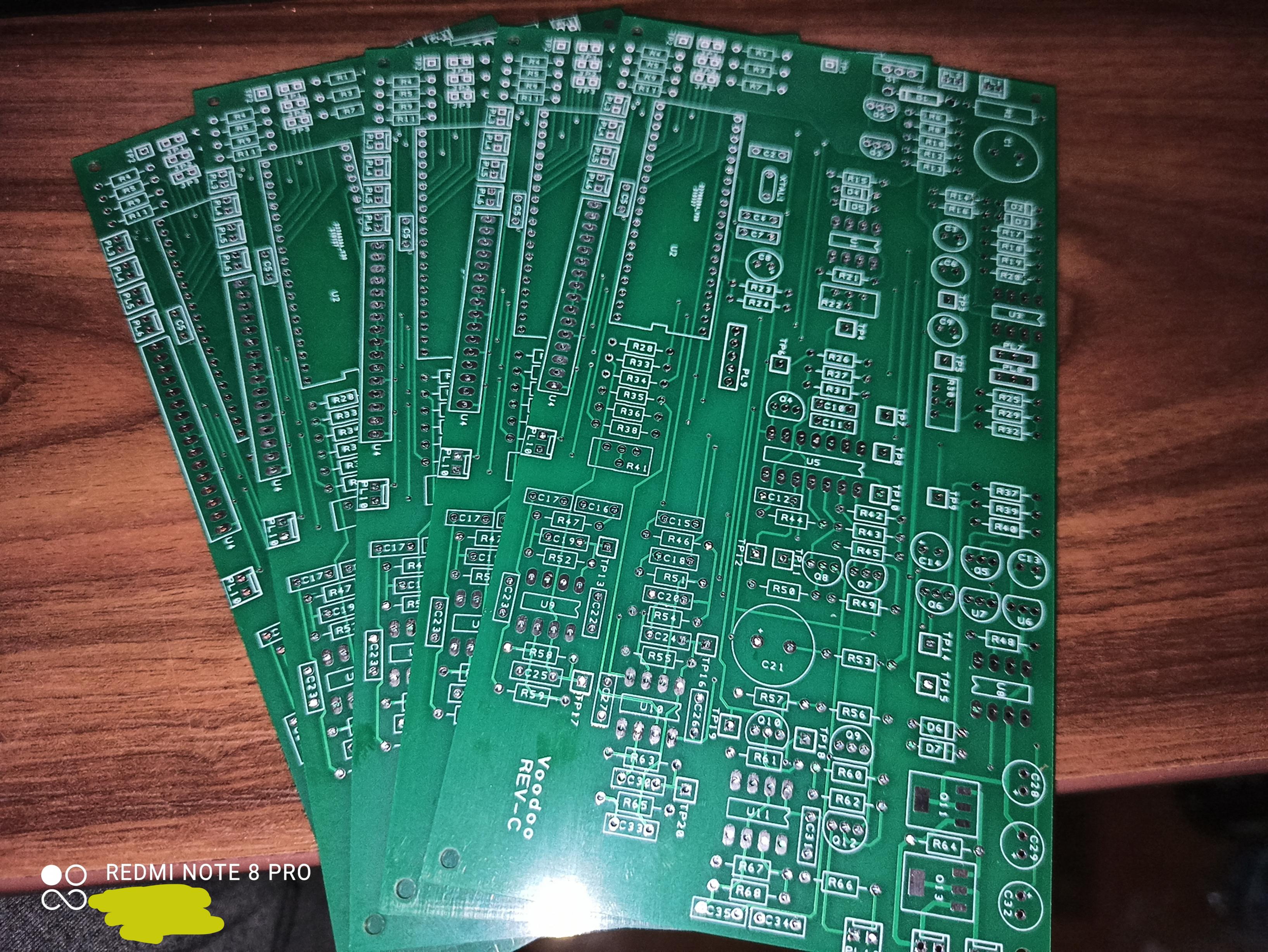

                    • I ordered some boards from JLCPCB and got them in under week.
                      PCB-s look nice, on some other revision i would like to see bigger pads for resistors for easier soldering.
                      Expecting book soon so that will be next project.
                      Cheers
                      • Originally posted by SilverSurfer17 View Post
                        The Voodoo Project is designed to use a 2-line x 16-character HD44780 compliant LCD module in 4-wire display mode. I cannot see any benefit to a metal detector of being able to change the LCD screen colour.
                        However, if you want to do that, it will require some hardware modifications and changes to the software. You will need to purchase a copy of Mikroelektronika's mikroC Pro compiler in order to modify the code.
                        • I have it already and ive seen whats involved just learning hello world or making symbols and i want to change the color for better visibility I've noticed already having the red on and the blue makes the letters easier to read but im also in a basement not in the sun id like to be able to use my detector without wearing reading glasses if possible and do it in sunlight with a shade built over the screen and i asked because what would take me days to figure out could be 10 minutes to someone else to do and i would make it up if i could maybe with some spare parts or in some other way but if its that big of a deal ill figure it out on my own like i have with most of this project already better yet ill just keep it on a switch
                          • Im sure you wouldnt see any advantage to making this into a two box idea but i do one of the major reasons i decided to build this was because of the discrimination its open source and i could build it the way i wanted to i want the leds on the face idea for the ferrous and non ferrous so i dont even have to concentrate on the screen i can be looking at the ground because voodoo uses the same tone for ferrous and non ferrous so i have to look at the screen and with using a switch im limited to using only 4 colors with using the pwm circuit i can change it to whatever color is best in what light thats why i asked about contrast in the menu also instead of a pod inside the detector
