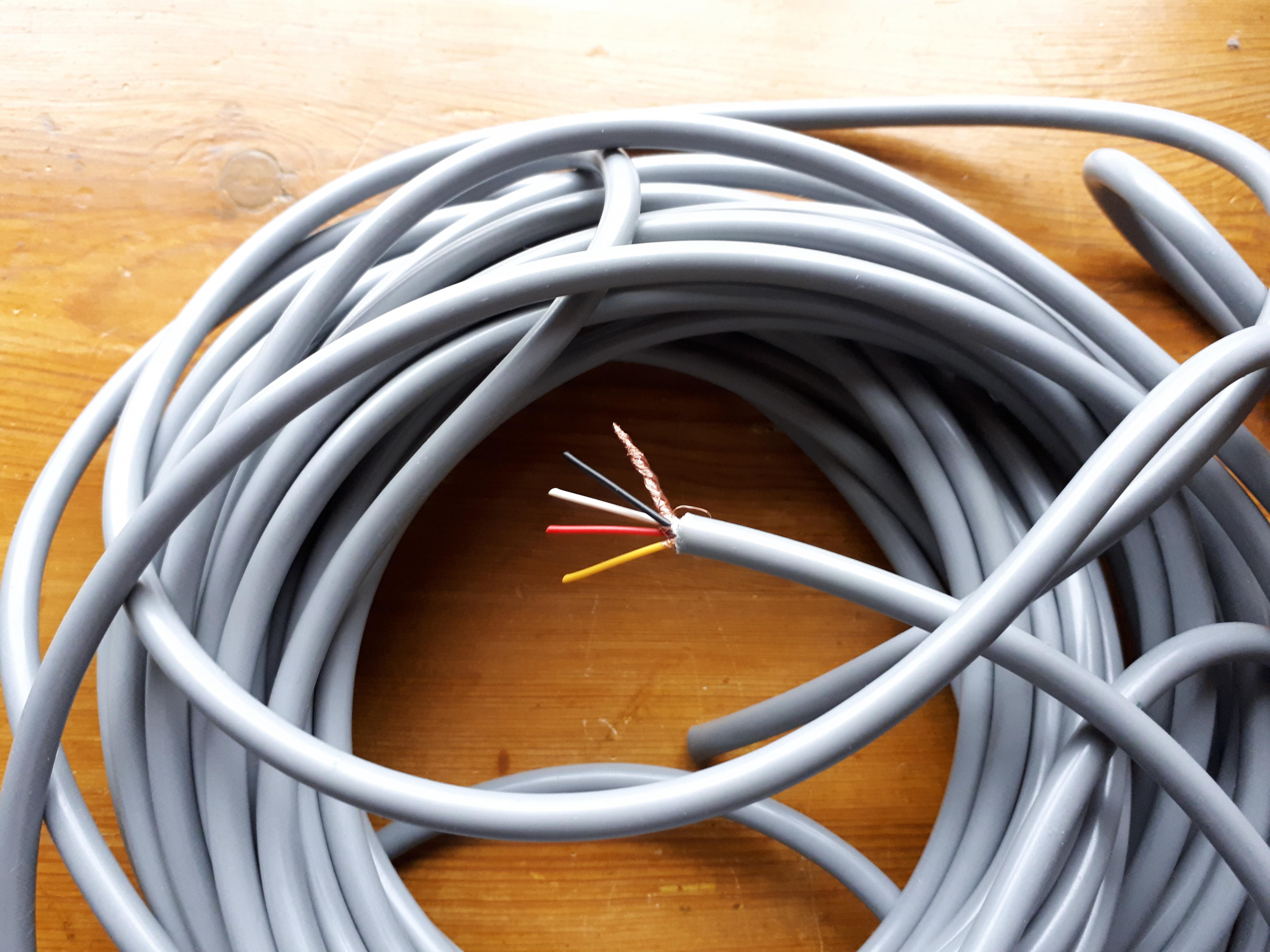

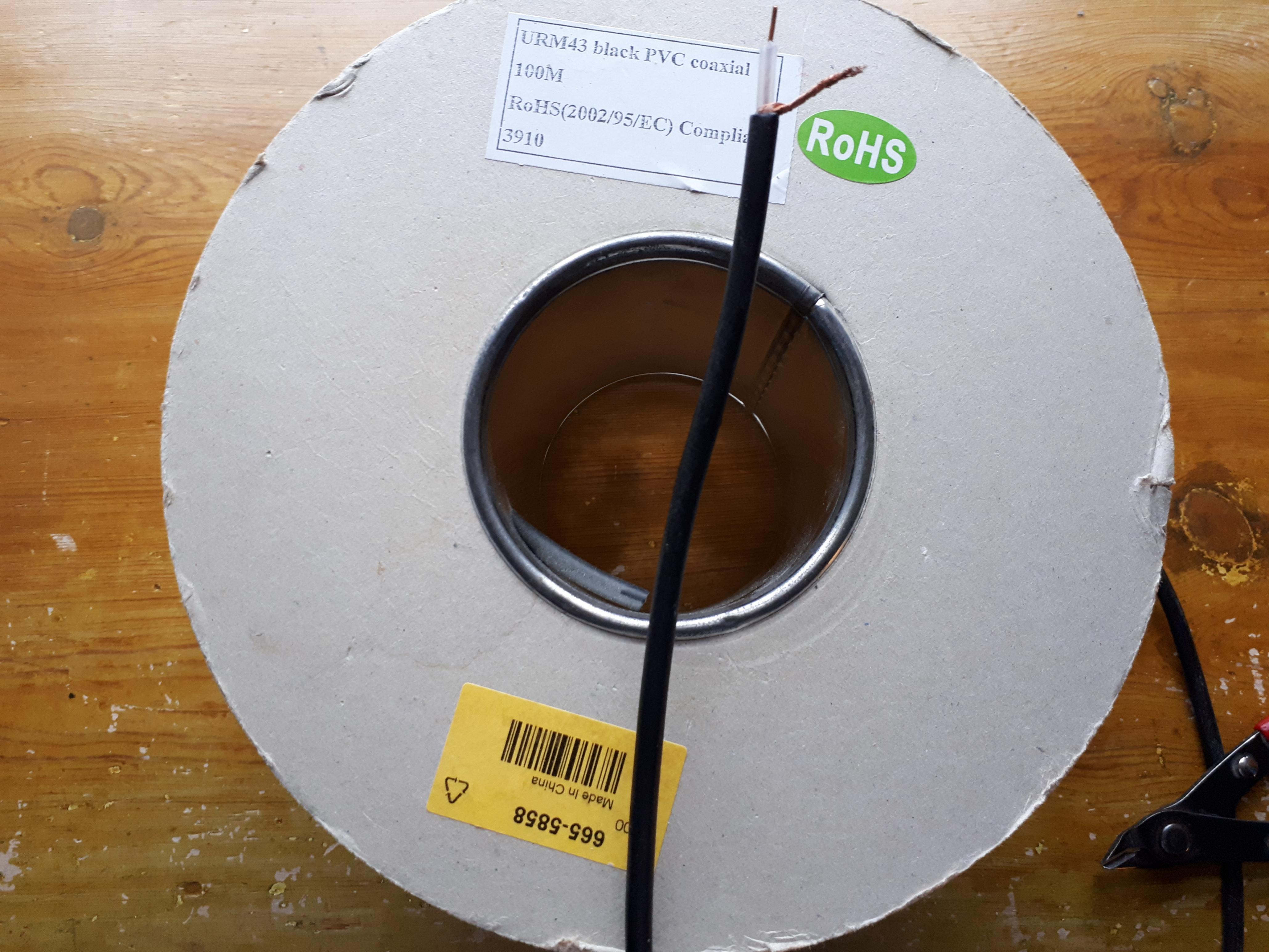

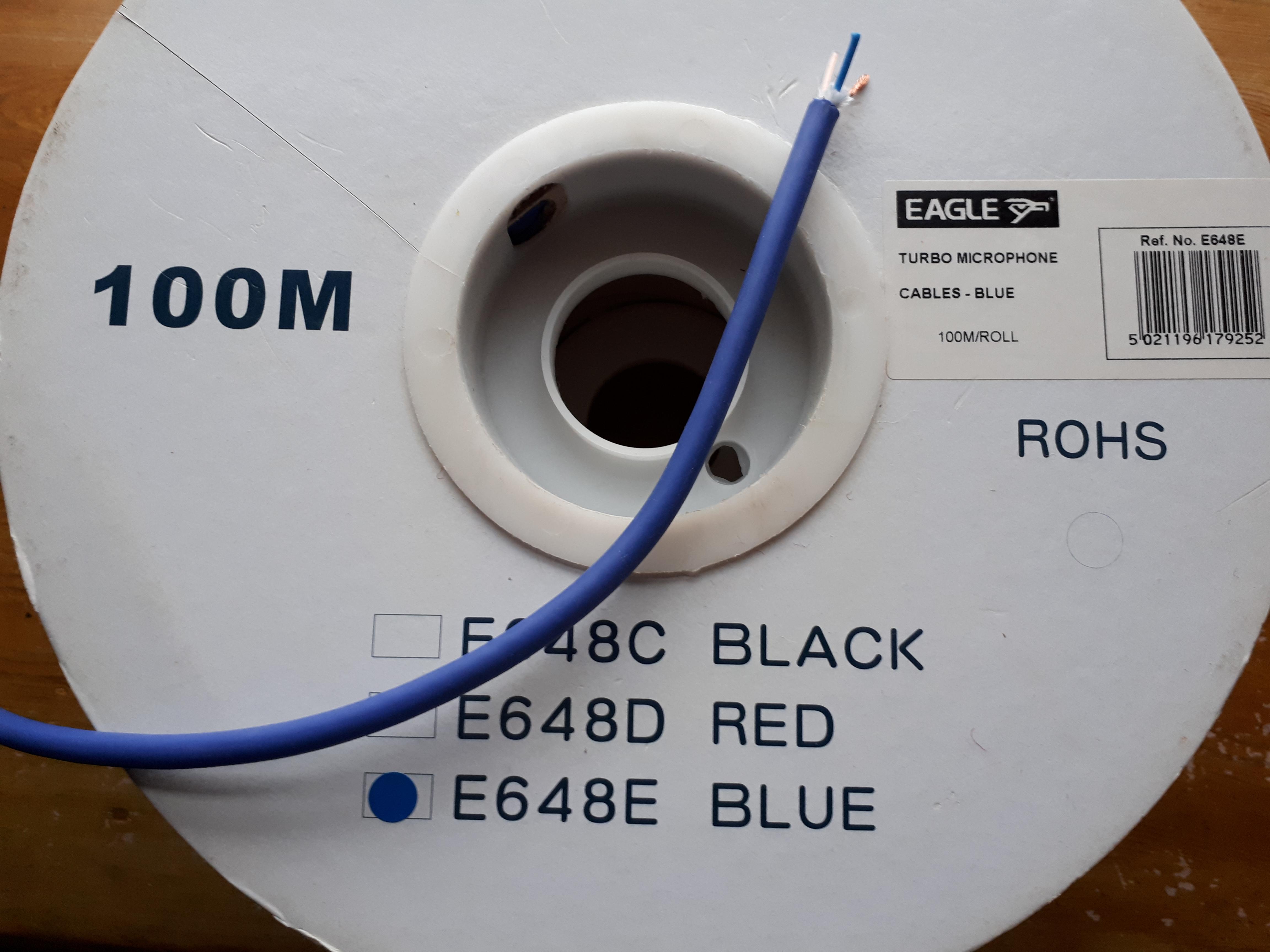

    Here are the cables I've been using in various projects:
    1. URM43 single-core ( very close to RG58 )
    2. E383E 2-core
    3. Flexible 4-core (type unknown)

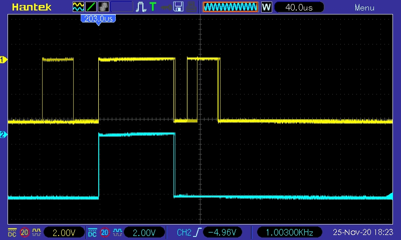

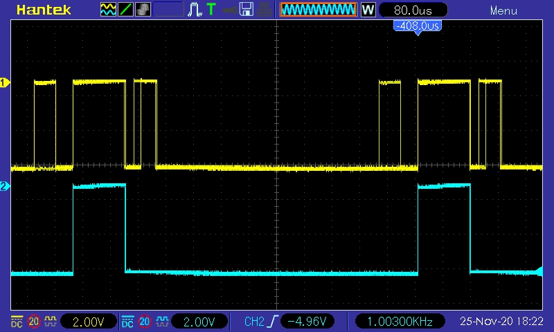

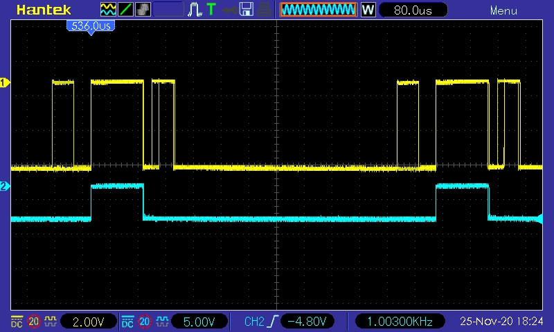

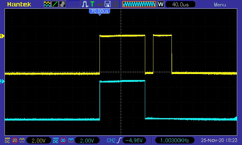

      Hiya George,,,I'm having a little problem with my build. I am getting +5v at TP14,,but I'm only getting 0.720v at TP15. I bought 2 x programmed PICs from Andy (Silverdog) and though I totally trust his programming skills I tried both PICs and still don't get the correct voltage at TP15. I re-programmed one of the PICS with the HEX you posted and still not getting the correct voltage at TP15. I have checked and double checked all the components I installed for correct placement and values,,I've checked for solder bridges and dry joints and I've totally cleaned my PCB. Could you tell me what I could try next please in the fault-finding? Should I try replacing the 79L05? The only different components I used were the FQT7N10LTF instead of the FQT7N10 which I couldn't find. Thanks, Regards, Marty.
      There should be -5V at TP14, not +5V.
      Assuming you meant to write -5V ... have you checked that there's a sync pulse from the PIC on TP9? This pulse clocks the LT1054 via Q5 and Q6. At the cathode of D6 there should be a voltage approaching +12V. This is then regulated by a 78L05 (U7) to provide +5V at TP15.
      The FQT7N10LTF mosfets must be OK, otherwise you wouldn't have anything working.
      • Thanks George and Alec,,,Sorry, yes, I meant to write -5v,,,I haven't checked the Sync pulse yet on TP9 (Too many house repairs keep surfacing during my build) but I will check that this evening then post these results. Great 2nd Voodoo video Alec! Regards, Marty.
        • I took some scope shots of my sync signal at TP9. Do these look ok? Thanks, Marty.
            Yes, it's working.

                Marty you need to be producing +5v before you can continue. Are you measuring ~+12v at the cathode side of D6?

                  • Hi Alec,,,No, I only have 8.42v at the cathode of D6. And still only 0.76v on TP15. Thanks, Marty.
                            Remove the 78L05 and measure the voltage at D6 cathode again.

                              • Hi George,,I removed the 78L05 and the voltage at the cathode of D6 is 9.89v. Thanks, Marty.
