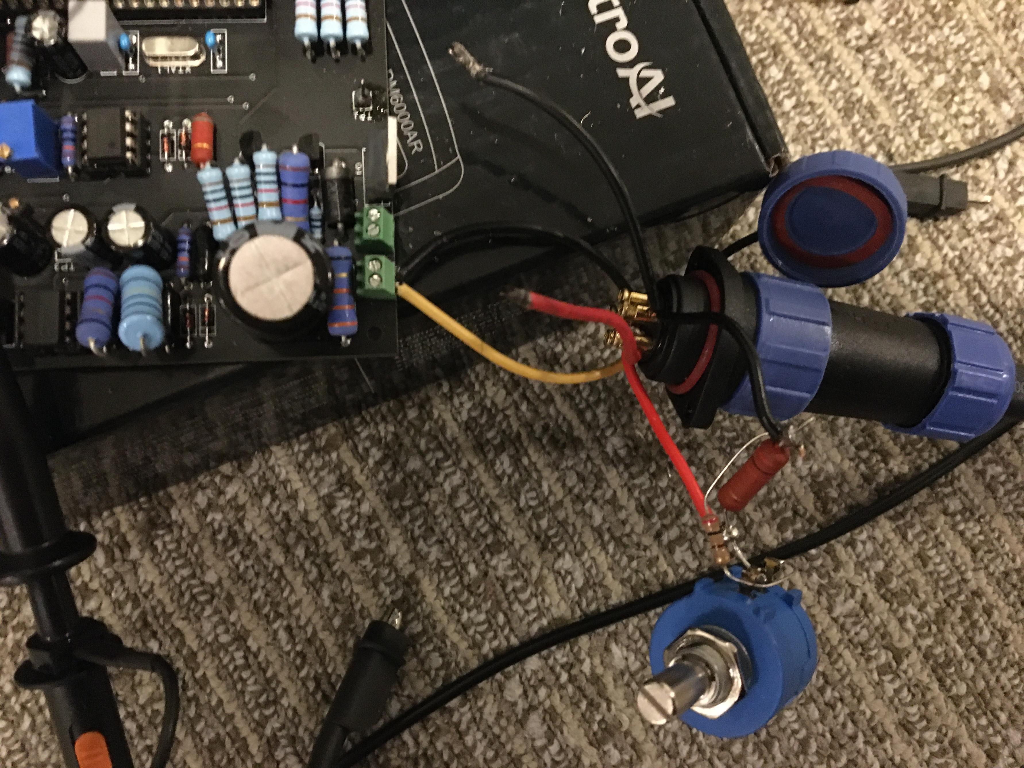

      You where correct i disconnected the tx loop and thought it was the rx this it with the tx connected [ATTACH]54366[/ATTACH]
      Post a clear picture of the transmit portion of your board with everything connected exactly as it was when you took this last picture. Coil, damping resistor etc...
      • The yellow is the tx the red is the rx the only difference from this pic and how it was connected before was i had the jig connected at the pcb now its at the plug not enough room at the pcb Click image for larger version

        • Originally posted by SilverSurfer17 View Post
          The yellow is the tx the red is the rx the only difference from this pic and how it was connected before was i had the jig connected at the pcb now its at the plug not enough room at the pcb [ATTACH]54370[/ATTACH] and the wave still looks the same also with the rx coil connected
          I am unable to discern from that picture how you have your coil connected or the damping jig. You might be better off to connect a simple bundle coil to test the transmit.
          • Originally posted by surfdetector View Post
            Neither can I. But I did notice that R2 is not 3R3.
            It should be orange-orange-black, not orange-orange-orange.
            • Ok ill pull that out and get the right one
                  From your photograph, it doesn't look like the red wire is connected. Could be mistaken of course.

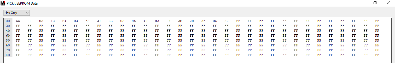

                    Hi Martin,
                    I will be able to determine the settings from the EEPROM contents.
                    The parameters are held in EEPROM bytes 1 to 18. Byte 0 will contain $AA, which tells Voodoo to read the EEPROM contents at startup. When the PIC is first programmed all the bytes are set to $FF. If Voodoo finds $FF in byte 0 at startup, it loads the EEPROM with default values and sets byte 0 to $AA.
                    You will be able to see the EEPROM contents using the PICkit. If you don't know how to read the EEPROM contents out of the PIC, then simply note them down and post the numbers here.
                    Hi George
                    finally up and running with the PICKit3
                    The attached image shows the contents of the EEPROM.Click image for larger version
Name:	EEPROM Capture.PNG

                              • Originally posted by MartinB View Post
                                Hi George
                                The attached image shows the contents of the EEPROM.[ATTACH]54372[/ATTACH]
                                The settings that were different to the defaults were:
                                Pulse mode
                                PI threshold = 2
                                TX pulse width = 180us
                                Main sample delay = 49us
                                Number of PI readings to average = 40
                                The DISC settings are irrelevant as the detector is set to pulse mode.
                                I set my Voodoo detector to the same settings ... and it locked up.
                                After re-flashing the PIC I did some experimentation with the settings. It appears that there's some strange interaction between the TX pulse width and the main sample delay. This only occurs when the TX pulse width is set to 180us and the main sample delay is above 40us. All other combinations seem to be ok.
                                Now to figure out what's causing it .....
