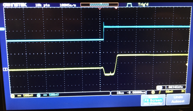

ID:	359241Ok back to where i was at the start no tx coil connected and only the jig connected to the tx channel and its the same as it was before using the ac to dc power supply but it looks backward still even using dc

                            [ATTACH]54563[/ATTACH]Ok back to where i was at the start no tx coil connected and only the jig connected to the tx channel and its the same as it was before using the ac to dc power supply but it looks backward still even using dc
                            pages 28 to 32 in the book maybe will help, not sure

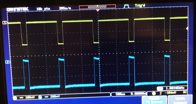

                            • Ok surf thanks that was part of the problem plus i had the prob on backwards on the resistor jig now it looks just like yours did in the video so the transmit portion works now what this is where im running into trouble checking it with a mono coil it doesnt beep it doesnt look right for the wave forms but sometimes i can see the wave move when i run metal by the loop
ID:	359243 how do i flip this around to look like in the book that looks like 90% of the battle ?
