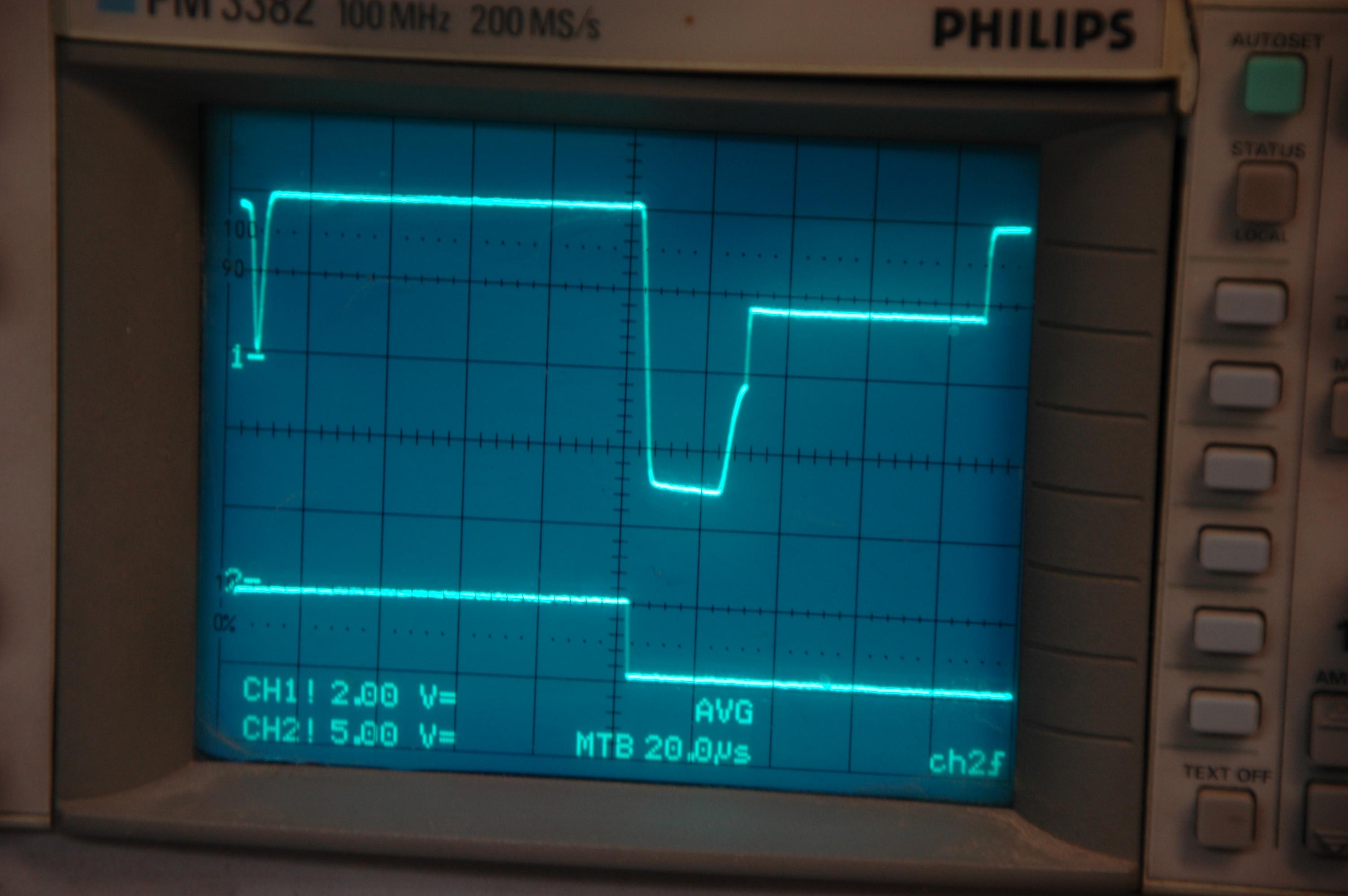

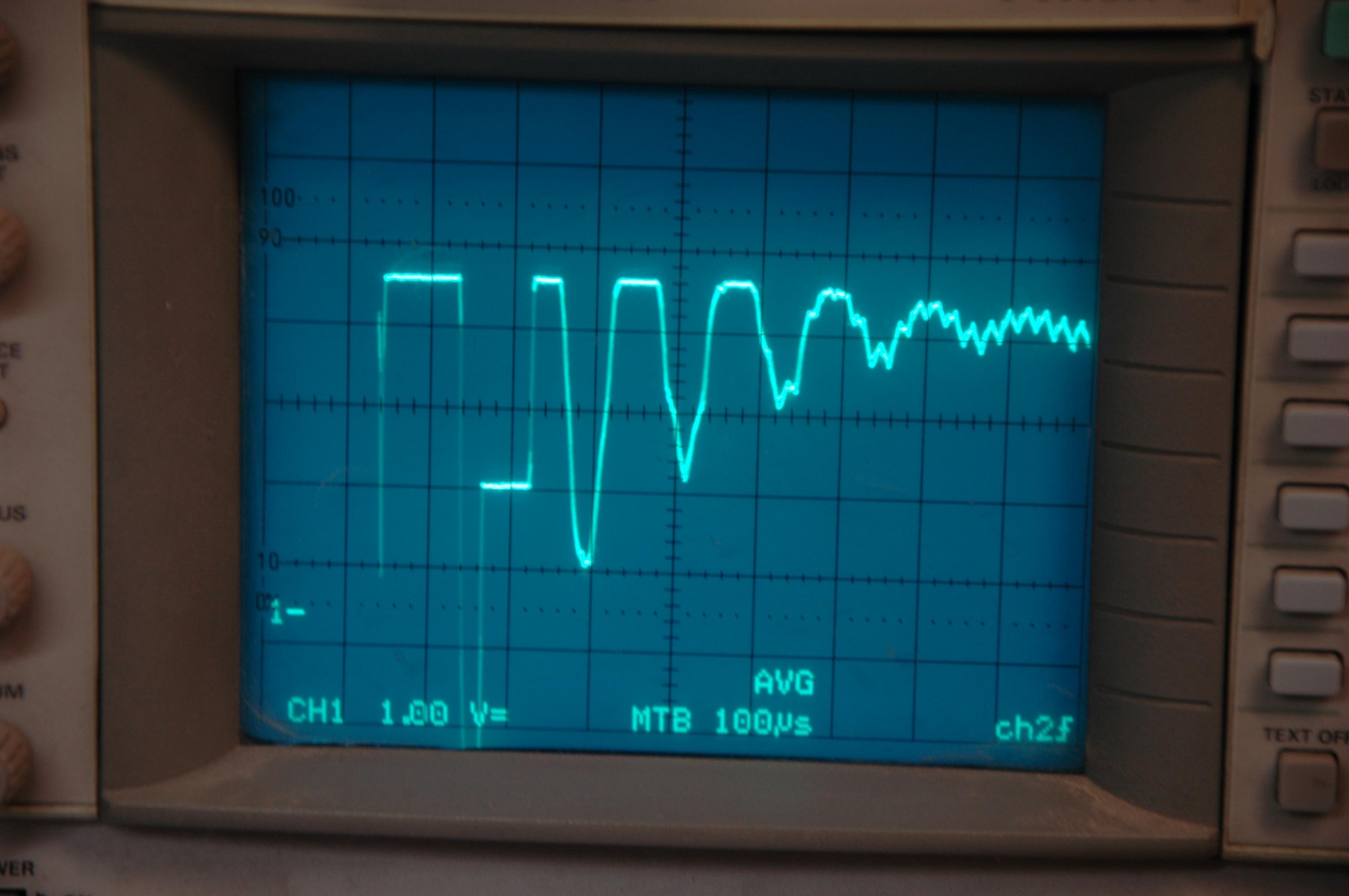

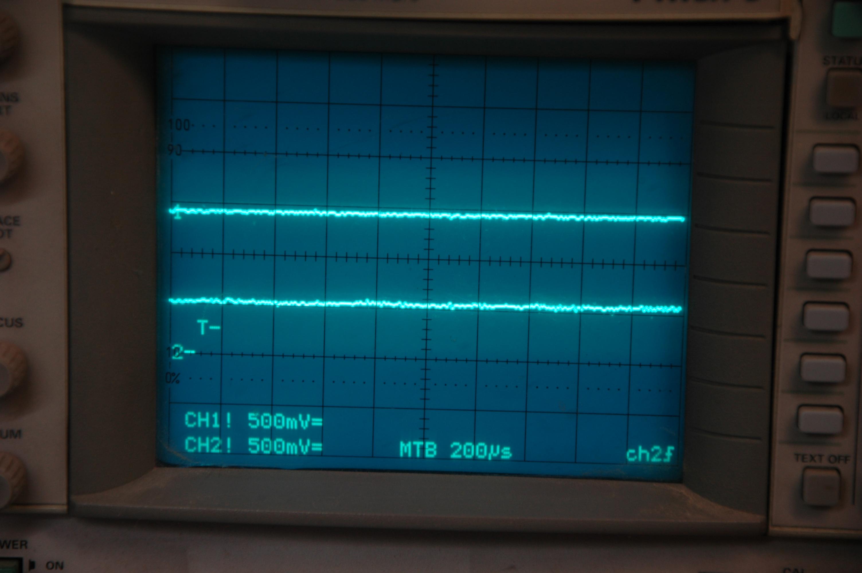

    bonjour George,
    here are two images,
    tp6 tp10Click image for larger version
    tp 7 tp8 Click image for larger version

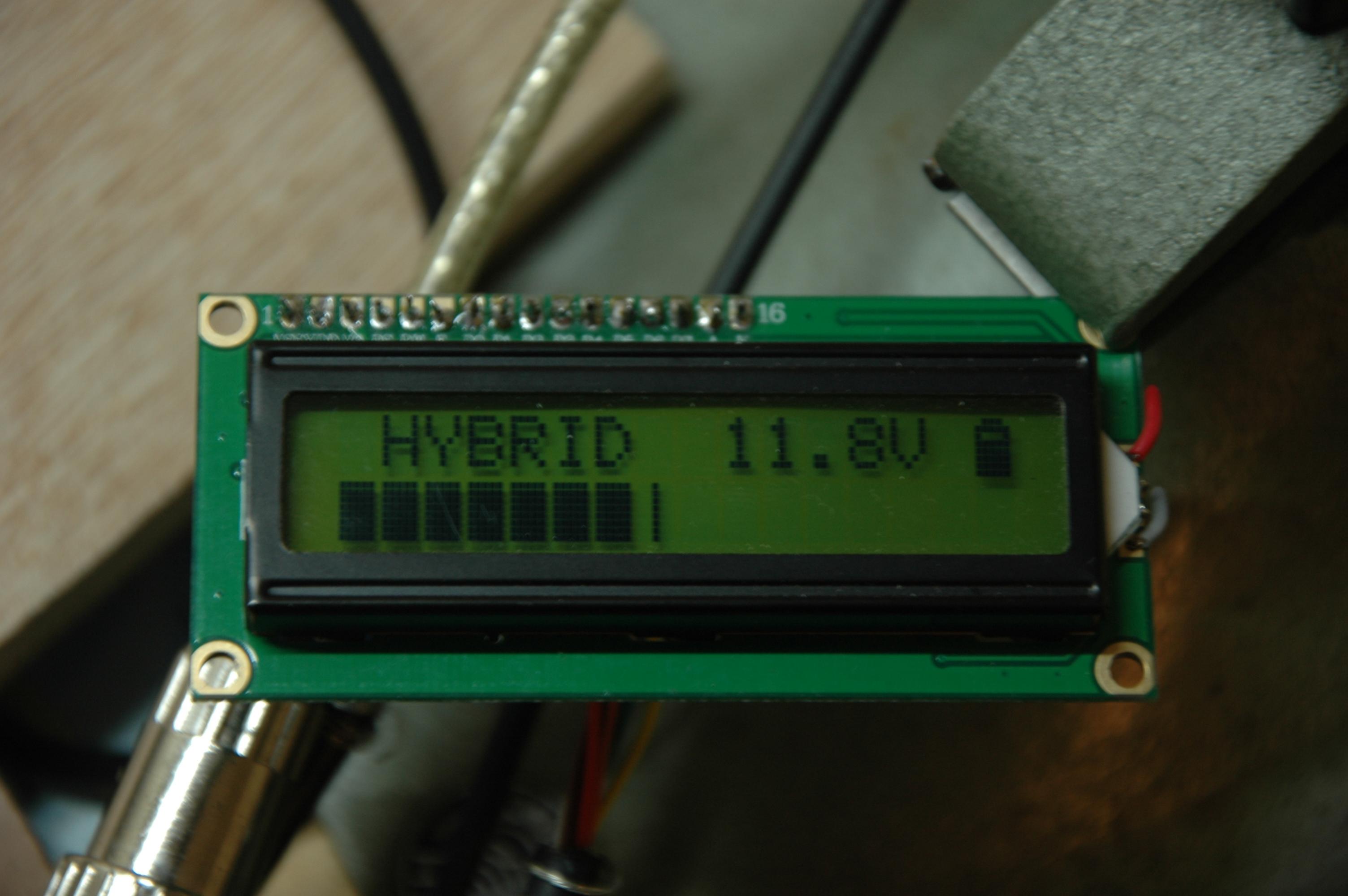

    I also noticed that in hybrid mode, the non-ferrous bar is at maximum, with no target above ..
    • I see absolutely nothing on tp 8 ... why ..
      • Originally posted by lamoiz View Post

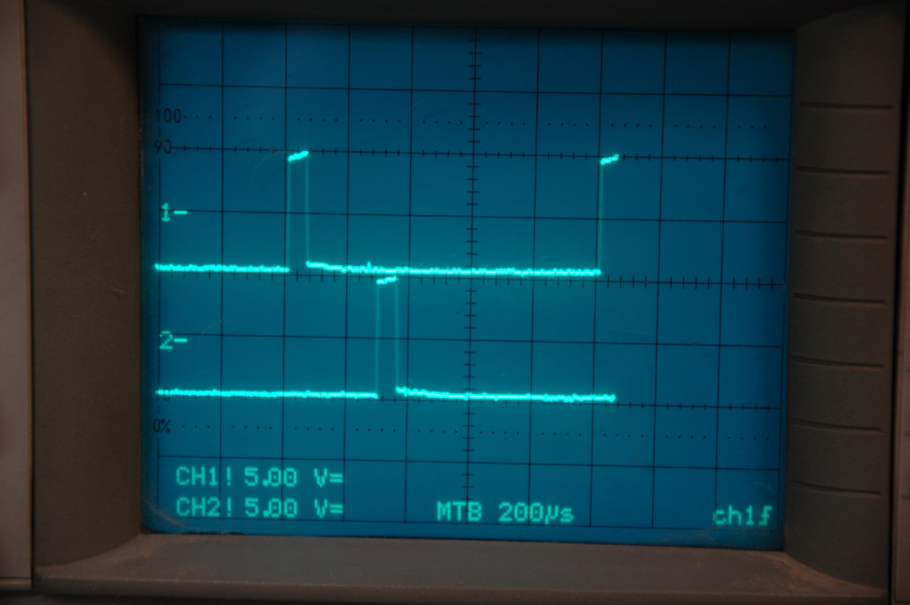

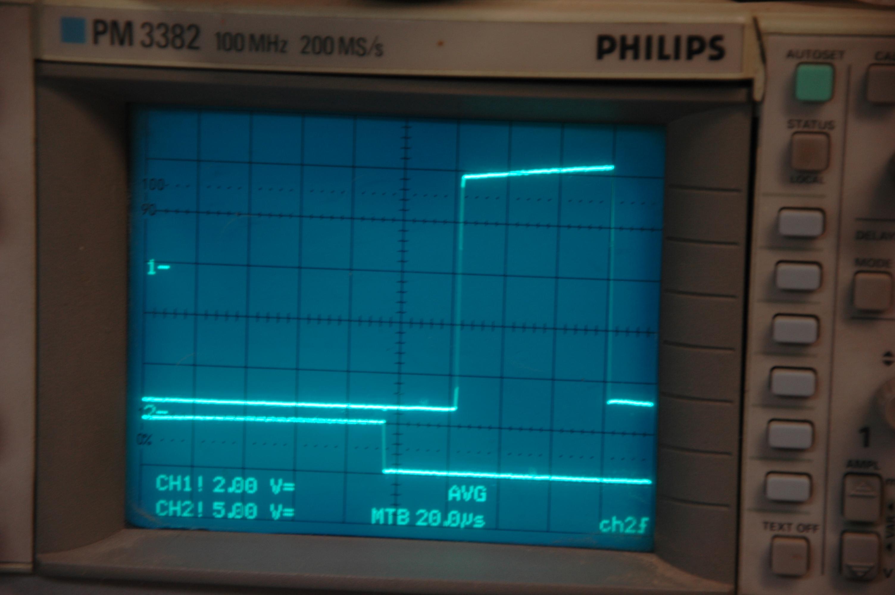

        Hi lamoiz would you post a picture of Pin #1 and Pin #13 from the 4066?
        • Originally posted by surfdetector View Post
          hi surf, thank you for helping me here are the pictures of pin 1 and pin 13. there is also tp2 debug on it ..
ID:	358690Click image for larger version
ID:	358691Click image for larger version
            [ATTACH]53881[/ATTACH][ATTACH]53882[/ATTACH][ATTACH]53882[/ATTACH]

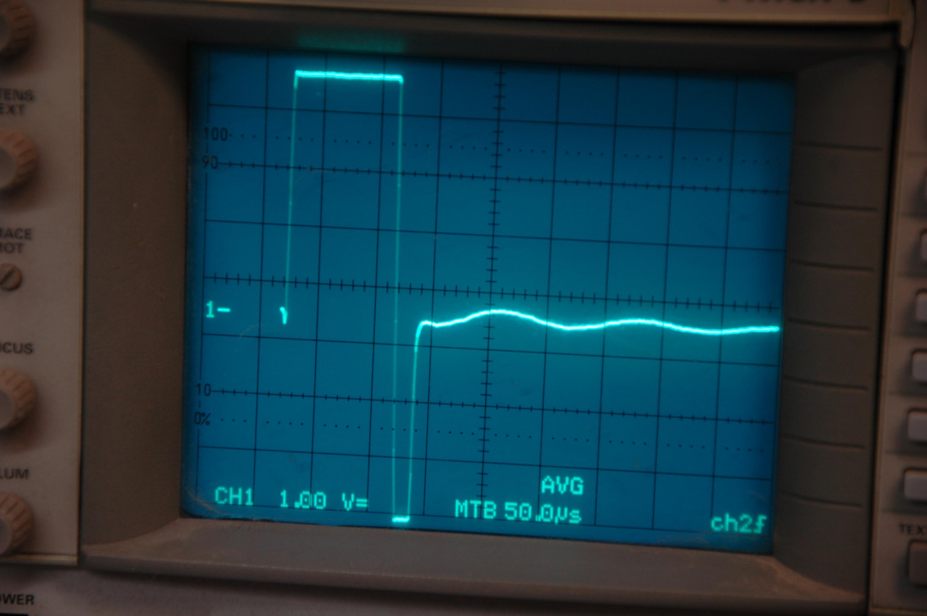

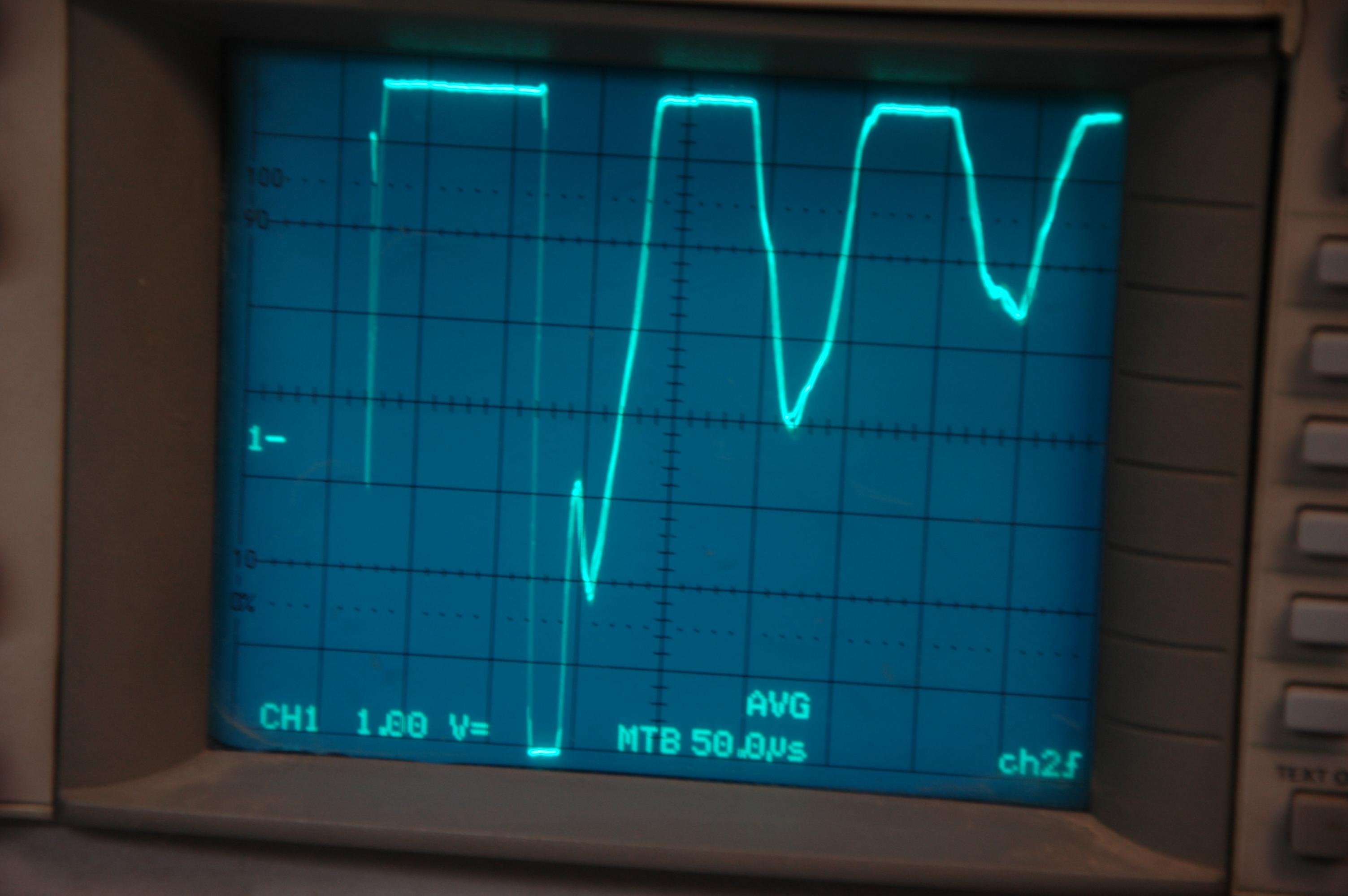

            Hi, Are you on 10x attenuation on your probes and also on the oscilloscope? The amplitude of your signals does not look correct it is much too small I think.
            Can you show Pin #1 of the 4066 again at 100uS
            Please also show Pin #1 and #7 of the 5532
              here are the curves with the 10/1 probe. 1 from 4066 and 1 and 7 from 5532 ..
              thanks Alec
ID:	358692Click image for larger version
ID:	358693Click image for larger version

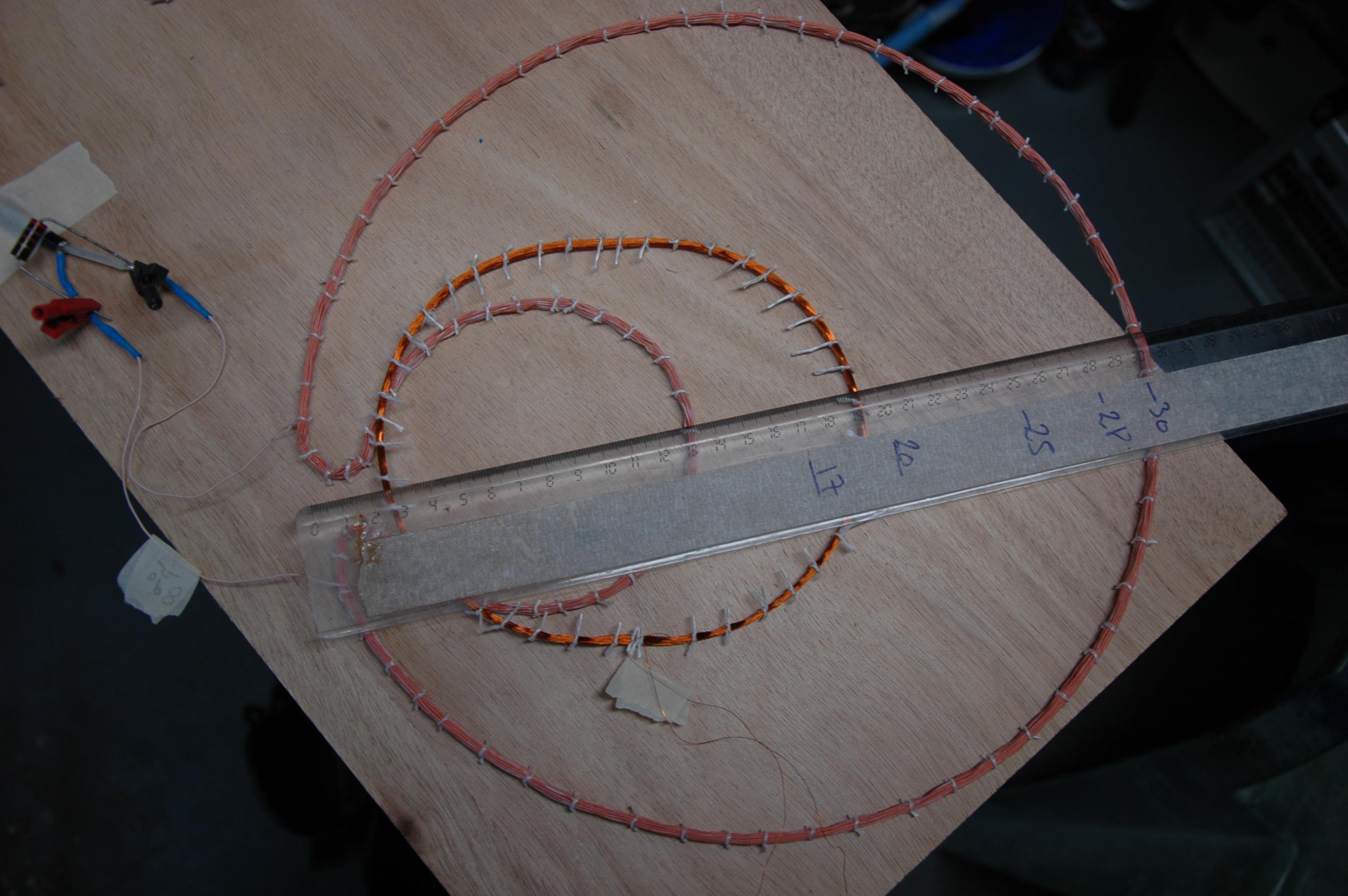

              • hi guys, i found what is generating poop signals. no more beep beep beep, I had made an extension of cable between the circuit and the various coils to be tested .. in fact it's been two weeks that the circuit works perfectly .. but because of this nasty cable (test) well i had all the miseries in the world .. the circuit works very well .. cool.
                this afternoon I will do the coil with the rg58, normally the result will be good!

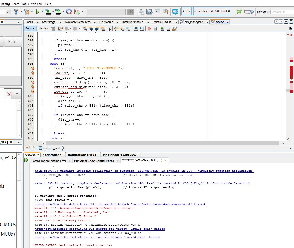

                    • Had some spare time tonight so started porting the Voodoo code to XC8 compiler.
                      Pretty much down to adding the ADC/LCD header files and a small number of syntax changes to go.
                      Should be completed over the next night or two if time allows...
                      I haven't built the hardware but can compile and post the project files along with the hex file if someone would like to try it. Will be a little while til I get round to the hardware.

                      • hi Surf, hi George, yes the output is correct now, it's crazy how sensitive the wiring is between the winding and the electronics. may be a capacitive effect .. ?? I just did a test on a winding in litz wire, .. the result is very very good ..
