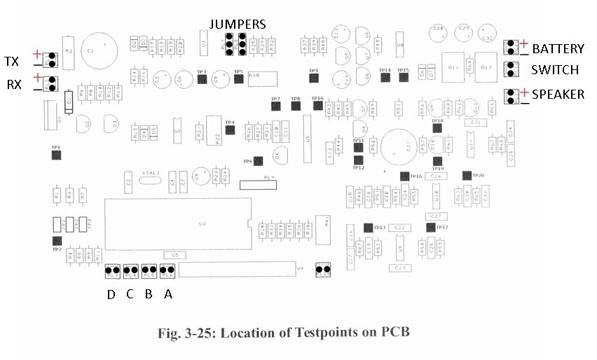

                  • Hiya George. Could you tell me if I've marked this diagram correctly please? And also, The 'PL' plugs marked A, B, C and D, which one is Menu, up, down and enter please? I was going to start building today but realised I had to wait for my order of 79L05's. Thanks, Marty.
                      Menu (RC6) = "A"
                      Up (RC5) = "B"
                      Down (RC4) = "C"
                      Enter (RD3) = "D"

                        • Have I put the 'Positive' and 'Negataive' symbols in the correct place on my diagram? Really struggling to see all the details on these small drawings in the book,,,Must be old age and my eyesight!,,Lol,,Thanks, Marty.

                            That's correct.
                                All looks good.
