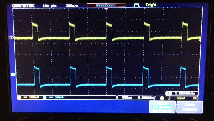

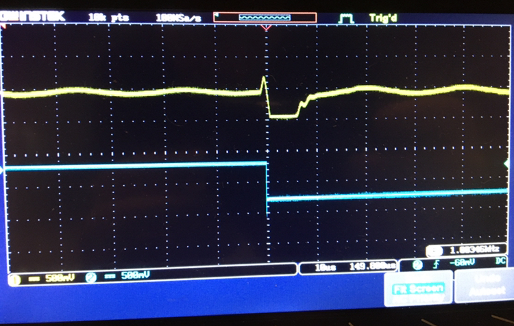

No i didn't see that you posted that i don't have a damping resistor yet i thought thats what the jig was for was to find out what resistor you need by tuning it to be damped then ohm out the jig to see what resistor you need and I'm pretty sure it kinda works already i can see the wave bounce when i run metal past the coil but how can i see what resistor if the wave isn't correct to start with also im starting to think those higher wattage resistors maybe a factor because i noticed when i turned the voltage down to almost 6 volts the wave looked a lot closer
The higher wattage rating is not going to effect the working of the circuit. Ohm ratings are a different matter. You need to check the ohm ratings of everything that you have landed on the PCB so far. You should also prove your transmit pulse is correct as I told you previously prior to continuing.Originally posted by SilverSurfer17 View Postim starting to think those higher wattage resistors maybe a factor because i noticed when i turned the voltage down to almost 6 volts the wave looked a lot closer

Originally posted by SilverSurfer17 View PostIm going to just order 1/4 watt resistors and replace those monsters i put in can i use just the jig or do i need to order a certain size like 10.5 or some starting point resistor ?
did you check every part manually before you installed it, very good point the surfdetector made a video on, and in making the video proved a resister, or a part was bad right out of the package.

I don't want to have to buy 15 different ohm values for it if there is a way with the jig to know the exact ohm value of what it needs from what ive seen those type resistors aren't cheap i knew i would have problems with the tuning part i didn't think as much building the board ill check all the values later on the resistors to make sure they are what they are suppose to be
