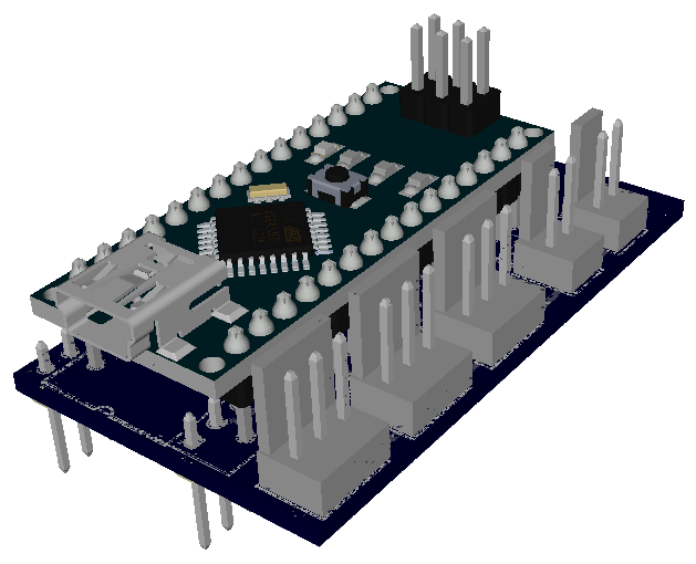

Arduino Nano Adapter Board For Voodoo
As promised ...
An adapter board that allows an Arduino Nano to be fitted in place of the original PIC18F4520 has been created.
There is a short description in PDF format attached below, along with the DipTrace files, Gerber and NC/Drill, and the Arduino sketch.
Enjoy!

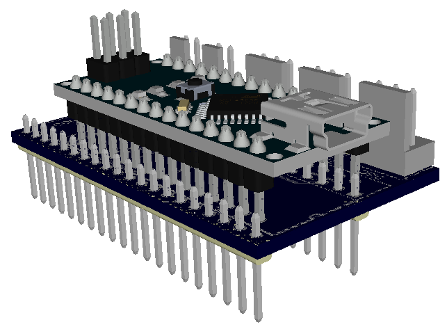

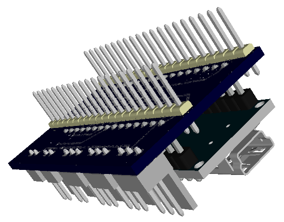

You can see on the adapter board that there are two footprints that overlap each other. CONN1 is the connector for the PIC, and U1 is the Arduino Nano. You need to solder two 20-pin male headers to the bottom of the adapter to allow it plug in where the PIC usually goes, and two 15-pin female headers on the top of the adapter so that you can plug in the Nano. The 3D images below should show this more clearly.Originally posted by 6666 View PostThanks George, are there any more pictures of the adaptor pcb in and out of the main pcb ?, just trying to work out the mounting.

Originally posted by Qiaozhi View PostYou can see on the adapter board that there are two footprints that overlap each other. CONN1 is the connector for the PIC, and U1 is the Arduino Nano. You need to solder two 20-pin male headers to the bottom of the adapter to allow it plug in where the PIC usually goes, and two 15-pin female headers on the top of the adapter so that you can plug in the Nano. The 3D images below should show this more clearly.
Thanks the 3d pictures explains it ,
