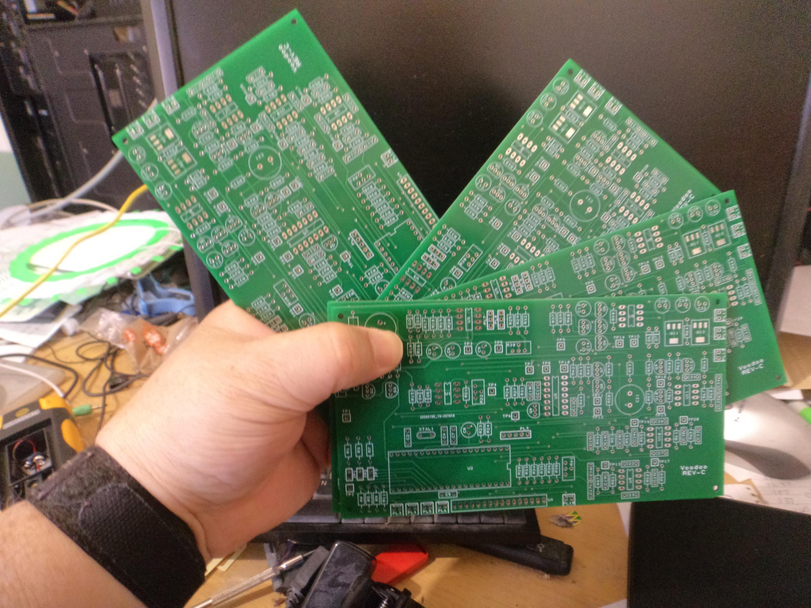

              • PCB's have arrived no thanks to dhl,
                they look good, now the longer wait for the book.
