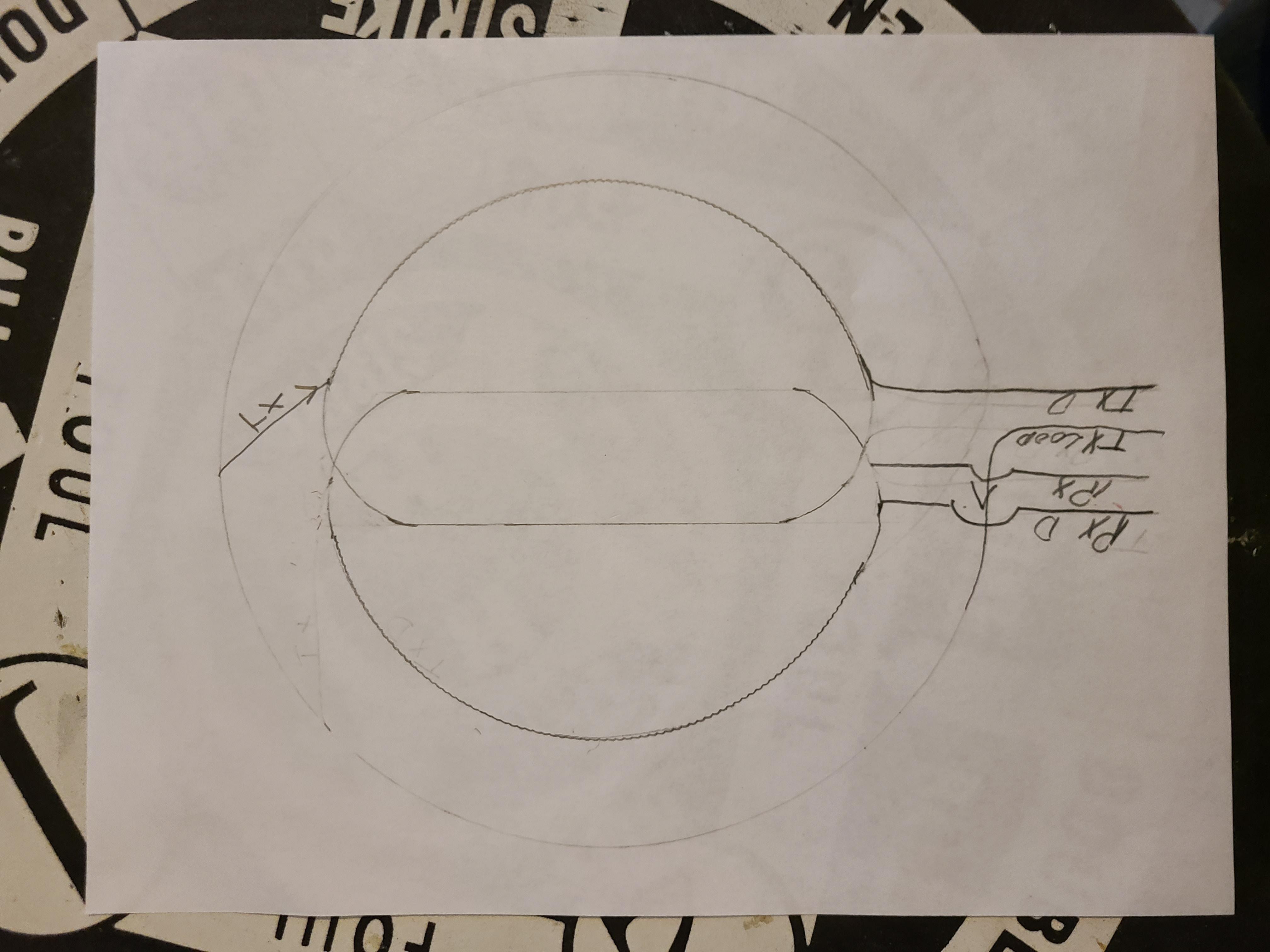

          Hi Qiaozhi,
          Been thinking about the dual field thing and wondering if you thought this configuration could work?

          Thinking that maybe we could get the benefits of a dual field in pi mode and give it a larger detection area and while in hybrid mode the possible benefits of a DD for separation of targets.

            It's a bit difficult to follow the wiring in your diagram. Can you make it a bit clearer?

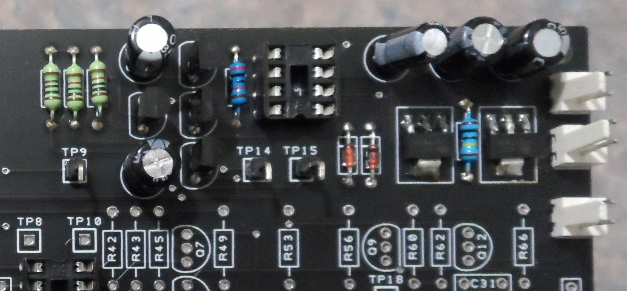

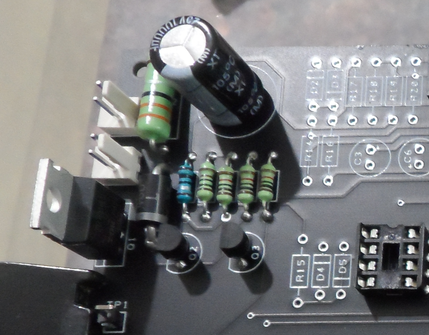

            • Hi All,,,Found time between repairs to install STEP 1:-The Voodoo Power Supply and TP1,TP9,TP14, TP15 + PL9. STEP 2 will be The Transmitter Circuit. Regards, Marty.

                Could you clarify the winding directions please

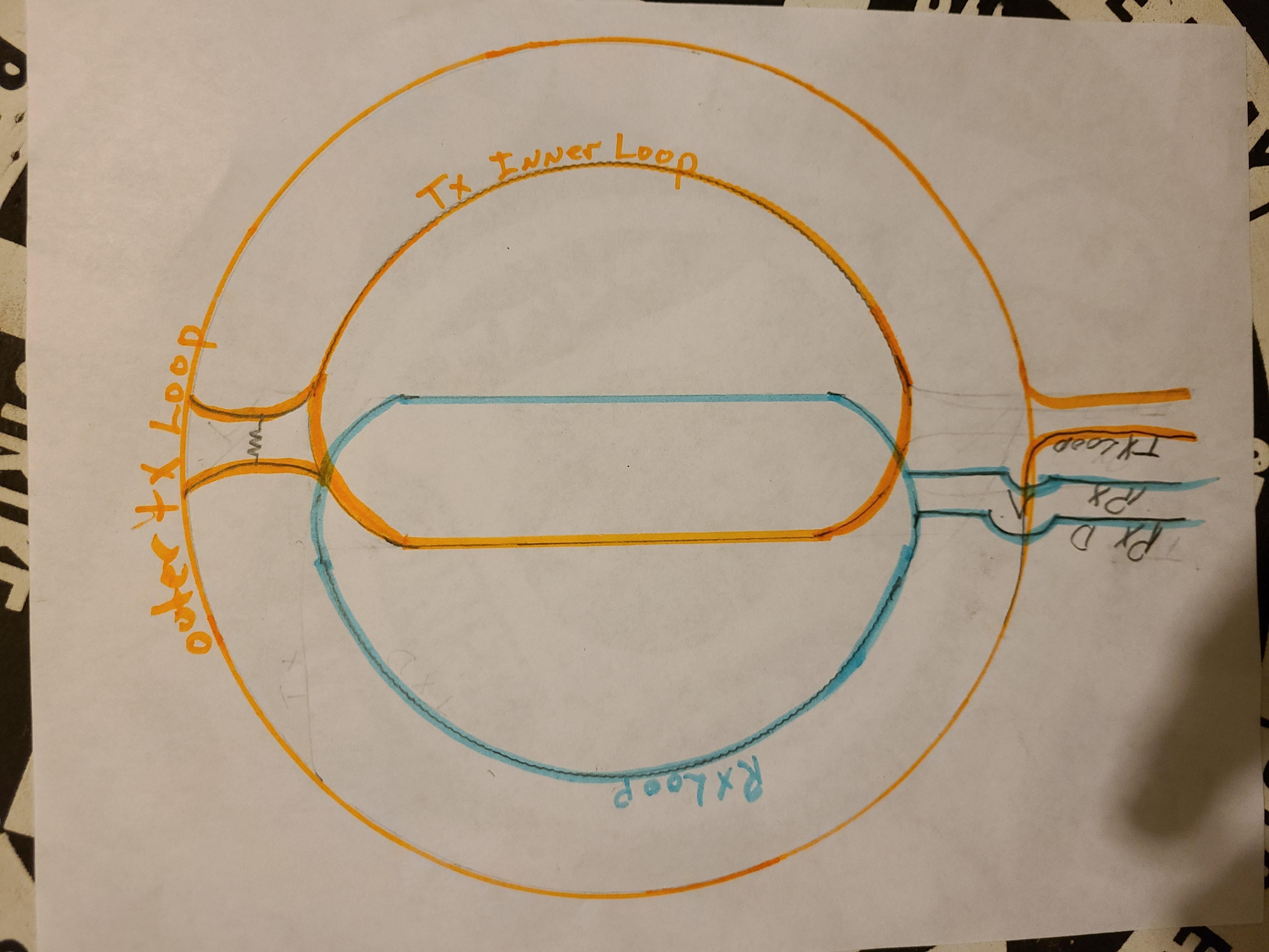

                  Something like this. I was thinking wrapping the dual field part as you would normally except to a d style inner coil. The wraps of the inner coil could be played with a bit to get a lower transformation ratio between ds to act as a bucking coil I'm thinking and or that wont matter if it balances out like a regular DD the later preferred. the Rx DD of course would have to be phased properly.
                  I have enough coils around to do a experiment thinking might throw something together and see if I can get it to null.
                  No small DDs so I may go 12" outer round and 4" double OO for the DD portion since I have them.
                  Thanks again for All this .
                    Hi 6666,
                    I think I have to do some experimenting to see if this could work. It was mainly a thought experiment but I'm in coil mode and I cant stop thinking about it.
                    • Don't think it will ever balance.
                          Carl beat me to it.
                          I really cannot see how that configuration would balance. Obviously the 2 DD loops will balance on their own, but then you've added a large TX loop around the outside that upsets everything.
                            Correct
                            • That's Why I ask Thanks Guys It Was A thought. But I think it can be done as a 3 coil concentric. Maybe a 12" 8" and 4" for the rx, two outer coils as the dual fields damped as normal Rx coil bucked off inner dual field coil should work just like a concentric.
                              What do you guy think about that one.

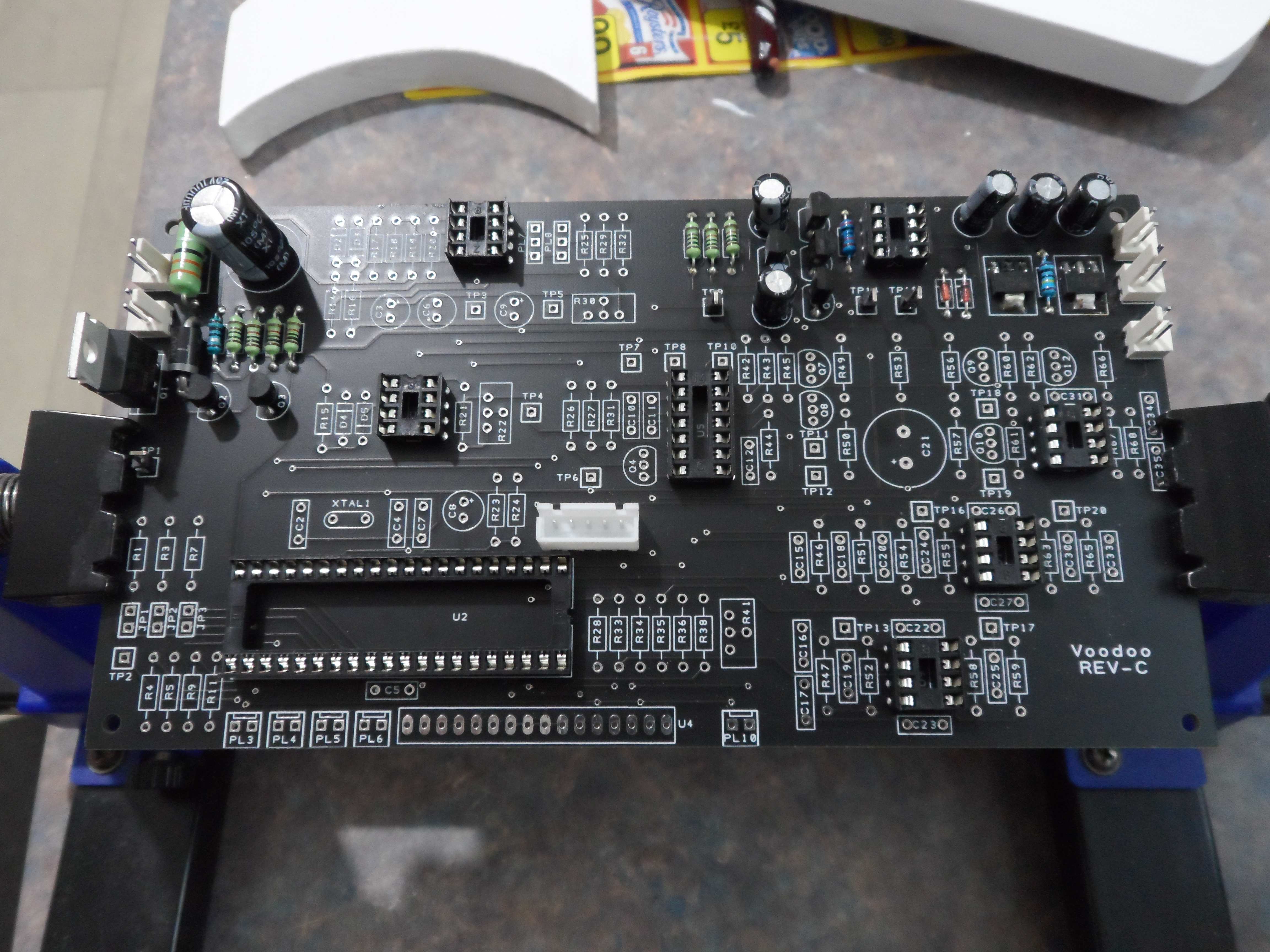

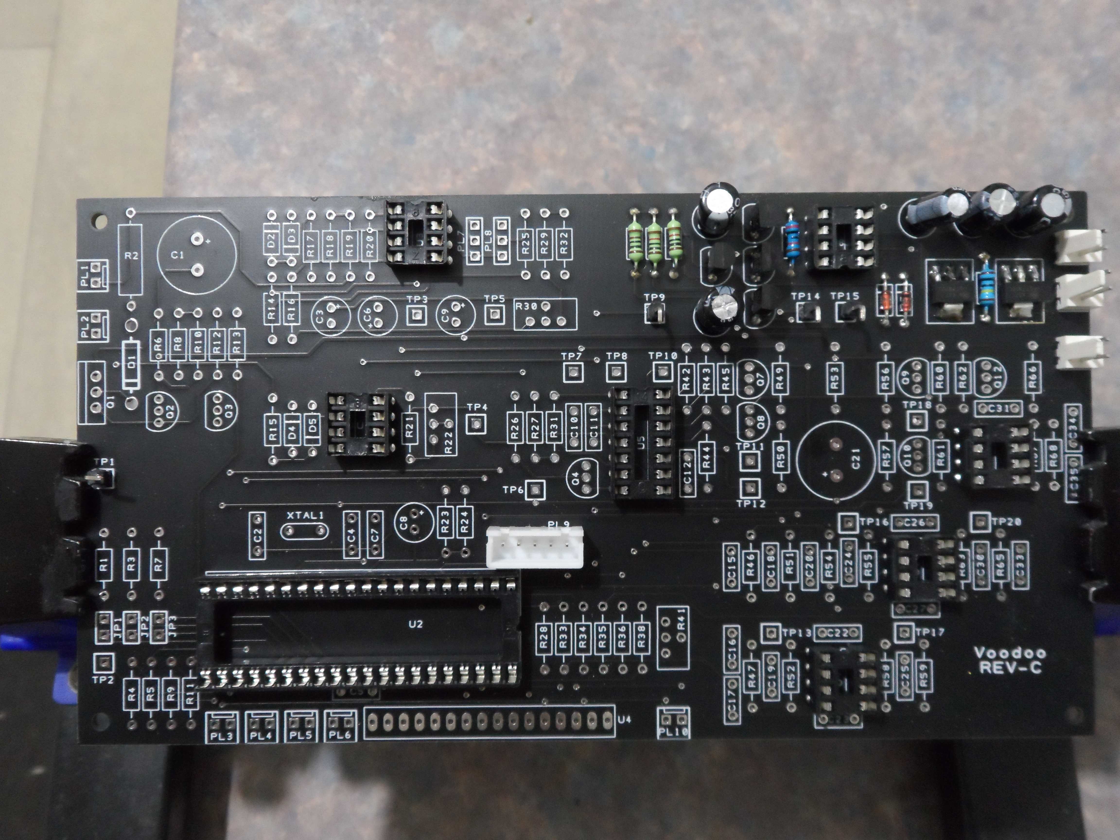

                              • Hi All,,,,STEP 2:- Transmitter Circuit complete. Next,,STEP 3:-Installing the LCD and Buttons,,,I first have to decide which enclosure I'm using and whereabouts on the Detector shaft it will sit so I can measure how much wire I need for the LCD and Buttons.
                                How can I test that the Transmitter circuit is functional please?Thanks, Regards, Marty.
