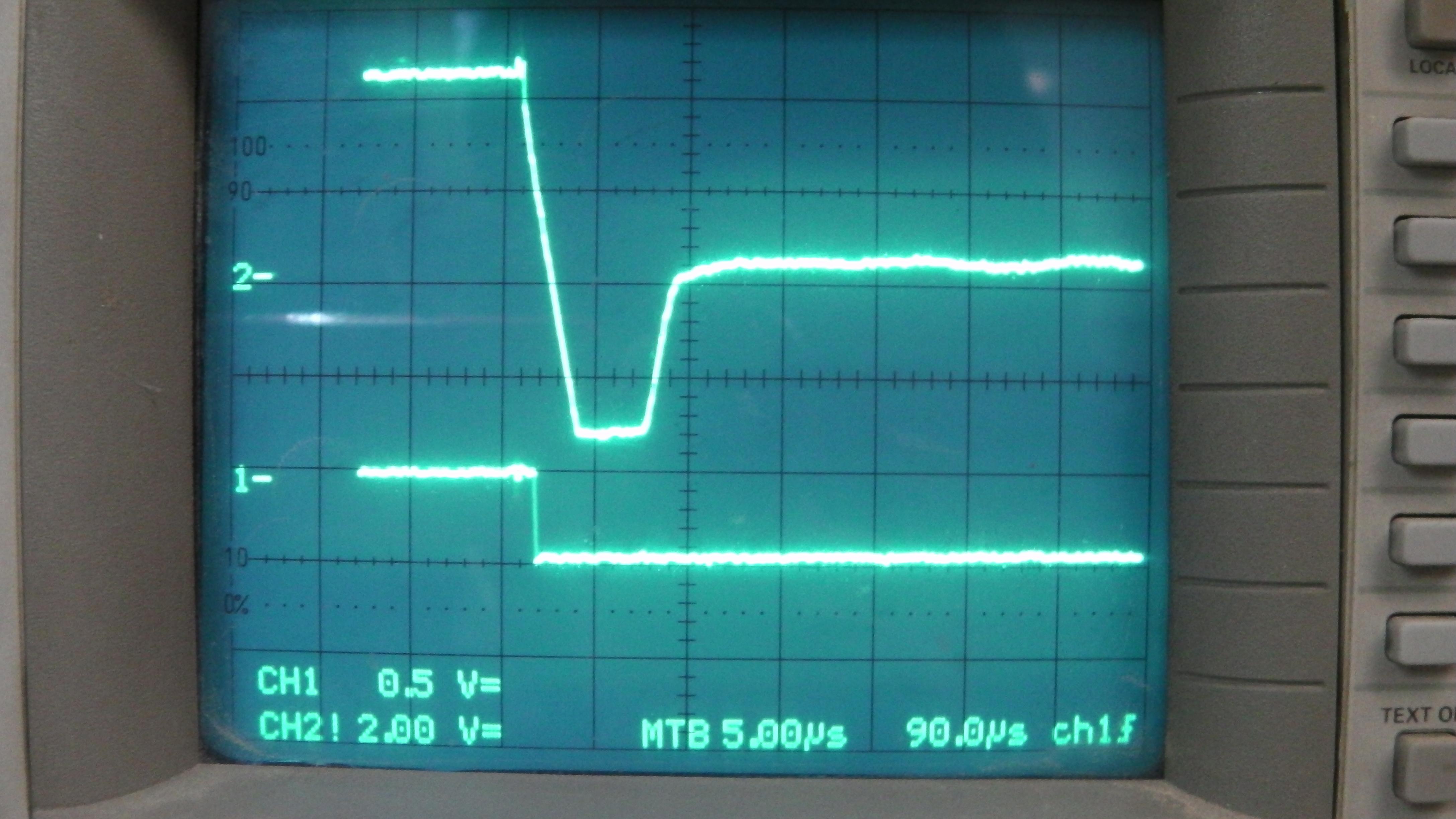

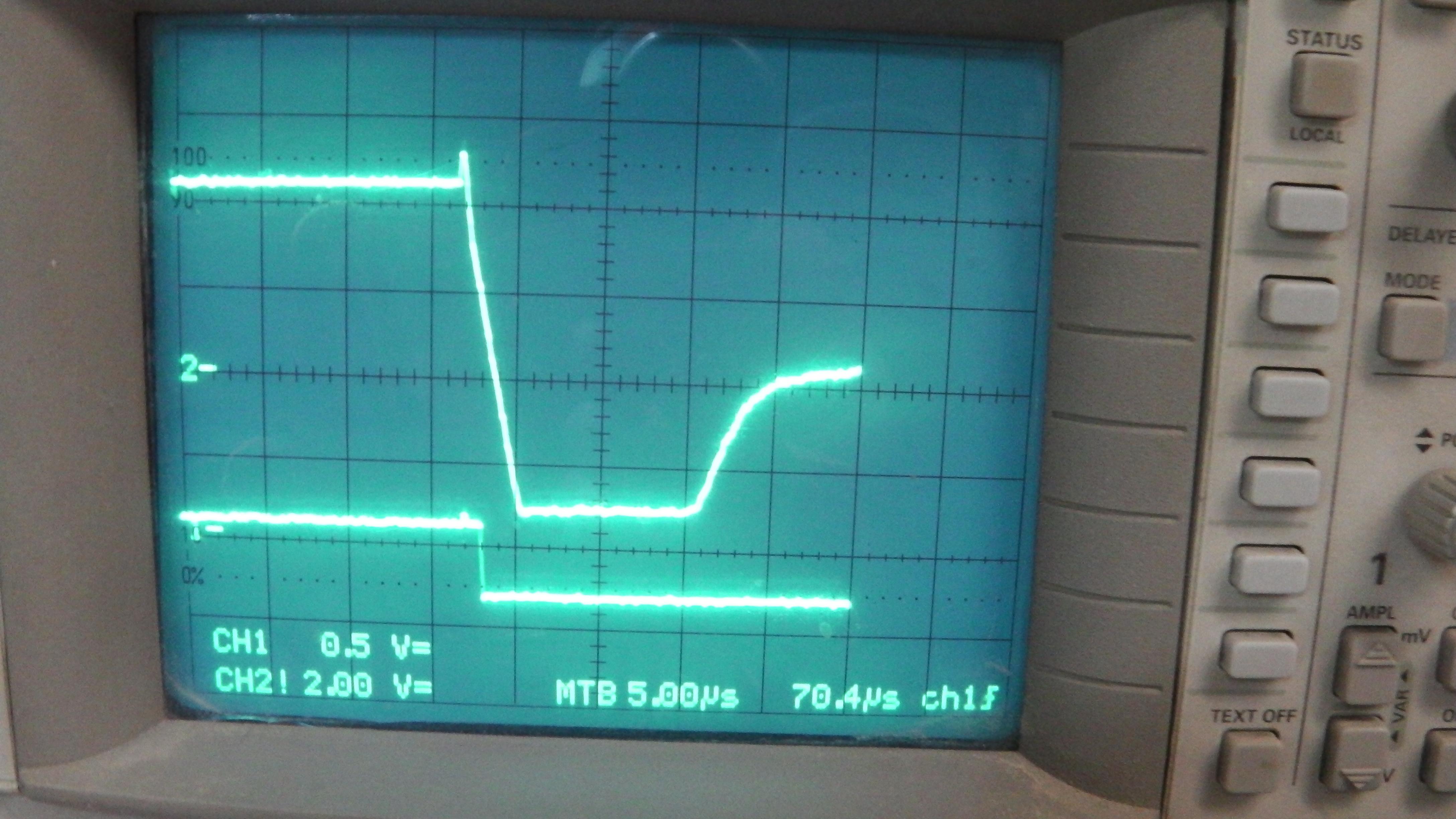

    Testing on the voodoo with a fast coil
    I've had to damp it back to sample properly since the voodoo only goes to 15 us.

      • Originally posted by surfdetector View Post
        So far, I have not had any excessive heat on my project. What wattage resistor are you using?
        Hey surfdetector,
        it was a two watt resistor, I think I figured out what happened at least I hope so.
        Ill figure it out here pretty soon as Im going ahead with the disc portions of the build.
        I had wired my coil like a Mono on the MPP and didn't have the disc portion built so I think somehow I was overloading The R2 resistor.
        strange though I had detection and the coil was damping.

          Out of curiosity what is your damping value?

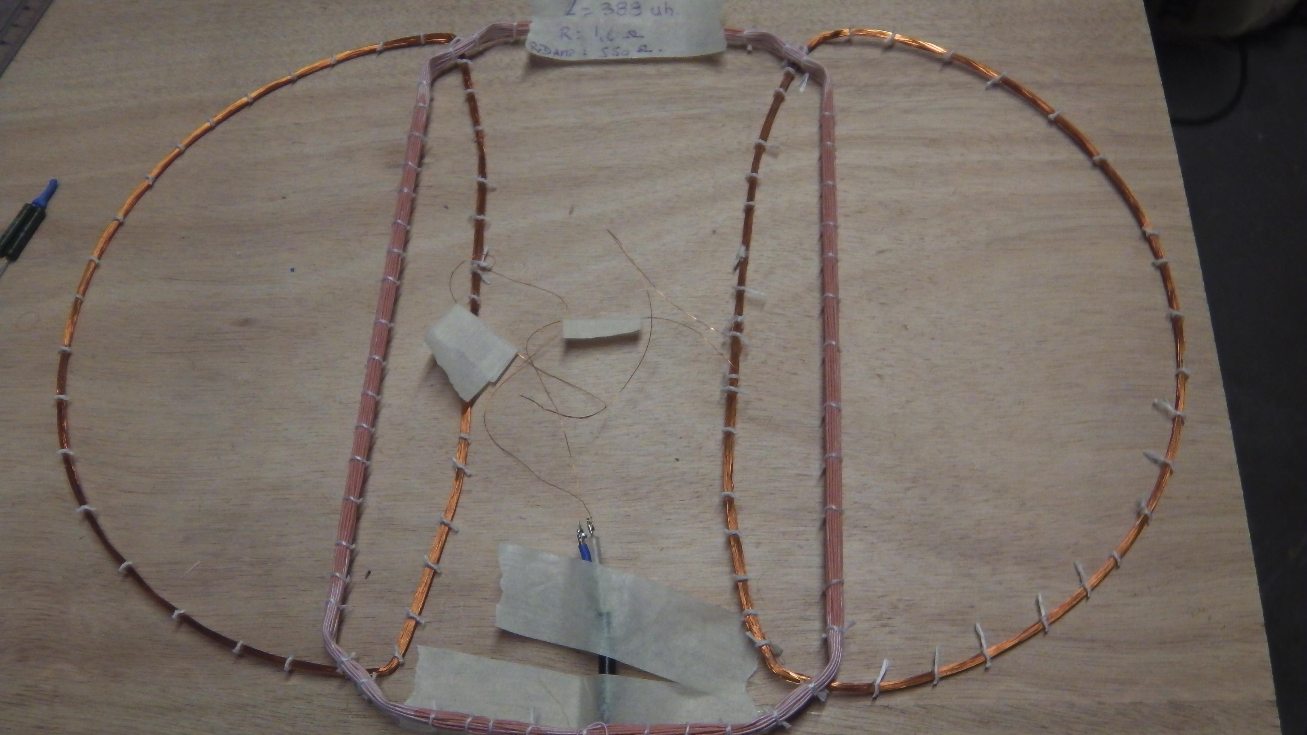

            The coil I've been testing is a dual field with the inner coil shaped like a D and a D Rx coil.
            I've been thinking a little more that the edged detection was reduced by the small size of the Rx D coil.
            At first I was thinking maybe the Tx outer coil may be running blocker but not so sure.
            I'm making two larger Rx d coils to try see what happens.

              hi godigit, I did not have overheating of R2 when I connected my mono, this one has a damping resistance of 401ohm, (390 high tolerance ..) when I had done the test with the potentiometer, the value of 410 ohm would have been the best .. but I had that on hand ..

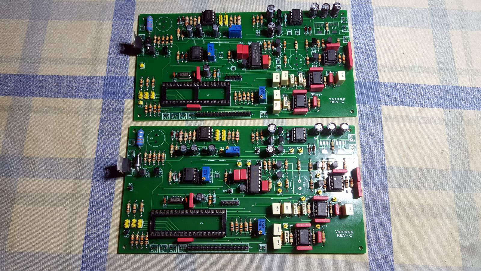

                • Bad luck!
                  Just as i finished all on boards.
                  I learned now that i can not use damn (now useless to me) "Ready for Pic" dev board to program 18F4520 chips.
                  18F45K22 which is on the board originally; is having bootloader, that's why it is accepting flashing.
                  OK, so i tried last option; i put 18F45K22 flashed with Voodoo hex on the pcb.
                  Not working. Seems some functions are working, like sync signal, since LT1054 (had one!) is working alright, providing voltages.
                  But nothing on LCD and when both TL072 are in sockets; 5v from 78L05 drops to 0.3v!!??
                  When i pull out both TL072 and all other chips are on sockets; i get +5.05v alright.
                  When i put back only one TL072; voltage drops to +4.6v. When put back second TL072; drops to 0.3v!
                  Same on both pcbs.
                  When both TL072 pulled out; all the voltages are there. Nothing on LCD.
                  Although all 4 TL072 (2 pcbs) are brand new, yet i tried several other dual opamps there, just to be sure... same behavior.
                  So... my conclusion; since both TL072 are directly tied to mcu, and mcu is not 18F4520 but 18F45K22; some conflict happens and voltage drops.
                  Fortunate situation is that i made 2 pcbs, totally the same. So i can simply rule out any eventual mistake that i made during the soldering process.
                  Since both pcbs behaving the same.
                  Bad luck is that right now i don't have tools to program those two empty 18F4520's.
                  So i'll have to order now PICKIT and wait several days to arrive.
                  Sheeeeesshhhh!

                    I hope you get your voodoo working
                    re programming the 4520, I found something that may help, the 4520 is listed, with you being a arduino wizard it may work for you
                    a bit more info here

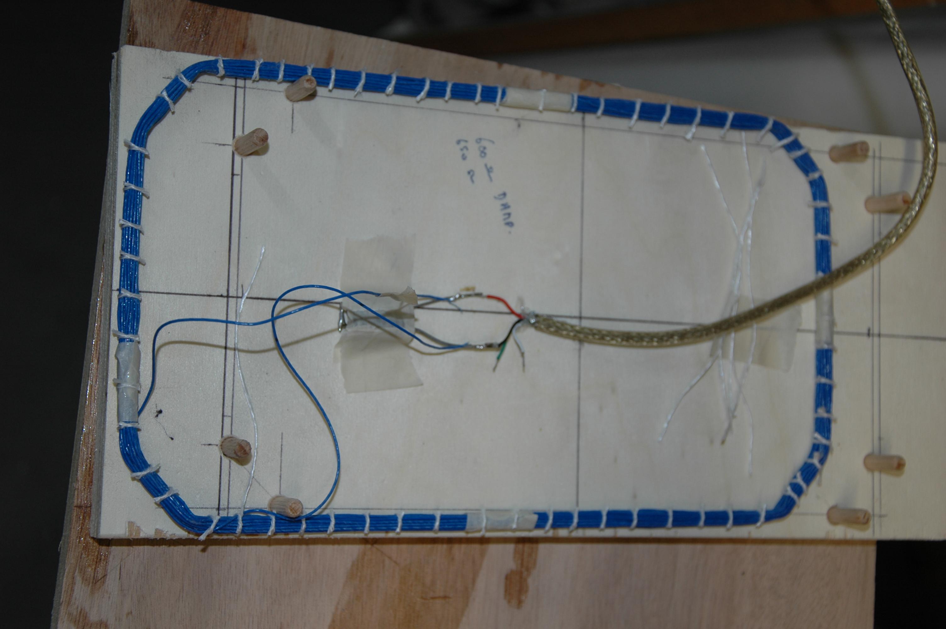

                          • Hi everyone. this week I didn't have much time for the voodoo, but ... I still did the test on a new tx coil, on the super D, the result of all this is that between the wires of silicon and the litz wires, the latter is really good. the litz is faster, the detection distance is much better on smaller targets, so I will take this option for the realization of the final product and do some tests in a real soil!Click image for larger version
ID:	358800Click image for larger version
                            this is the other, in silicon threads.Click image for larger version
ID:	358802Click image for larger version
                            see you.
