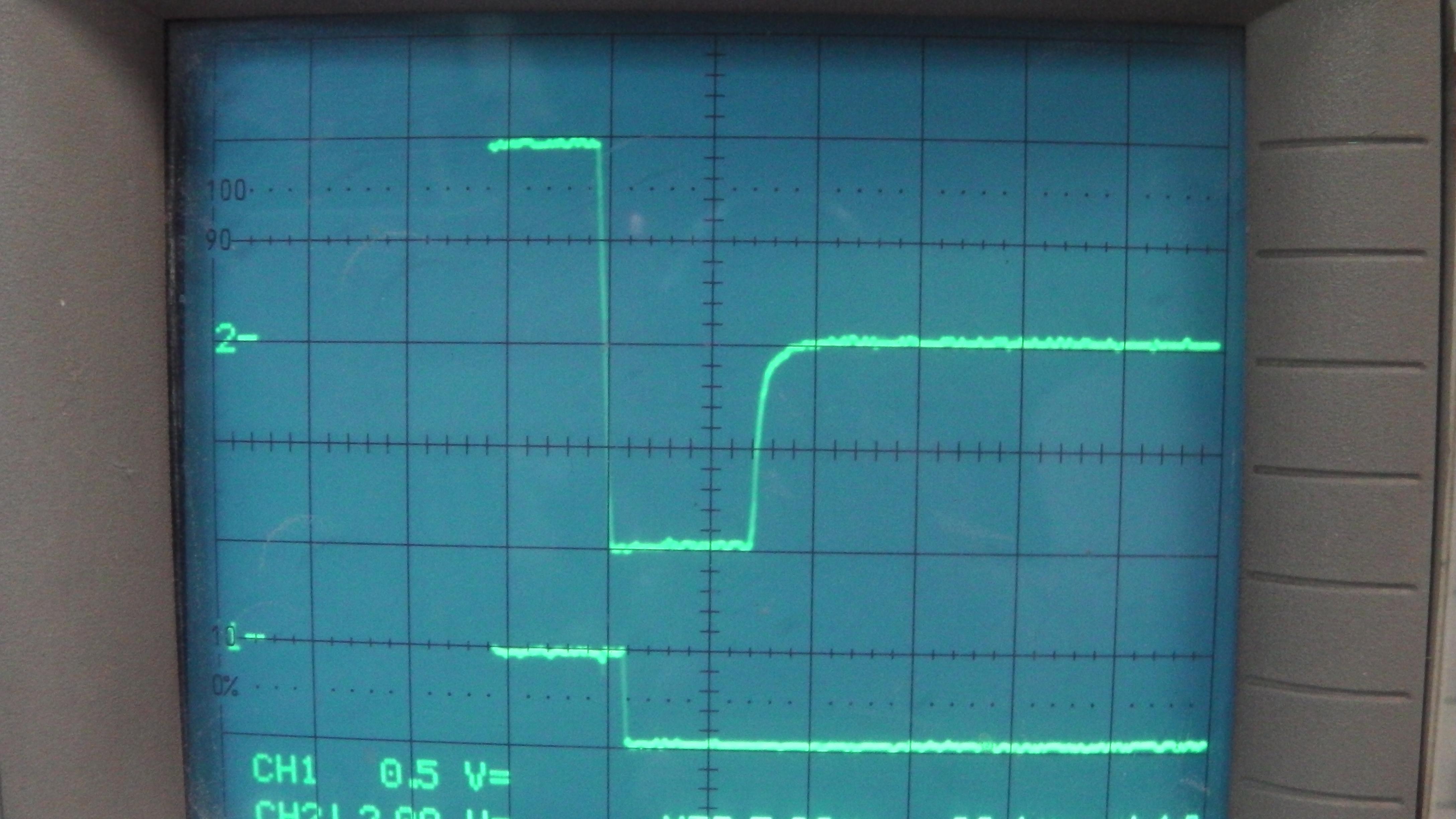

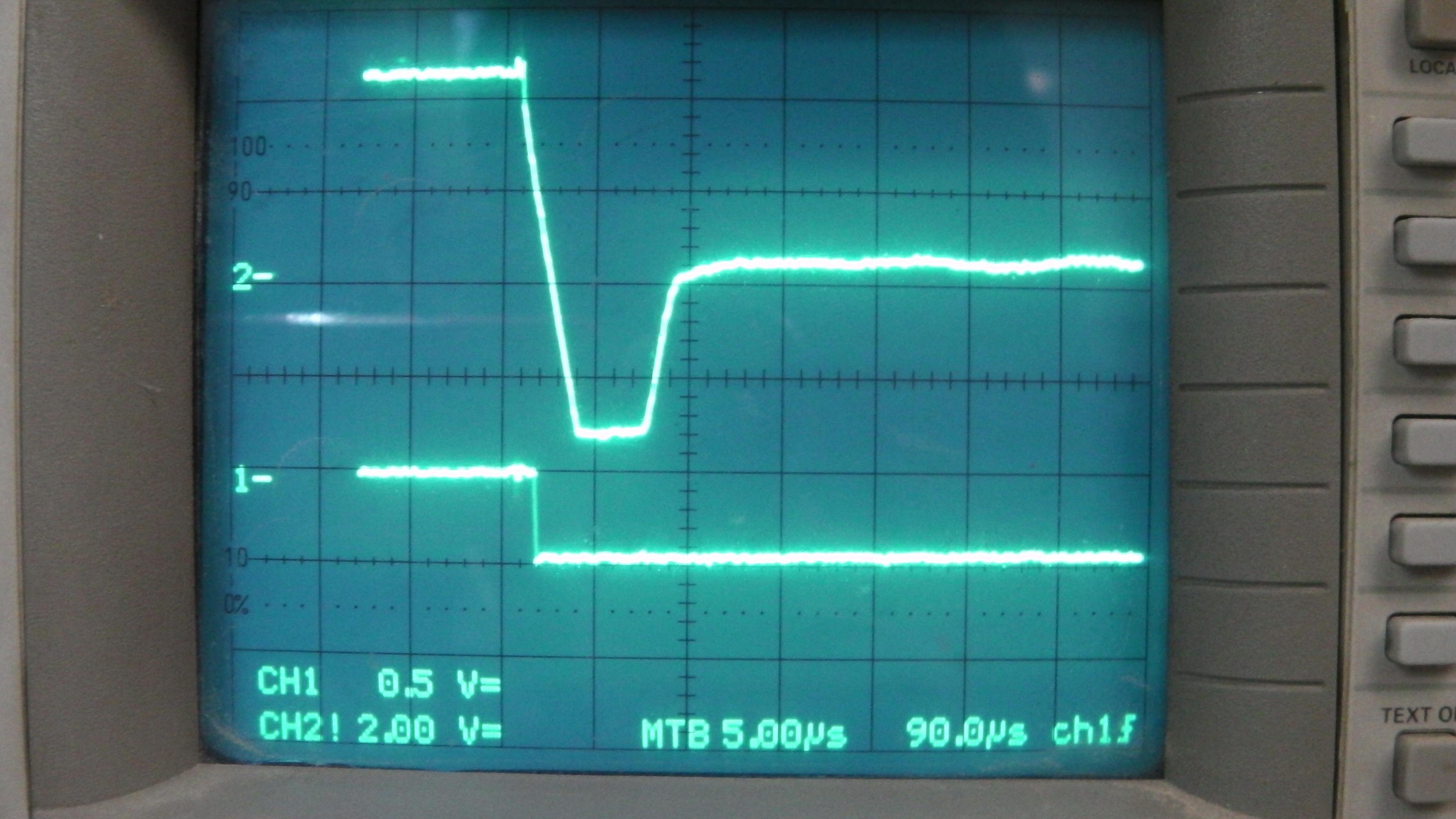

Thank you for posting the wave forms. It is much more interesting than looking at the Datasheets.Originally posted by lamoiz View Postfor info, here is the 5532 and with the same coil and all the same settings the 4562 ... choose your side ...[ATTACH]54032[/ATTACH]5532
[ATTACH]54033[/ATTACH] 4562
see you
Cheers
