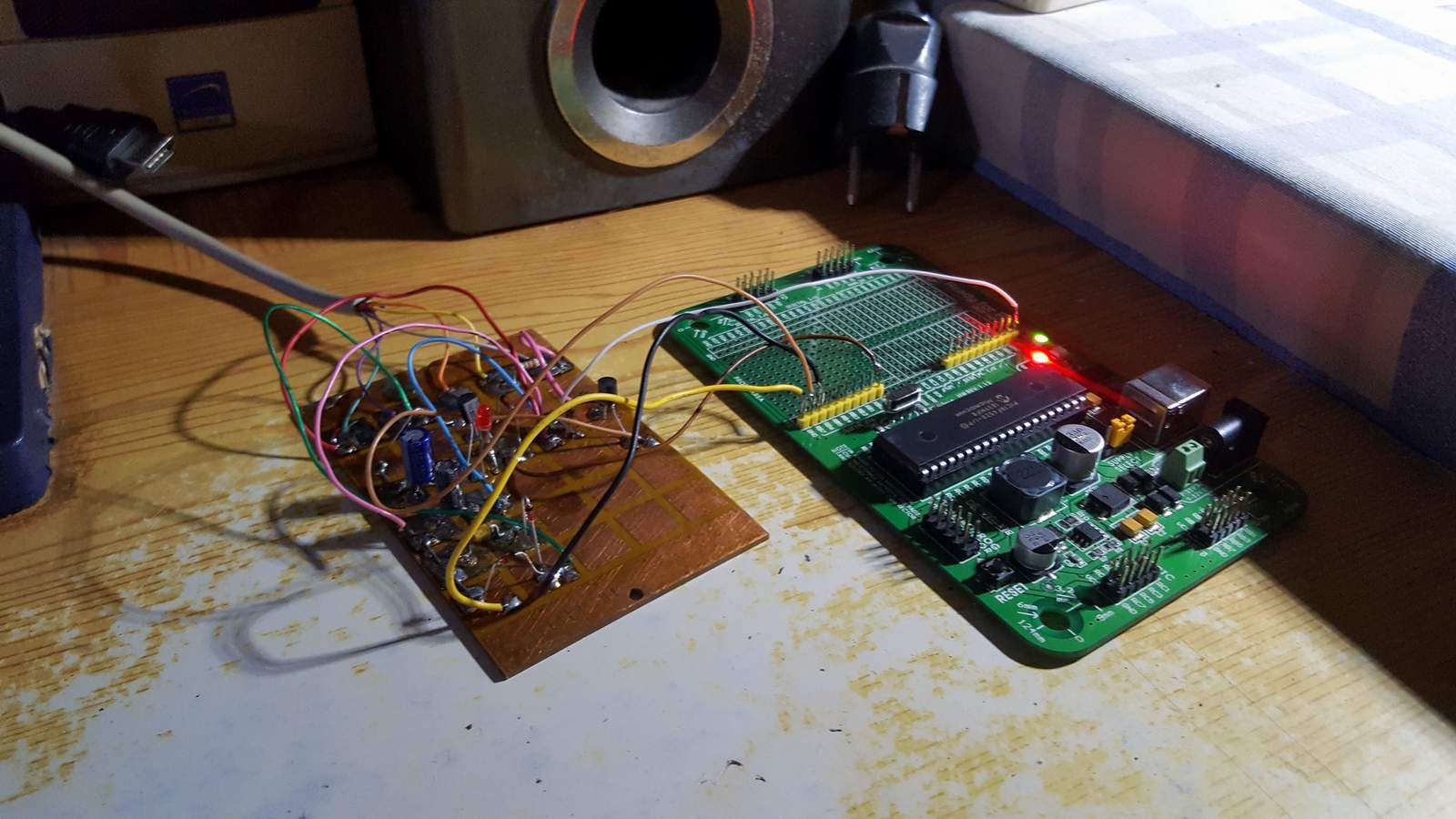

            • Ok, this is interesting!

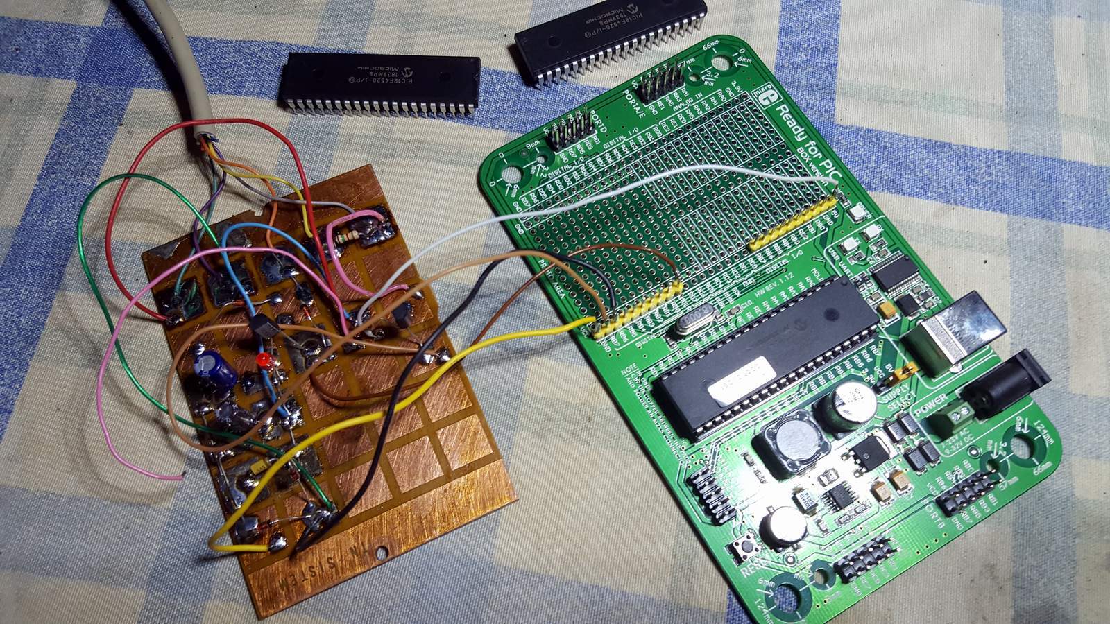

              Since i am restless to see this alive and this is loooong weekend; i decided to give it a try again.

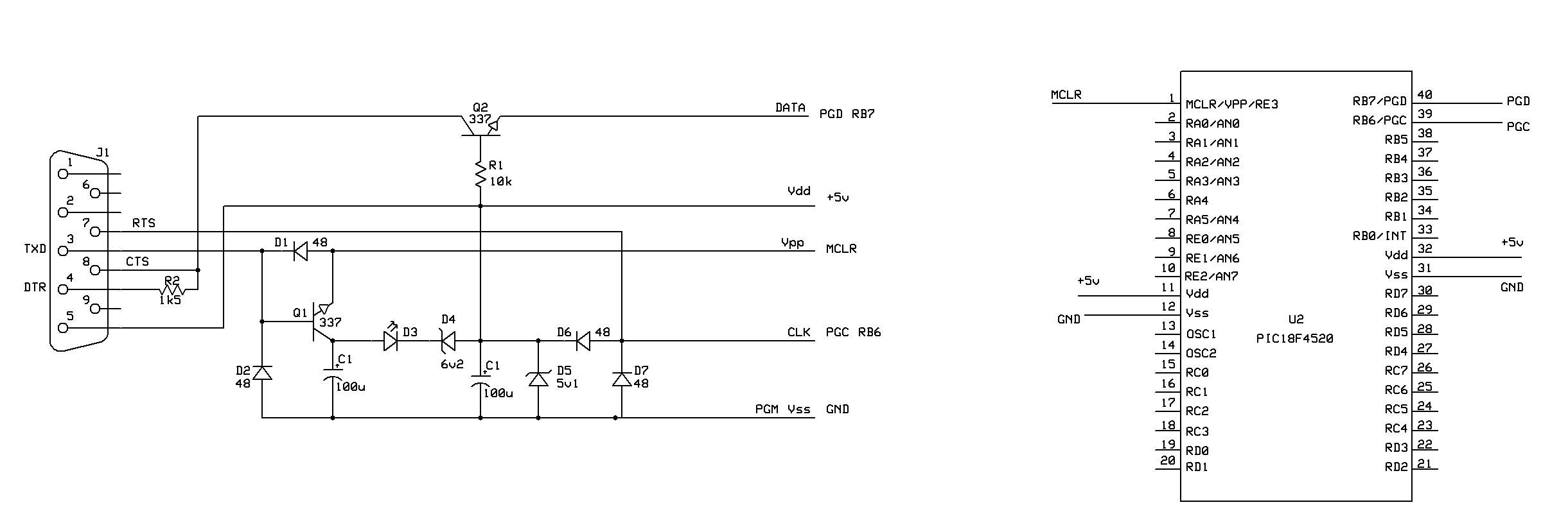

              This time i made simple JDM programmer (state of the art among my works, see the photos).
              I have Dell Optiplex 7010 among other computers. I7, 4th generation, 16GB RAM, 120GB SSD, 1TB WD...
              Overall pretty usable machine.
              But i never really look it's back side, so i didn't know that it has old com port (RS232) !???
              That gave me motivation for this.

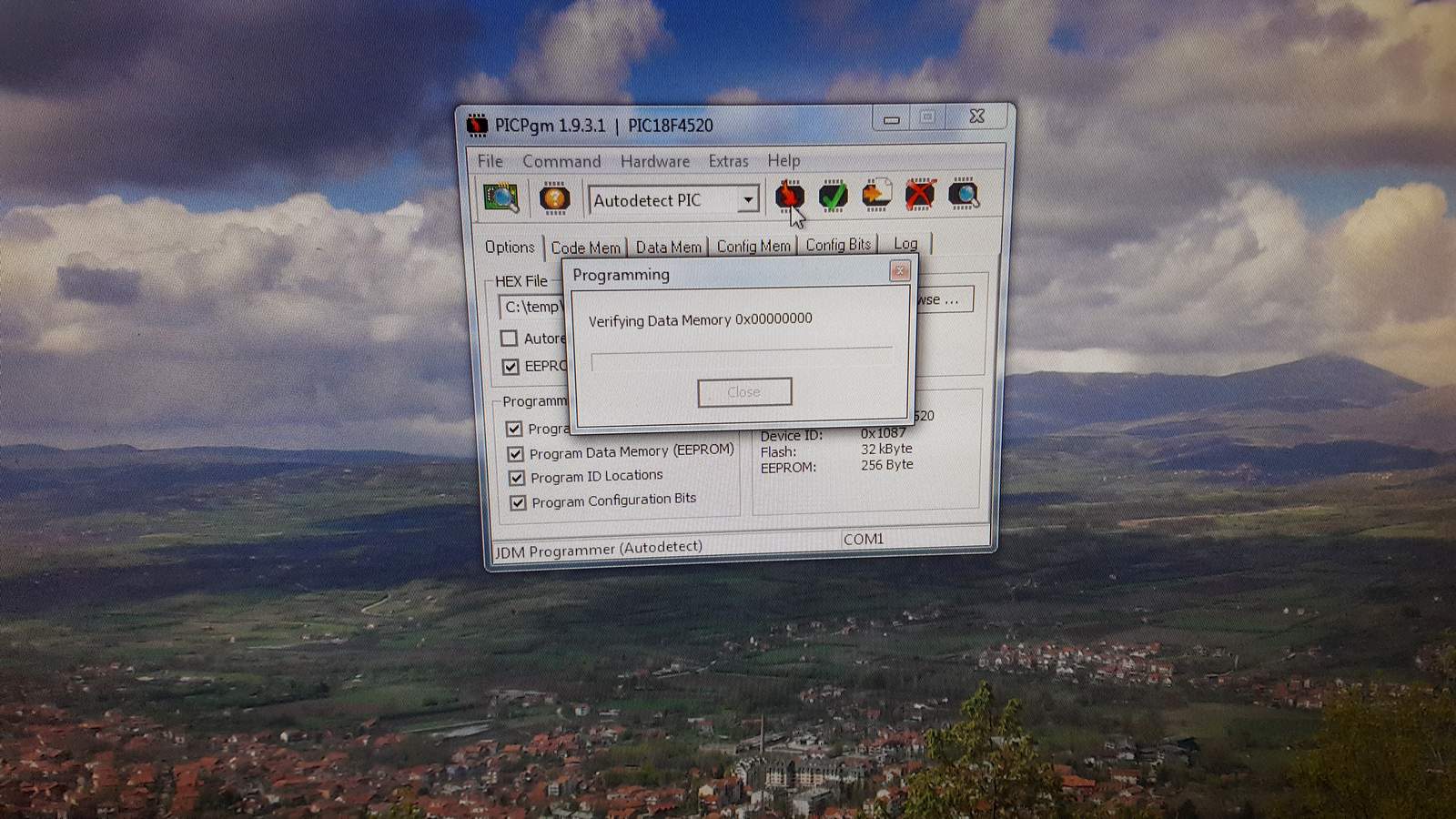

              The other day i spitted hard on PICPgm Programmer software, since it didn't recognize my old parallel port "burner".
              So i made JDM, use several wires to connect it with "Ready for PIC" board, just to use it's DIL socket.
              And gave it a try. Total SUCCESS!
              Now PICPgm Programmer recognizes programmer and chips flawlessly!
              Small notice: i only had to lower the speed (Time Delay Factor) in options, from fast to almost slowest.

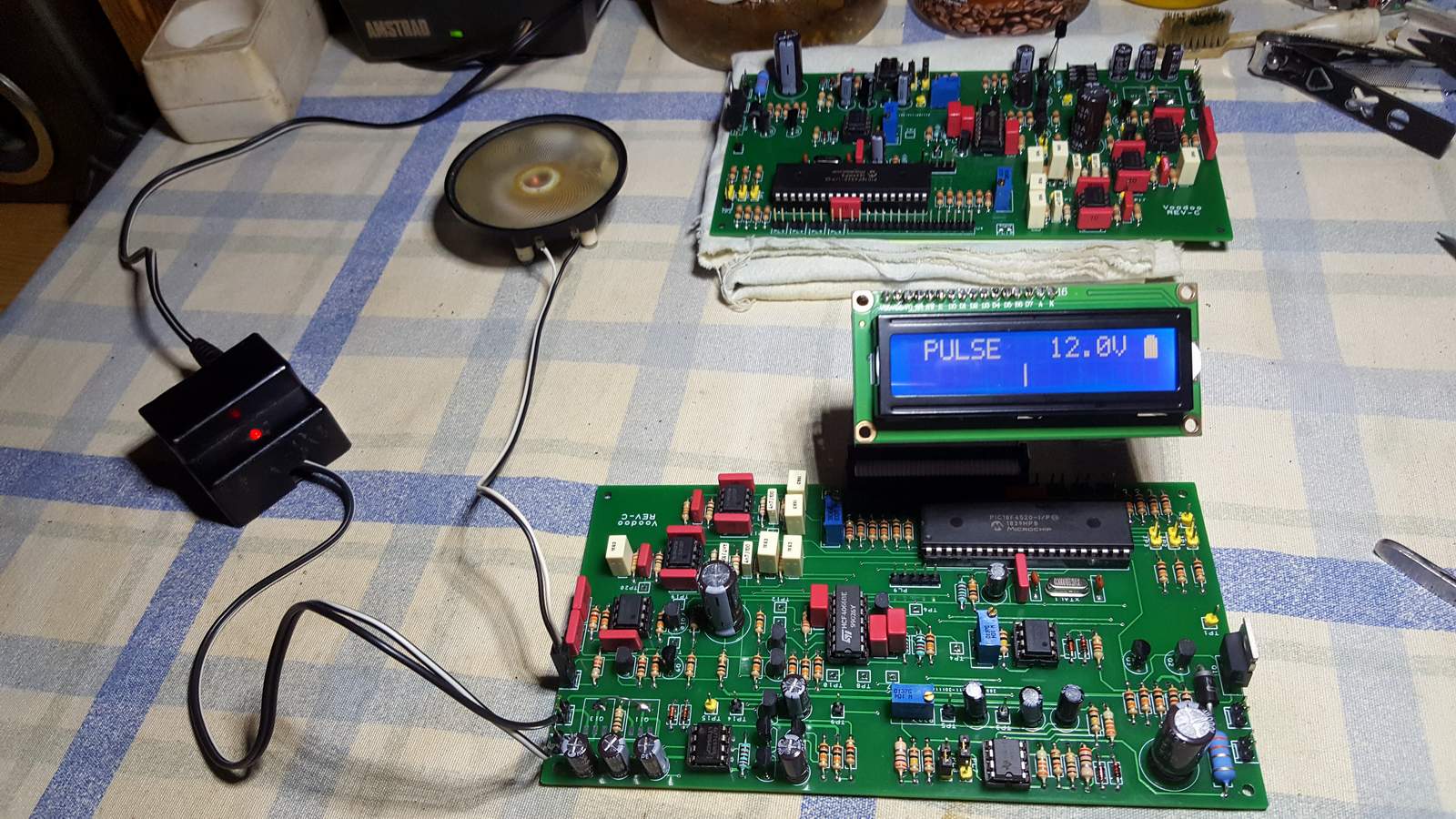

              So i flashed both 18F4520 that i have.
              Than i placed them in dil sockets on two Voodoo pcbs.
              Than i performed series of basic tests. All voltages are correct.
              LCD is now working. Buttons all working.
              Sound is ok.
              All the signals from PIC are ok.
              With scope i see pretty decent flyback.
              But!
              Detection... ZERO!
              So i looked around and i founded out that offset voltage at NE5532 is -1.4v !!!
              And with turning the trimmer to adjust it; it is not changing at all!??
              I scoped from coil across the two diodes at the input; yes i see the PI RX signal alright.
              So i suspected both NE5532. Fortunately i have 4 of those more.
              Not from the same series and same age, those 4 i stripped down from some audio mixer, 100% originals, 100% accurate and high quality.
              So i replaced NE5532... same thing. Can't adjust offset. At both pcbs the same behavior.

                • Ok i solved it.
                  It also may be possible weak point of the design, not sure yet.
                  All the time it was up to 78L05.
                  I tried 3 brand new pieces and all behave the same.
                  Chokes and wont provide +5V. Only at short moments.
                  Trick was that when in Menu; damn thing provides +5v.
                  In operating mode not.
                  At PW 150uS overall power consumption is 150mA.
                  At PW 100uS overall power consumption is 122mA.
                  So i solved it very simple; instead 78L05 i put 7805.
                  And everything works just fine.

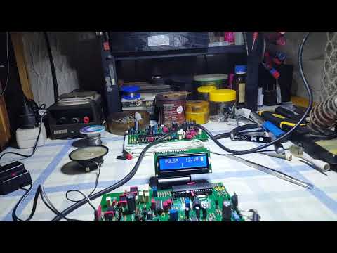

                  • 10 minutes of constant working in Pulse mode.
                    Nothing gets hot, no magic smoke.
                    Haven't tried with PW wider than 150uS.
                    Took one home made coil for IB.
                    0.7mH and 12mH.
                    Skim testing, approx tuning cap (most probably wrong).
                    Not discriminating by now.
                    I'll have to read again the book and search for how to properly adjust R22.
                    Also how to properly trim the tuning cap.
                    What i am missing here is Sensitivity adjustment. In both modes.
                    Without it it will be pretty much useless on real soil.
                    Also it would be nice if it had some kind of visual indication in Pulse mode.
                    Somehow LCD looks stupid indicating nothing in Pulse mode.
                    But that's the part probably very easy to add in code.
                    That's all for this night. I am tired.
