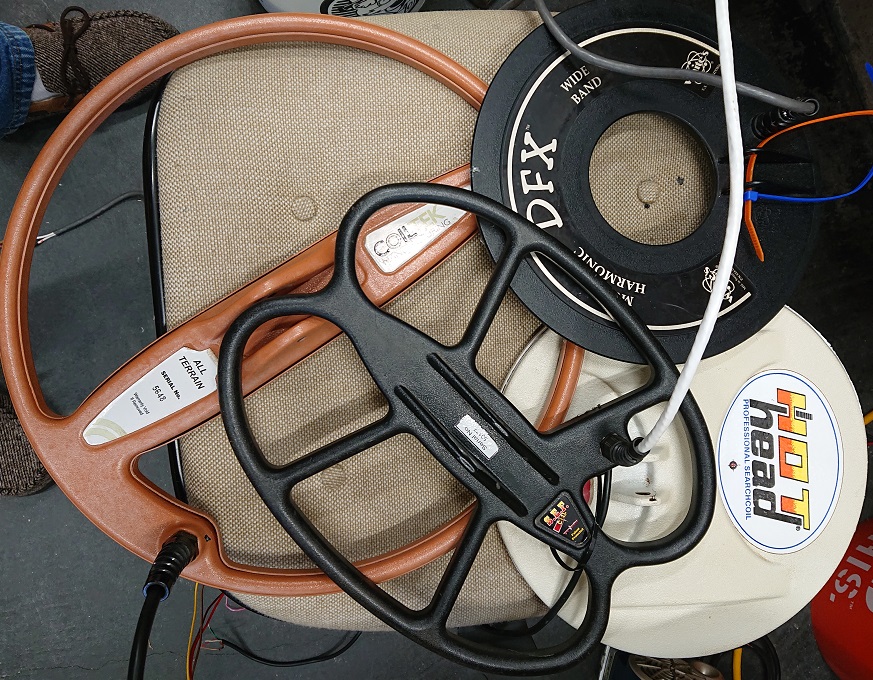

              I am stuck and could use the wisdom of the group. I have 4 different commercial coils, but I am failing at getting even one of them to work well. I can tell the difference between an aluminum plate and a sledge hammer, but that's the best I got. Would some one be willing to write up a "Voodoo search coil setup" walk through?

                • All my coils are used, "as-is", for parts coils. Most of them suffered from a bad cable. One has a bad pre-amp board. I have gotten rather good at lifting out the epoxy and replacing cables.
                  My coils:
                  Whites DXF. This is a well know coil, full specs back in post #1400.
                  HotHead. Unknow detector. Pins 1-3, RX, 472.3K. Pins 1-4, TX, 4.8ohms.
                  Detech S.E.F. Unknow detector. New wire. Pins 1-2, TX, 1.1ohms, 700uH. Pins 3-4, 5.9ohms, 580uH. Has Litz wire on the TX loop.
                  Coiltech. Unknow detector. Had to remove failed pre-amp. Pins 1-2, TX, 2.6ohms. Pins 3-4, RX, 5.9 ohms
                  I have two variables currently. The Voodoo boards build quality. I already found and replaced one counterfeit part. I was a good boy and built it step by step and followed the instructions. But there is only so much I can do with out a proper coil. At the same time I have a bunch of unknow coils. This makes it REALLY hard to track down a problem. I am trying to avoid buying a brand new Fisher F75 coil, as they cost a bit, and I would feel bad about cutting the cable apart.
                  The Whites DFX coil is perhaps the most well known of the lot. I think the Detech S.E.F is the best quality of my collection. I believe both of them are working as expected. Buying the F75 a just copying the configs from the book would work, but I would really like to understand all the tuning and setup. Yes, the book does cover this, to a point.

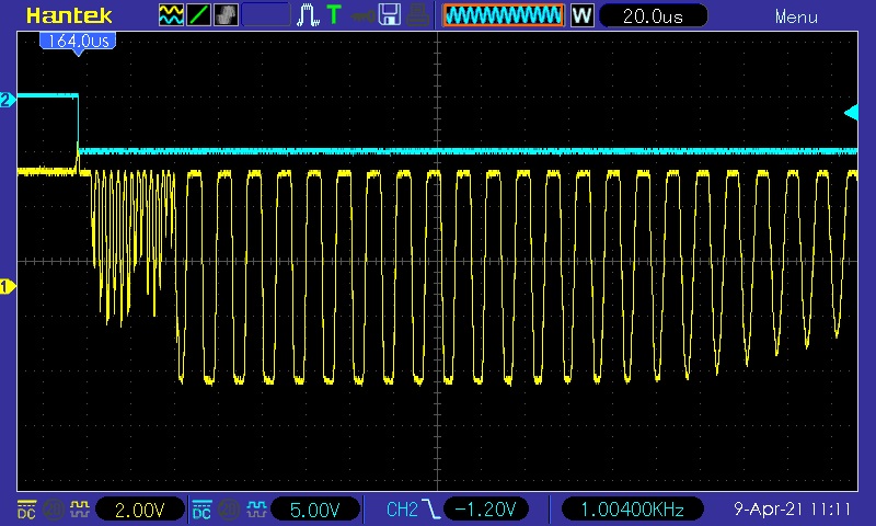

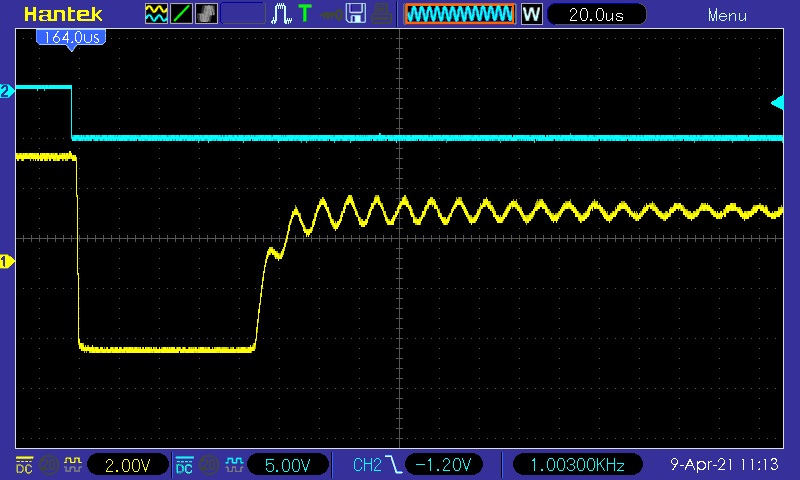

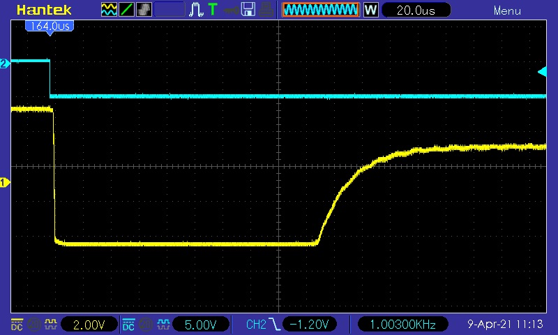

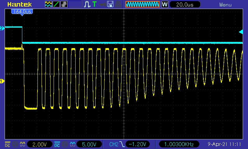

                    • surfdetector, as always, your videos are enlightening. But I cant seem to get anything like what you are showing, unless 190us @ 22.5 ohms is acceptable. Pic's attached.
