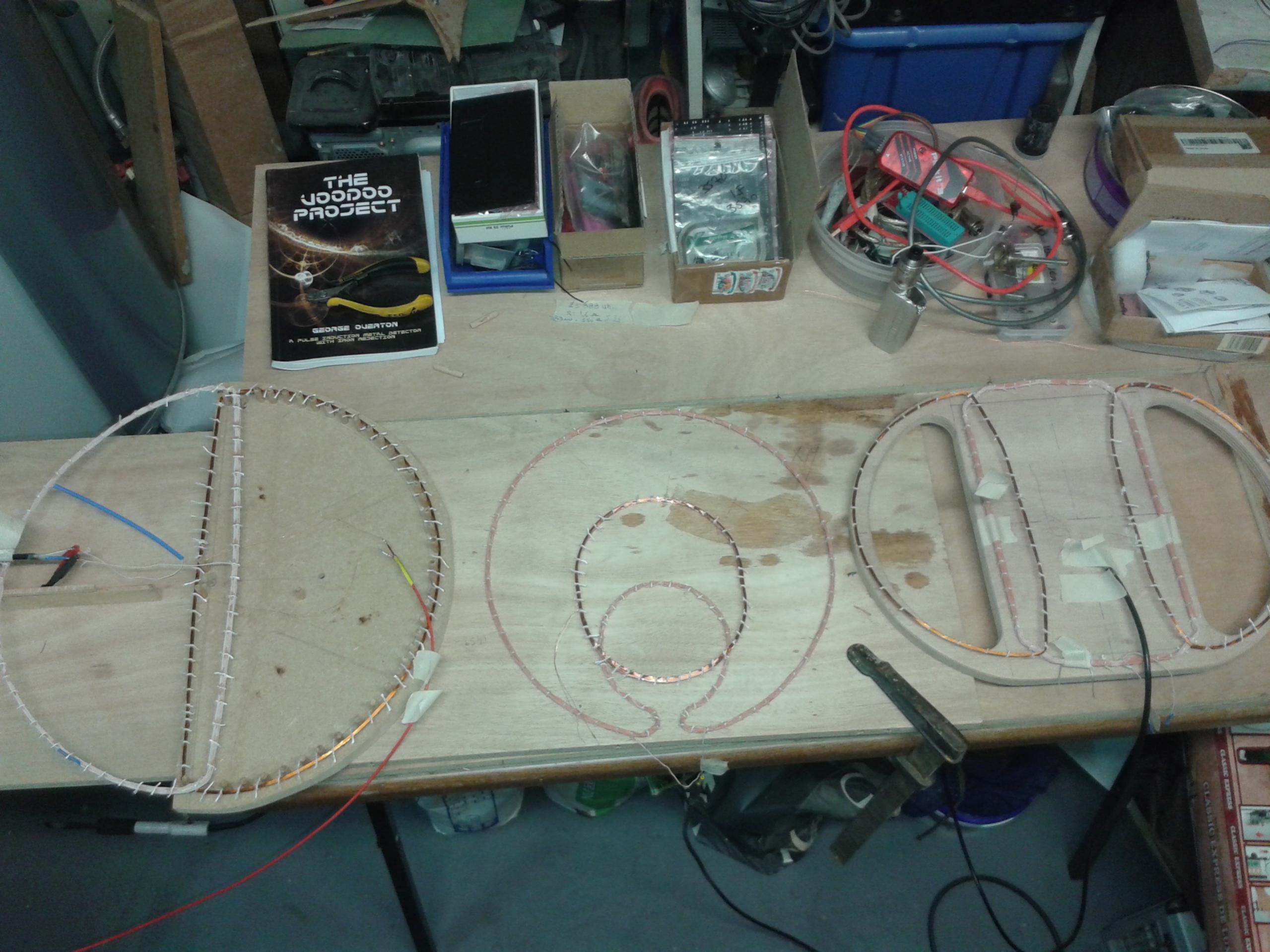

                        • hi, not had a lot of time to work at the moment but, I did work a little bit anyway .. So, question, in your opinion ... who is the winner in the photo ?? I have the answer!Click image for larger version
Name:	3 shapes.jpg
                          for information, all tested with the same capacity of 21.6nf, and make all the same values ​​or almost. the DD tx = 370uh Rd 550r RX = 11.11mh. Omega TX = 355uh Rd = 400r RX 10.96mh, and superD TX 389uh Rd 550r Rx 10.6mh (5.3 + 5.3) the idea of ​​all this is to share the experience and value if one shape is better than another.
                          they are also made with the same wires of Litz 175/46 on the TX and 0.18mm on the RX otherwise it does not make sense ...
                          • Originally posted by lamoiz View Post
                            hi, not had a lot of time to work at the moment but, I did work a little bit anyway .. So, question, in your opinion ... who is the winner in the photo ?? I have the answer![ATTACH]54086[/ATTACH]
                            Probably superD?
                            Can't do what you done because can't obtain litz wire.
                            Omega probably discriminates best but having lowest depths.
                            I tried DD and i am not satisfied.
                            I think the concentric coplanar coil will be the best choice for this detector.
                            Last night i dismantled White's Black Max 950 coil. Bad luck, i destroyed RX coil.
                            It was faulty already, cable breaks and once i opened it; i founded out that those two copper "rails" are also broken.
                            So it is not that much of a lost as it would be with some new coil.
                            But the way how White's coil was fine balanced with bucking coil and one lose turn over; makes me wonder about its usability in this project.
                            Since TX coil is in matter; bucking coil and lose turn will present a problem for PI TX.
                            Qiaozhi has positive experience with Troy coil, but that coil is fine balanced the same way as White's, having bucking coil and probably one or few lose turns over.
                            It will work alright in mixed mode as IB... but it shouldn't work alright in PI mode... at all.
                            Along with bucking coil it is closest to "8" coil type. I saw several previous attempts with such designs and i haven't see much of a performances so far.
                            This project needs its own coil design.
                            So you are closest to it with your attempts.
                            Would be interesting to see inner morphology of TDI coils...
