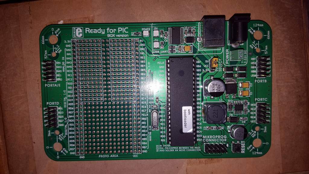

                    I am having this, would it be compatible?
                    https://www.mikroe.com/ready-pic
                    • #70
                      [ATTACH]53487[/ATTACH]
                      That board contains an 18F45K22. You could either replace the PIC with an 18F4520, or recompile the source code.
                      Note that Voodoo uses a 20MHz crystal, whereas the "Ready for PIC" board is wired for 8MHz.
                      Also, you would not be able to fit the rest of the circuitry into the proto area.
                            No, i was thinking only to use this for flashing the hex code into mcu.
                            Later on to take out mcu from it and put in on detector pcb.
                            I was hoping that 18F45K22 and 18F4520 are compatible.
                            MikroE is domestic company. But is hard to get anything free from them, except the mikroBootloader.
                            I just try it, to remind myself, since i haven't been using this for long time.
                            With mikroBootloader seems that i can flash any hex into chip.
                            I am looking over the net for some free compiler to experiment further with this board and see what else i can do with it.
                            So you think that 18F45K22 and 18F4520 are not fully compatible?

                                George read this:
                                https://www.microchip.com/forums/m507358.aspx
                                Tell me if you can apply these changes into your setup and compile the same code for 18F45K22, since seems those are practically the same chips.
                                That's how you will also provide more options and wider choice of mcu, for your project.
