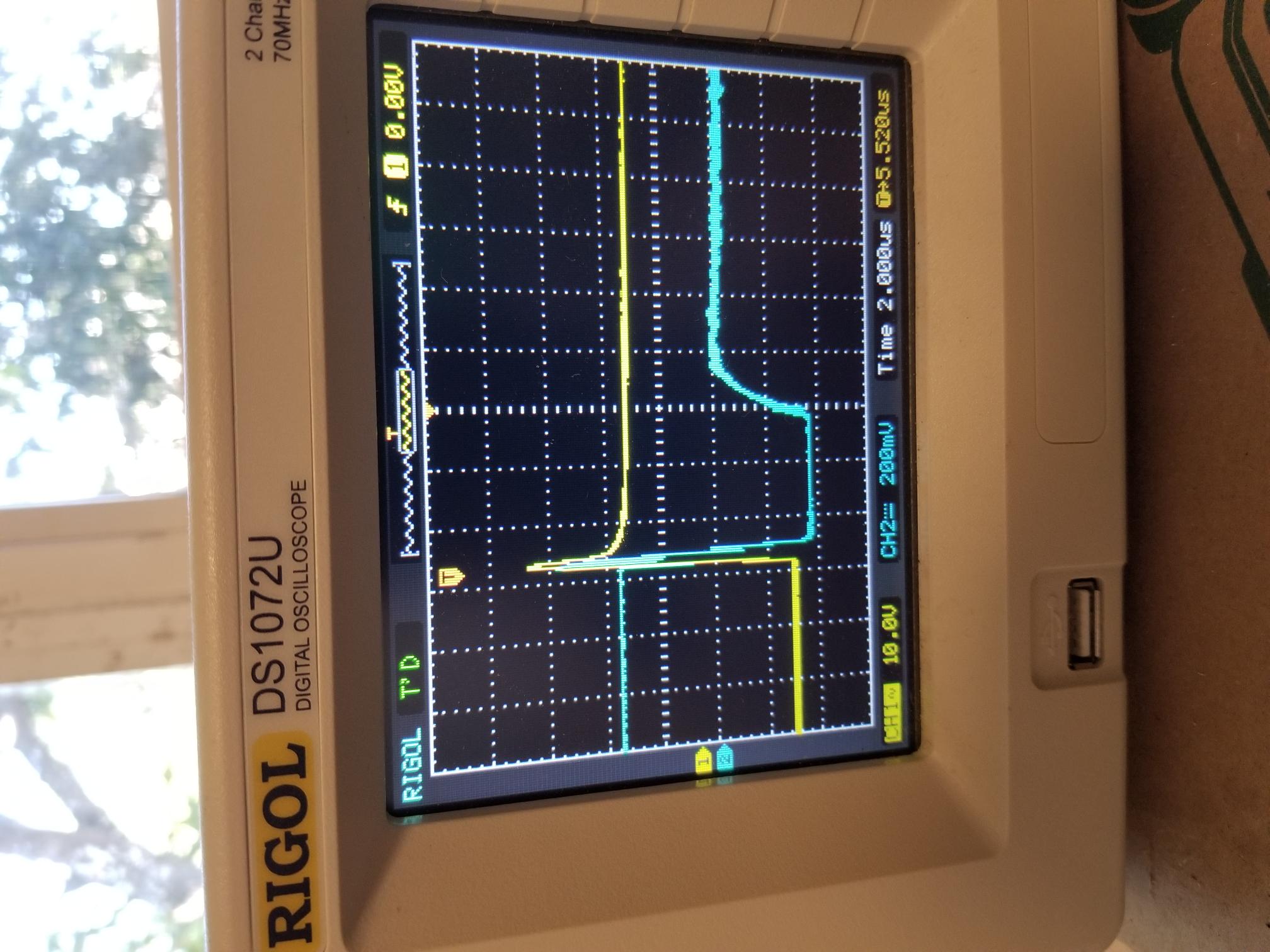

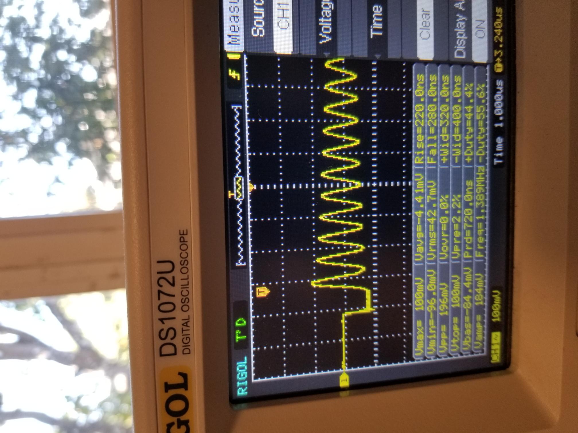

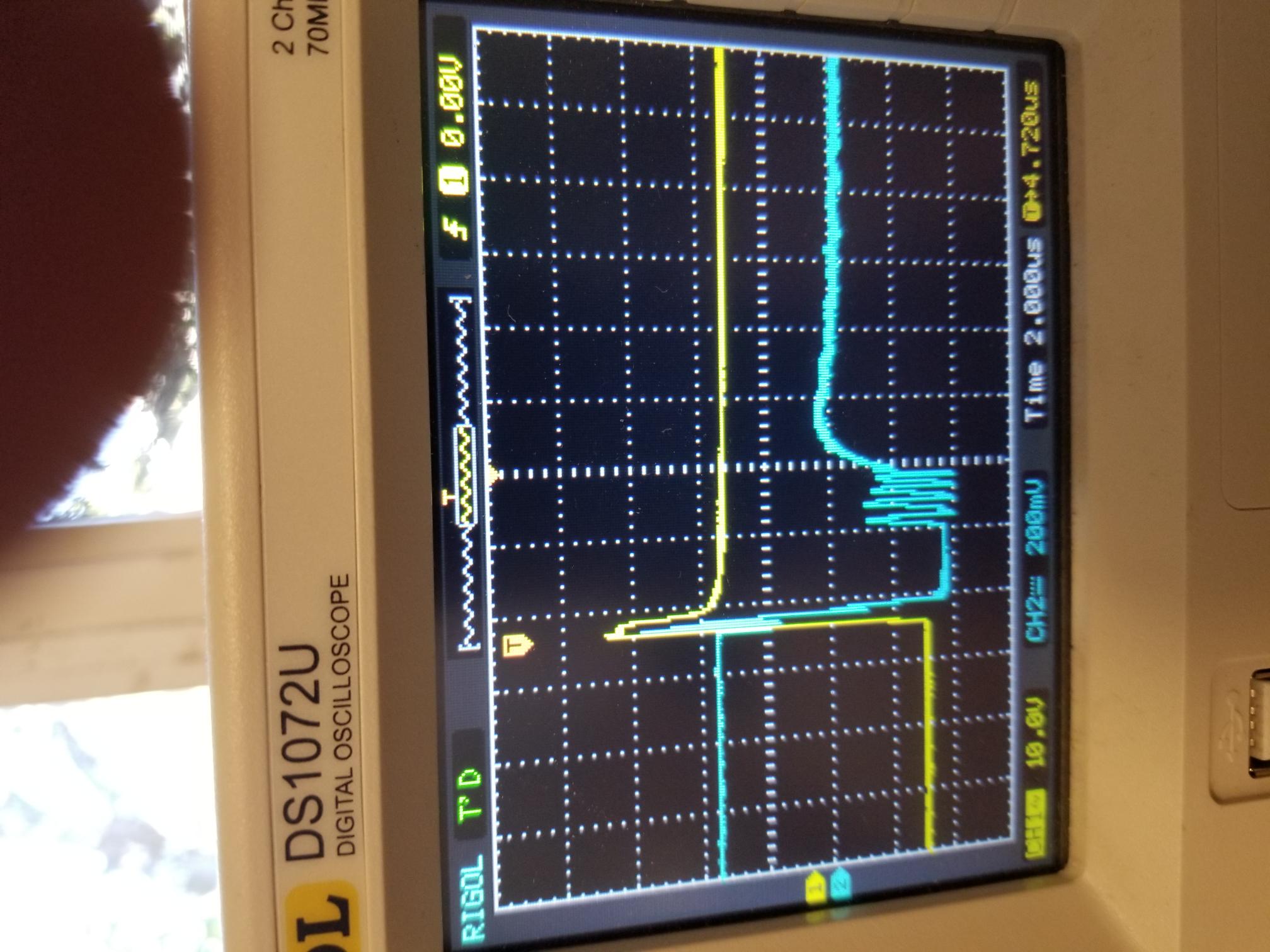

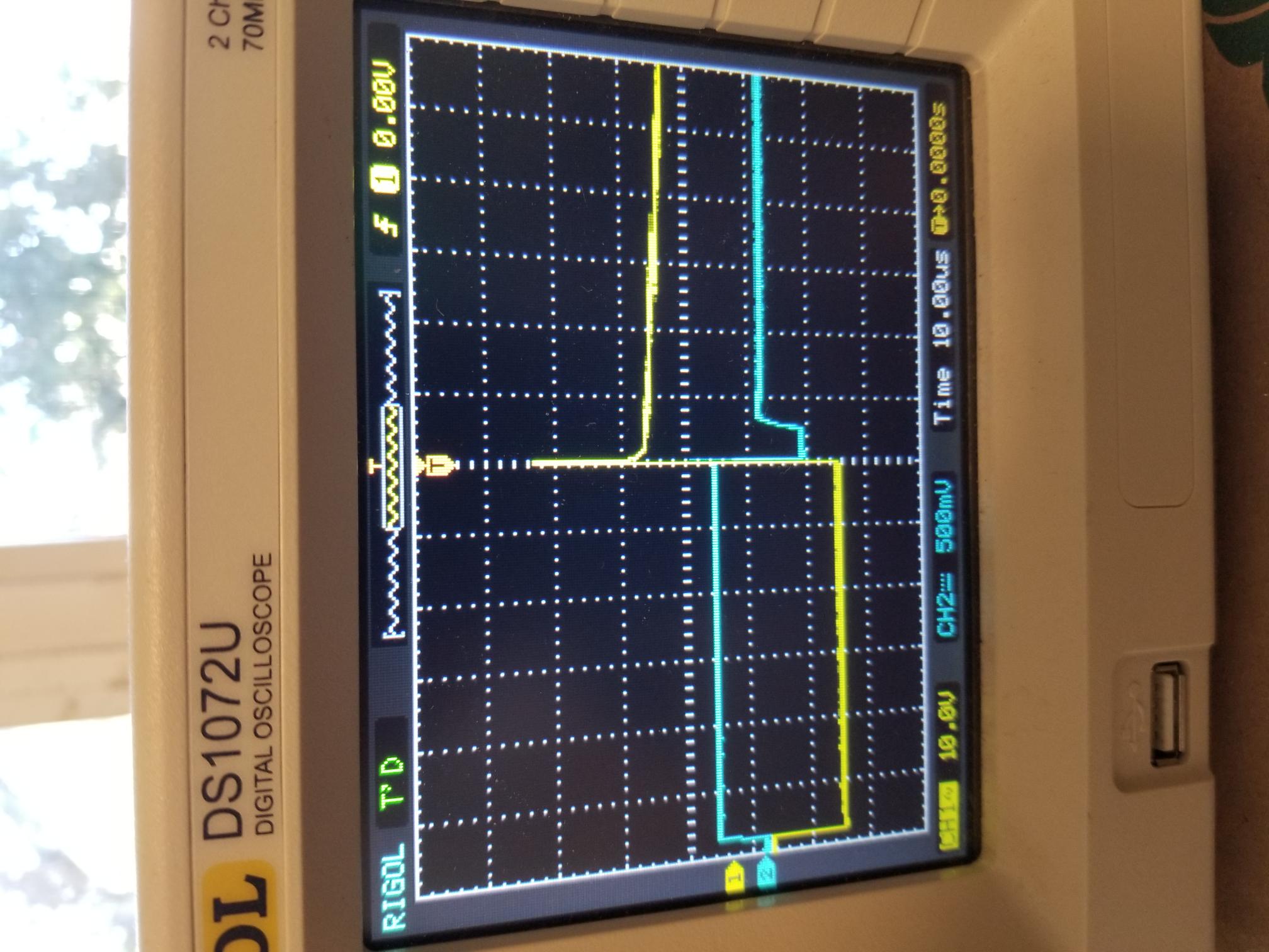

Hi Green,
I had a chance to do the srf test with the input resistor removed. You were right about the input resistor acting like a damping resistor. It heats up pretty fast with no damping resistor installed.
I unhooked the Input on one side and made a loop with the probe end and I get the exact same srf as I do pulsing with a live coil. The only differance is the voltage on the coil, the SRF is constant both ways. But it was good to find out this coil will still operate without a damping resistor. Coil is hitting a nickle both damped and undamped first sign at 14 inches hard by 12 its a 7" od coil not too shabby so far.
This is the SRF with the probe not touching the coil just held close.
This is the coil Undamped before I cut the input resistor.
This is the coil Damped at 2.47k measured from the fet gate.
