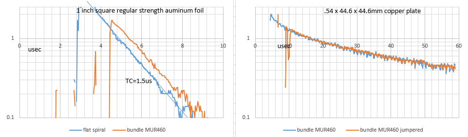

    An attempt at comparing a bundle wound coil vs a spiral wound coil I have with spice. Added 50pf to coil capacitance for lead wire. First compared coils as wound, bundle coil has higher inductance but less current. Second changed bundle coil to 23turns for same inductance as spiral coil. Higher current because of lower resistance. Don't see much difference with nickel or quarter. SRF higher than expected with the bundle coil so simulated with D1 shorted and not shorted. Spiral coil seems to be better with nugget with 1us TC. Wondering if I'm missing something with my simulation?
    Edited, I'm guessing that the spiral coil should perform better than the bundle coil at higher PRF.
      I am not spice savvey but Im wondering can you change the inductance of the spiral both higher and lower to see if the 1 tc target improves.
      Thinking 200 uh might be a good value for a dd Rx.
      Thanks Agian.
      Haven't replied because not sure my spice model is correct. Guessing changing DD Rx from 300uH t0 200uH wouldn't improve signal strength unless could sample sooner. 1us target looses 90% of signal every 2.3us, sampling 1us sooner would help.
        Couple tests with spiral and bundle coil reply #26. Some thoughts, maybe correct maybe not. Spiral coil is best wound with zero spacing between wraps. (1.5 inch foil target)bundle coil has higher signal at same delay time because of higher inductance for same number of turns. Spiral coil has higher circuit resonance allowing less delay, higher signal if sampled sooner. Bundle wound with Teflon coating wound have higher circuit resonance, thicker insulation calculates inductance similar to spiral coil. Thinking magnet wire spiral coil would be similar to Teflon bundle coil. (copper plate target)shows increase in needed delay if MUR460 is eliminated, less than 5us with and little over 10us without. Signal same with and without MUR460 because Tx current is in a control loop(160us, constant rate, 1A peak). Two stage amplifier, gain of 15/stage for total of 225. Still wondering why professional coil might be better? Spice simulation seems to be similar to comparison test.
        Used 1inch foil target(TC=1.5us) instead of 16mm square foil(TC=1us)spice model to get a higher signal for testing. Square target cut from regular strength aluminum foil(.063us TC/mm)*number of layers. About 16mm for 1us target. Square target cut from aluminum coke can side(.225us TC/mm). About 4.5mm for 1us target.

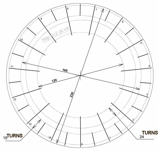

          thanks for your tests green, i have started winding a basket coil for testing, the flat spiral that was in the photo earlier in the thread did not have a big enough hole in the centre(thanks carl and 6666), once i unwound some of it and wound those turns on the outside of the coil i got usable inductance and ohm readings.
          does anyone have an english coil build guide for the chance type basket coil?, i found one in russian and a few scraps nothing definitive.

              This one ?Click image for larger version

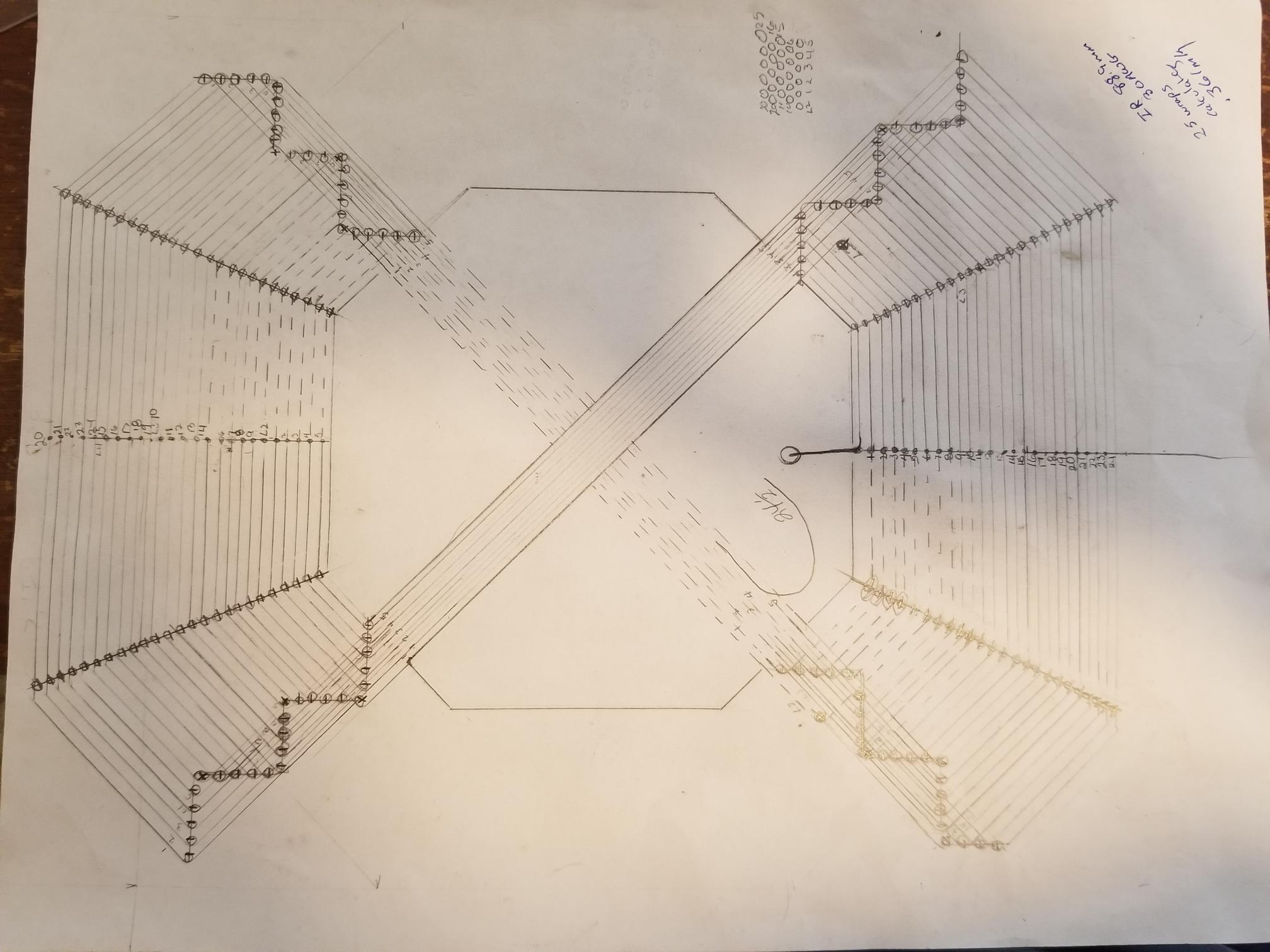

                        This coil im winding is kinda a bear Im on my second form and just redrew a new pattern last night. Now Im thinking a complete redesign is in order before I actually build.
                        one of the layouts to give you a idea of what im talking about.Click image for larger version

                        I have been thinking as you said the single wire magnet wire spiral coil could be very fast but also thinking a small # of strands bundled to reduce resistance. Ie 3 to 4 strands 30 or 32 awg. Just enough to take of the full benefit of bundling the wire .
                        #30 awg
                        1 strand .338557 Ohm /m
                        2 - .16928
                        3- .11285
                        4- .084646 = comparable 24 awg
                        5- .067706
                        6- .056425
                        7-. .04836
                        8- .04325
                        After the 4th strand the major benefit to reduction of resistance per strand falls off compared to gain in wire diameter for the 30 awg wire.
                        A estimated coil of 300uh single strand 30 awg aprox 50 feet of wire = 5.15ohms
                        A 4 wire bundle the same length =1.29 ohms
                        8 wire =.659
                        So that being said where do we loose the benefit of resistance reduction to the larger diameter wire and skin effect?
                        A coilteck joey dd has
                        498uh tx with 5.4 ohms
                        And a 285uh rx with .4 ohms.
                        this coil is not a litz wire coil at least i dont think so. so It looks like the wire diameter would have to be somewhere around 20 awg to get that value resistance. Im sure its bundle wound.
                        Thanks Again
