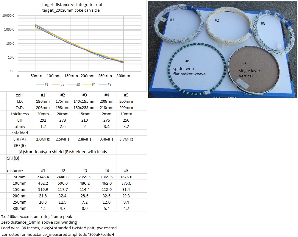

                      To actually answer your question. I use all profesional coils on my detectors.
                      Ive been able to make nothing that will beat them yet. Ive had some pretty good ones but no winners. On my kt315 1st edition baracuda the yellow coil you tested was very good.
                      I now think that it was a accidental match to that detector ,got something right.
                      Also this is off topic a bit but that baracuda is really partial to the type of diode used.
                      That coil with a high intensity green led performed right up there depth wise with my MPP and a 12 inch dual field. Ive yet to remake it but have been saving that spool of wire.
                      Wondering if the reason the professional coil is better is measurable. Have you compared diameter, inductance, resistance and SRF with your coils? Maybe some other measurements? Another possibility, professional coil has less noise for some reason? Are you testing with a short or long TC target? Test I did awhile back with some of the coils you sent me. Your coil is better at close distances than my spiral coil, smaller diameter is some of it. Still looks like your winding might be a little better for some reason. Zapped my test circuit with integrator awhile back or I would try testing again to see if I missed something.

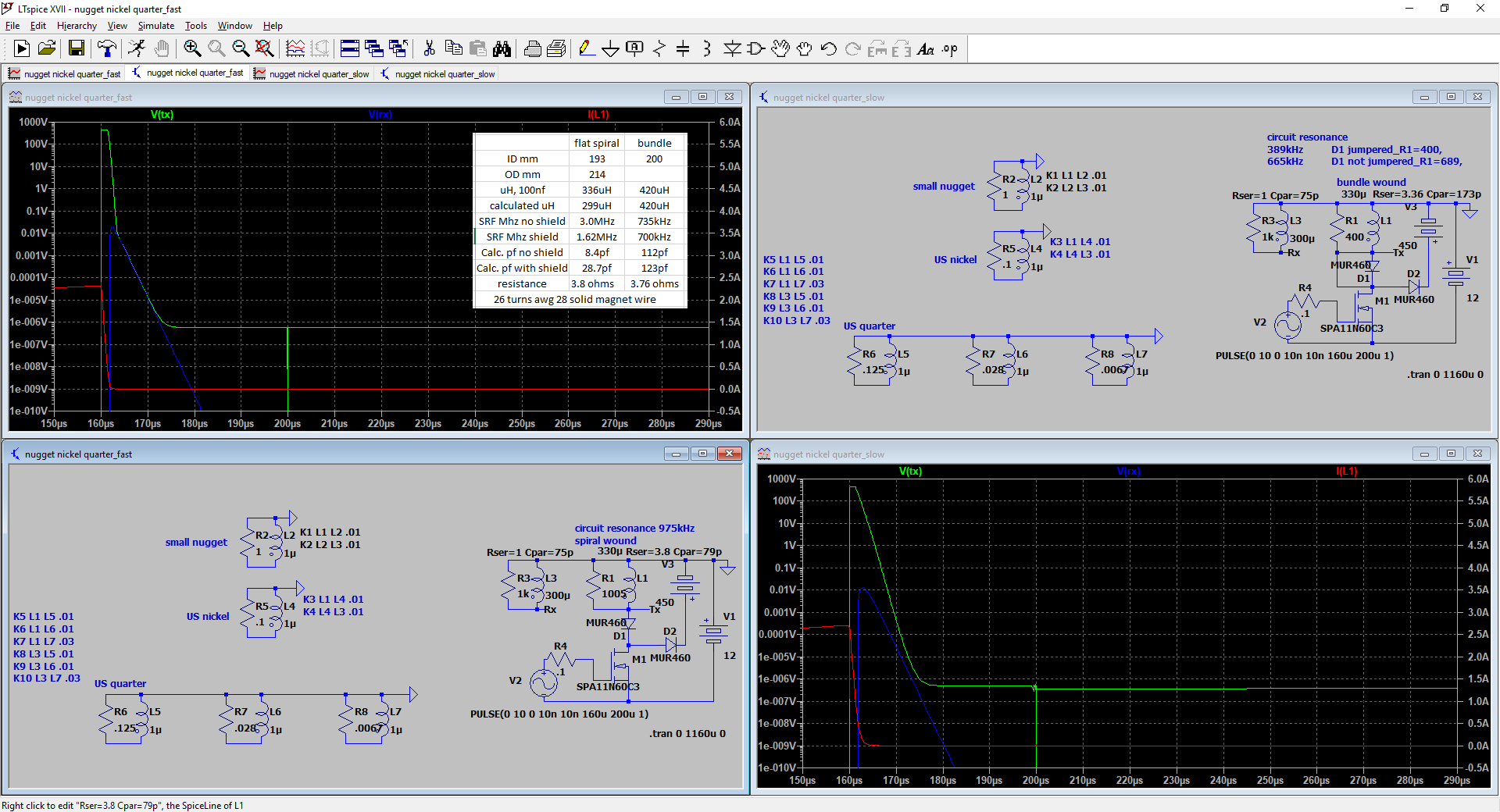

                        An attempt at comparing a bundle wound coil vs a spiral wound coil I have with spice. Added 50pf to coil capacitance for lead wire. First compared coils as wound, bundle coil has higher inductance but less current. Second changed bundle coil to 23turns for same inductance as spiral coil. Higher current because of lower resistance. Don't see much difference with nickel or quarter. SRF higher than expected with the bundle coil so simulated with D1 shorted and not shorted. Spiral coil seems to be better with nugget with 1us TC. Wondering if I'm missing something with my simulation?

                          You are right about the pro coils I need to revisit them and properly test them . All these coils are shielded and really good coils in my opinion, Whites coiltek Digger john jimmy sierra coils. Thant being said its no suprise I have not made a better coil as of yet.
                          Im was mainly comparing by target performance.
                          My low tc targets were the 1/4 square of cola can and a 1.2 gram nugget.
                          As far as retesting the coils I think you nailed it the first time.
                          Coils 2 and 4 are a pretty good wash as far as performance to size I think.
                          Coil 3 is way off the make as far as inductance I wonder if I made that one properly if it would do better.
                          Its the same stack as the others just flat instead of verticle.
                              I am not spice savvey but Im wondering can you change the inductance of the spiral both higher and lower to see if the 1 tc target improves.
                              Thinking 200 uh might be a good value for a dd Rx.
