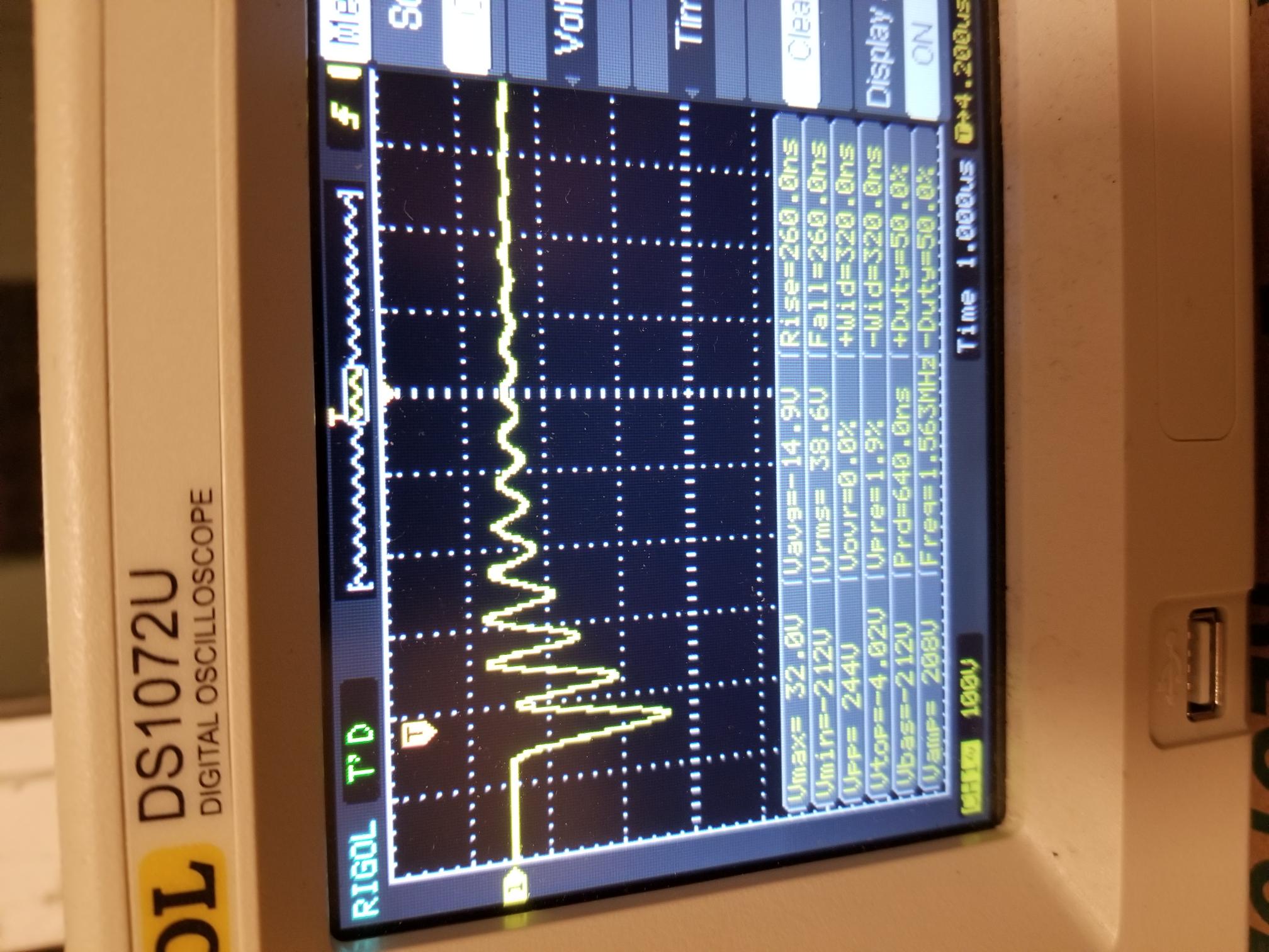

    On SRF and sampling if I may ask?
    If you have a SRF wave form that is completly clear of the coil in less than 10us could you sample that coil at ten Us without a damping resistor as the SRF oscillation is gone before first sample?
    Here is a wave form of one of the spirals Ive wound. pretty much clear at 5us
    This coil is 30 awg
    no space 308Uh coil.
    5.2 ohms
    26 wraps.
    33.664 Pf with 30 ince leads.

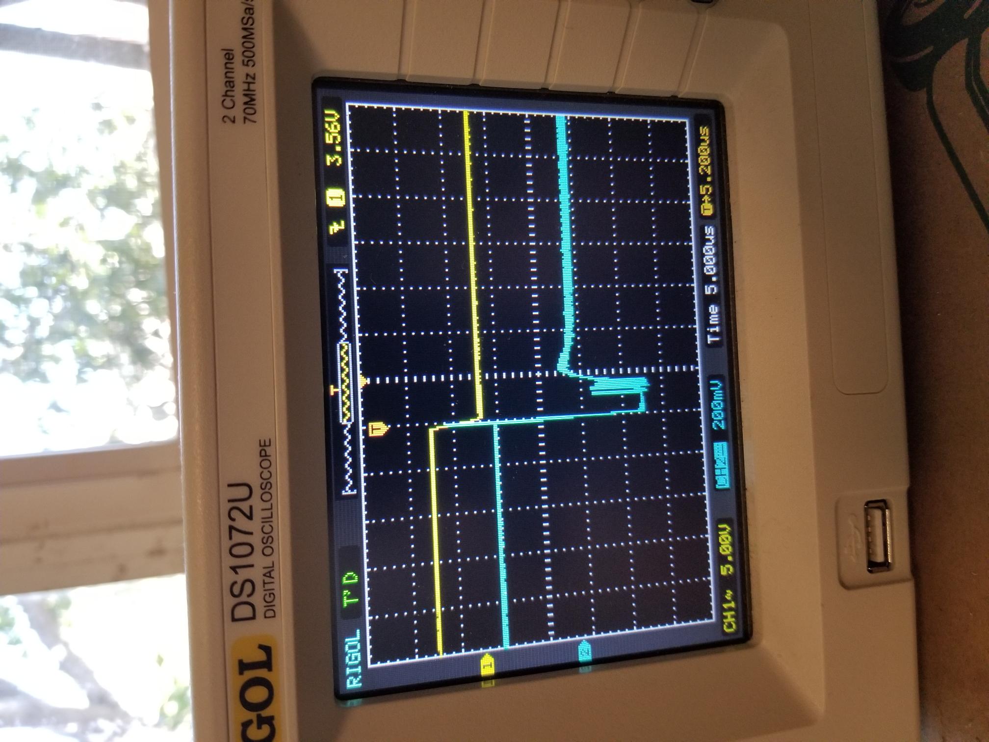

        Ive got my test detector up and running finally. I hooked up the 390Uh test coil.
        My damping resistor set up goes to 1645 ohms.
        For this coil it seems not enough. It acts a little different than my other coils on damping.
        I get a nice Knee as you damp the coil but I can keep cranking up the damping without it looking overdamped It just gets faster.
        I have to make a set up with more resistance to check this out.
        Heres the kicker When I removed the resistor set up to measure damping value I forgot to put it in and the next night I fired up the MPP and started waveing my nickle in front and I was like man its hitting better tonight for some reason.
        Then looking at my board i noticed No damping resistor installed.
        Ive done this before but usually the detector does not work due to the large amount of ringing at the 0 volt line very unstable.
        On this coil the ringing is at shut off and almost gone before the sample window.
        Here is a shot of the coil with no damping resistor.
        Has anyone else experianced this ???
        Thanks,

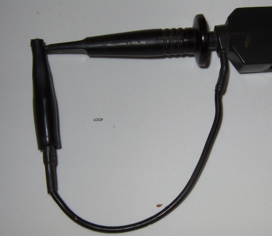

          A guess at what might be happening. MPP input resistor connects to amplifier - input, can act as Rd. I would connect the scope probe to the ground lead making a loop and hold near the coil to see if the coil damps similar to your amplifier out. Then disconnect one end of the input resistor(no damping resistor and no input resistor) to see if the coil oscillates.
          • Hi Green,
            Thanks for your reply,
            Im not sure how you mean to make the test loop. Do you mean just loop the probe wire?
            By input resistor i think you mean the 1 k on the preamp. If I remove this will the fly back harm my amps?
            • Originally posted by godigit1 View Post
              Hi Green,
              The input resistor connects the coil to the amplifier. If you remove it the amplifier can't see the coil volts so it shouldn't harm the amplifier. Leave the diodes on the input for safety.
              including a picture of loop

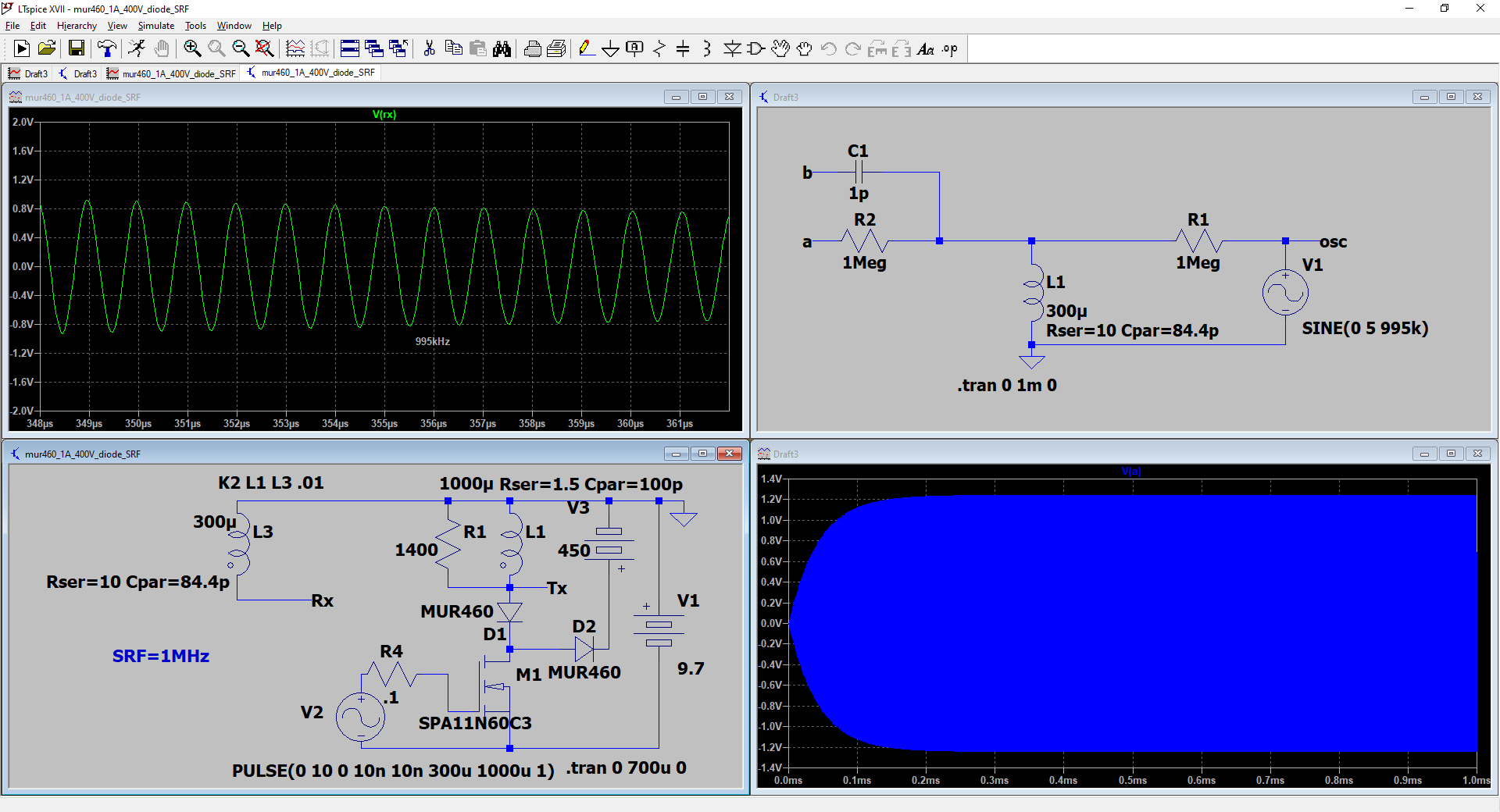

              • Tips for measuring coil self resonance.
                The output from a signal generator is typically about 50 ohms. Put a 1 meg ohm resistor between the signal generator output in series with the coil hot lead. Put the other coil lead to signal generator ground. Doing this frees the coil to easily reach resonance because the 1 million ohm resistor isolates the coil high impedance at resonance from being loaded down by the signal generator low output impedance. To keep the oscilloscope probe and leads from loading down the coils impedance at self resonance, put a 1 pF capacitor in series with the probe and the coil hot lead. Attach the probe ground to the common ground connection of the coil and signal generator. You can make a 1 pF capacitor, called a "gimmick" capacitor by twisting about 1 inch of insulated wire together and use the capacitance between the wires to again insulate the coil high impedance at self resonance from the oscilloscope probe capacitance.
                Now that the coil is hooked up properly it is time to get your reading. Ensure that your signal generator can go above 1 MHz if you are trying to make fast coils with low capacitance, as your resonance may well be above 1Mhz. With the oscilloscope probe attached through the 1 pF gimmick capacitor, sweep the frequency and observe the oscilloscope screen and when you get near resonance you will see the sine waves peak. When you stop sweeping the frequency at the peak of the sine wave display, take note of the frequency on the signal generator. That is your coil's self resonant frequency and if you know the coil inductance you can go to on line electronics calculators, enter the coil inductance and resonant frequency and deduce the coil's capacitance. Keep notes of these results with each coil style, coil wire size, coil wire insulation thickness and coil wire insulation type (dielectric constant), shielding material and distance from the shield to the coil wire. Each variation will give you different capacitance levels and offer you good insight in construction techniques to reach your goals.
                Just so you know what impedance range you are working in, do this calculation. Coil impedance is XL. XL = 2 pi X F (frequency) X L (coil inductance) A 300 uH coil is 300 with the decimal point moved 6 places left to get into the H range or .0003H. Now just multiply 6.28 (2 pi) X .0003 and X 1,000,000 (1MHz) and get 1,884 ohms. However, at resonance the coil impedance is very, very high due to the quality factor or Q of the coil which can be 10 to 50 times the coil impedance.
                Now we are playing in the impedance range of about 19K ohms to about 94K ohms so you see how the 1 meg ohm isolation resistor and 1 pF capacitor allows the coil to do its own thing and allows you to accurately see it.
                This is how science is done. It is not a magic belief system but something that can be replicated over and over once you understand what is going on. Accurate measurements don't lie! The fun part about learning is beginning to understand what is going on and how all the different things done in your latest coil design are related.
                Joseph J. Rogowski
                • Originally posted by bbsailor View Post
                  Joseph J. Rogowski
                  Which methods do you consider magic belief, maybe any but the one you suggested?
                    If you can explain another method and someone else can get the same results, this is not magic. Look at how Eric Foster designed detectors more sensitive to small low TC targets by using the concepts of a "Lock-in" amplifier where multiple RX signals were integrated while the coil was over the target and many integrated samples could rise above the noise level rather than pumping more energy into the TX mode. This design concept had consequences of needing a fast PPS TX rate and controlling sweep speed to get enough samples to integrate while the coil is over the target.

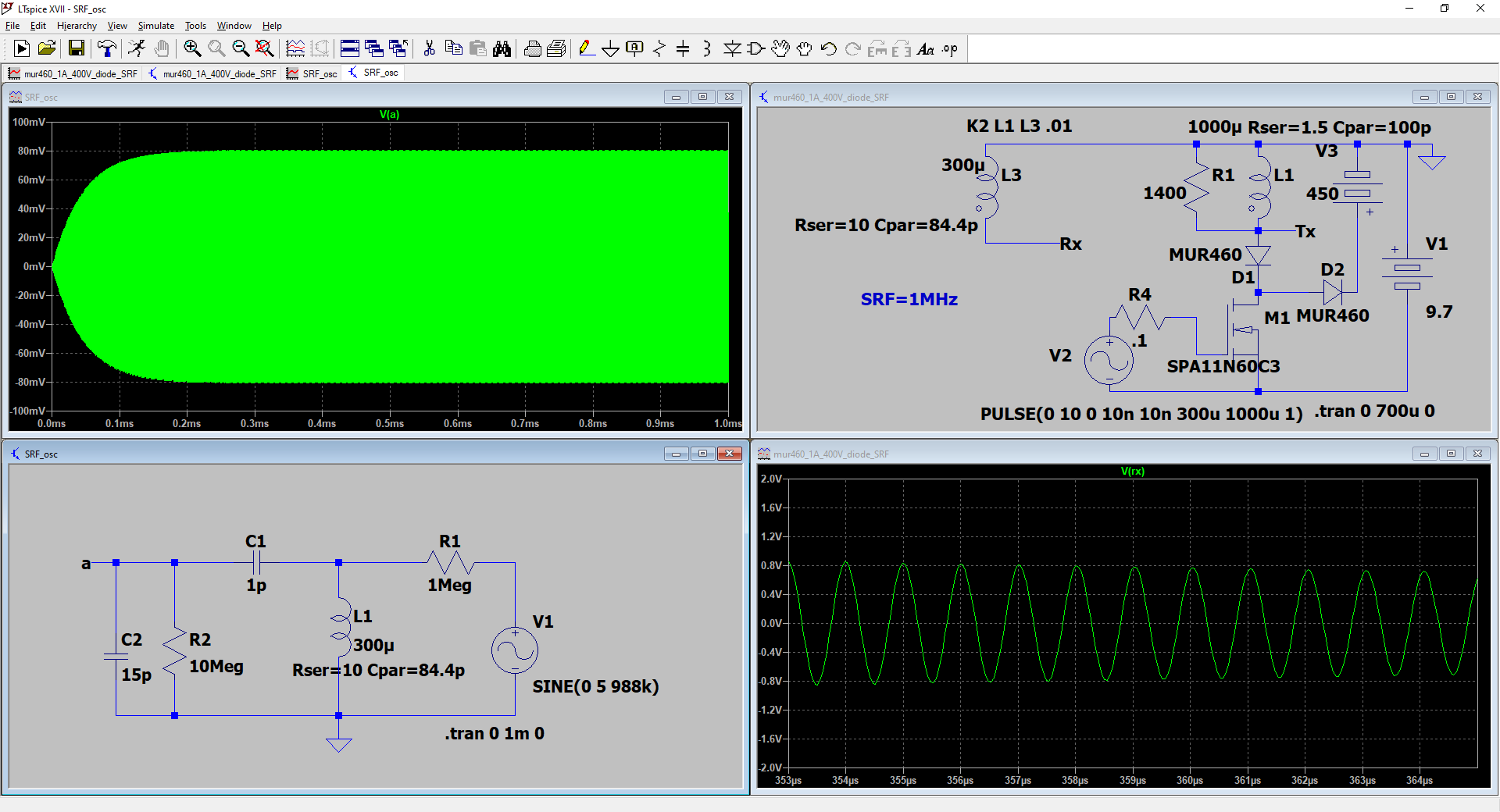

                        • I recently built a new 3dss coil for my minipulse and I'm unsure if I measured the self resonant frequency correctly. from https://www.geotech1.com/forums/show...685#post260685 ____Appears measuring SRF isn't always easy.
                          I apologize for taking This is how science is done. It is not a magic belief system but something that can be replicated over and over once you understand what is going on. Accurate measurements don't lie! personal
                          from reply #172 above. I had just suggested a different method than suggested in reply #172 a couple replies before and was thinking maybe it was magic belief. I'm learning metal detectors so I'm sure I make some measurement errors. Tried another spice simulation, closer to what bbsailor suggested. With C2 and R2 disconnected(scope probe)signal peaks at 195kHz not 988kHz with the probe. The difference errors don't matter for the SRF measurement for a PI detector. But if we want to make an accurate measurement it would be nice to know what can cause errors. Does anyone know or have a guess why SRF calculates 1MHz and measures 995kHz? Is there a reason spice could show an error when the actual measurement wouldn't have an error? Do the spice simulations need correcting?
