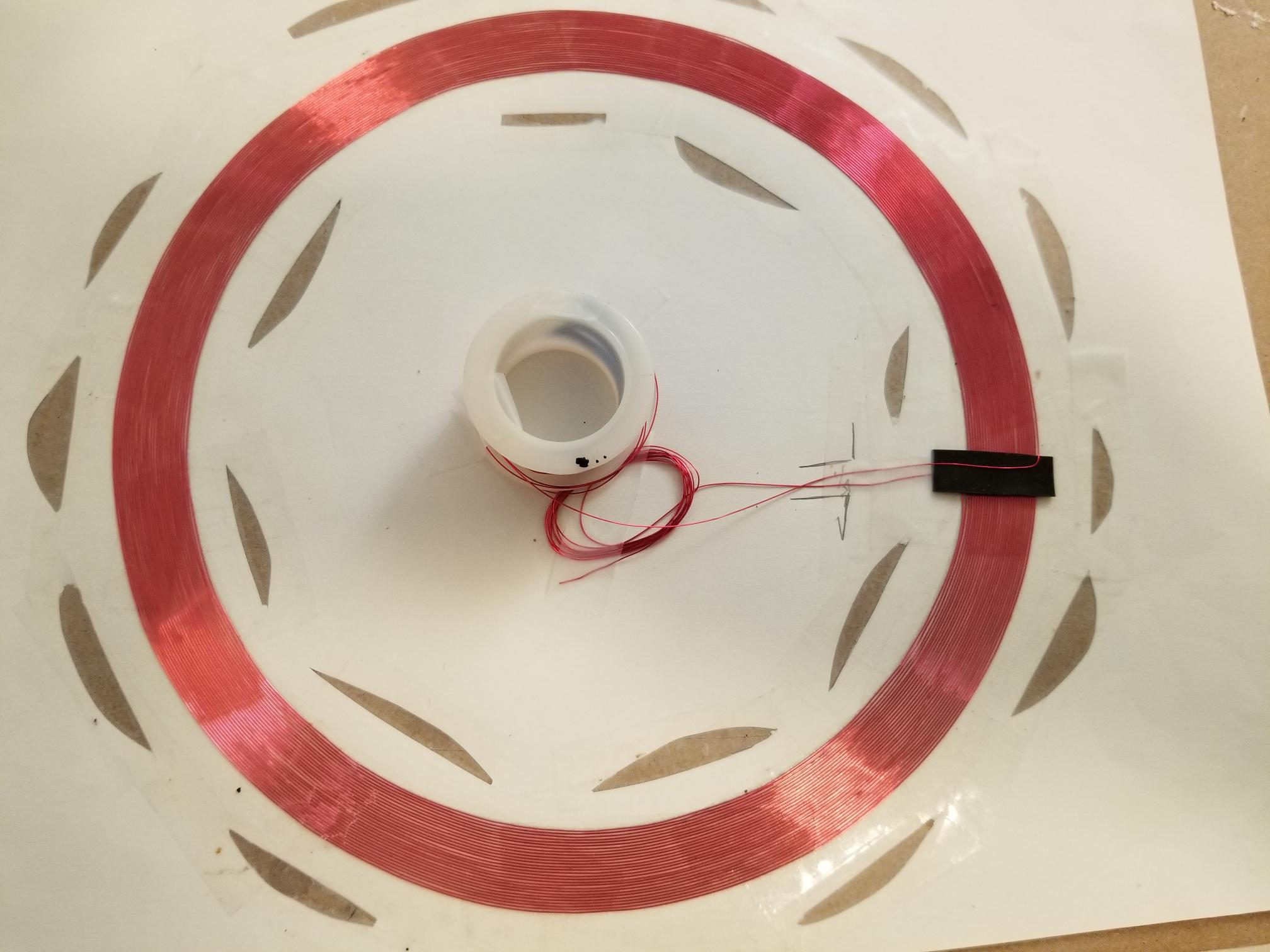

                                Ive been using double sided tape to make the coils.
                                Just use a compace to make the inner diameter you want and tape around it with double sided tape. If you hang it over the I.D a 1/4" it helps when you peal the coil off the paper.
                                I use a bic bright liner highlighter pen as a burnishing tool to press the wire to the double sided tape. You dont even need a form to start just draw the wire around the Id. circle on the paper then stack the next wraps against it.
                                One the first wrap is on its easy. Ive gotten pretty fast I can make a no space coil in 45 minutes ready for foam. Spaced coils take twice as long.
                                For the spaced coils Im simple using a couple lenghts of wire each about 3 wraps long and I apply them between wrpas and use them for backing. then you can leap frog the back wire each time. On the two wire space I used 4 leap frog wires.
                                If you try this use the scotch perminent double sided tape. It has the best adhesive and peals right off the foam afler forming.
                                Another thing is do it on a warm substrate to keep the adhesive gummy. I use a peice of sheetrock.

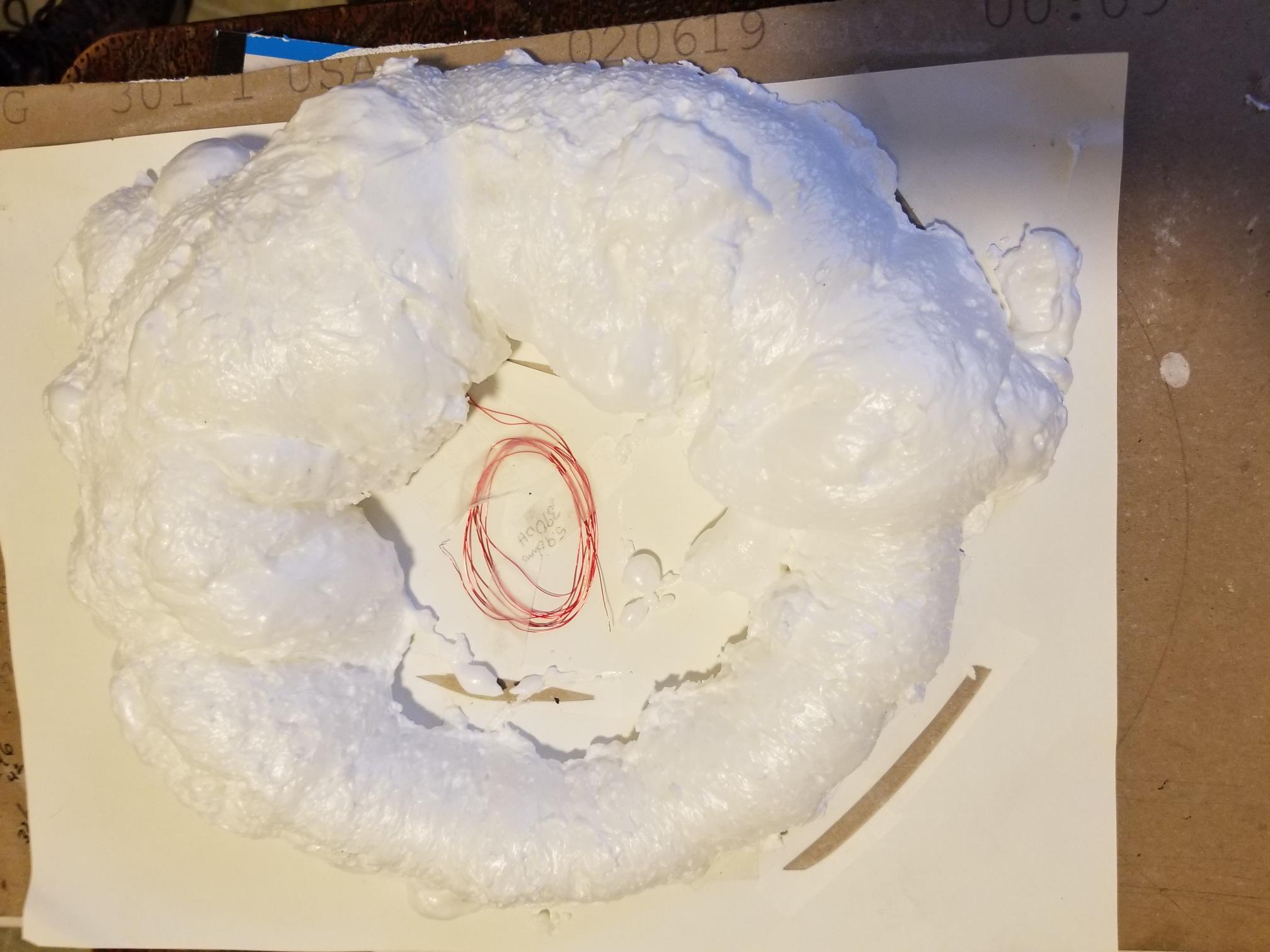

                                I Changed foam from my original locktight gaps and cracks to locktight door and window The door and window stays more true when curing and expands less.

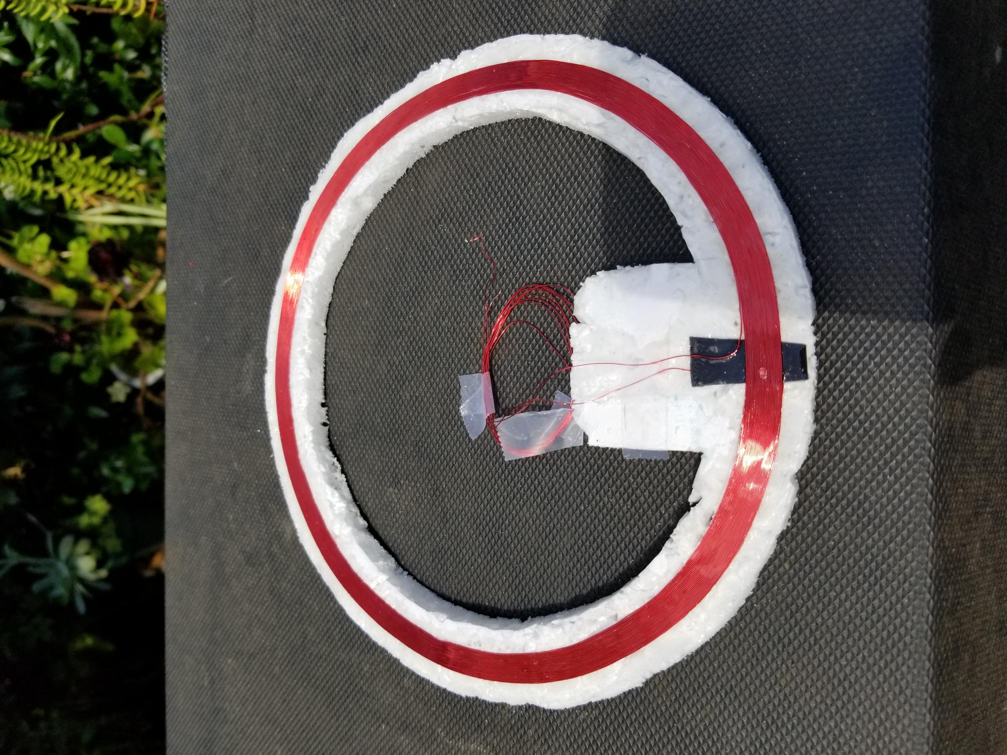

                                Once you have the coil made I cut windows in the paper and tape it securly to the sheet rock spay it with foam then cut it to size.
                                Once the foam is cured flip the coil over and compase I.D and O.D to the back of the paper. Use a exacto and cut a full blades length deep avoiding the leads of coarse.
                                At this point all I do is use a hot wire cutter to slice 3/8" slice through the top and the coil just peels out.
                                Another slice of foam sandwiched on top and you have a coil you can package.

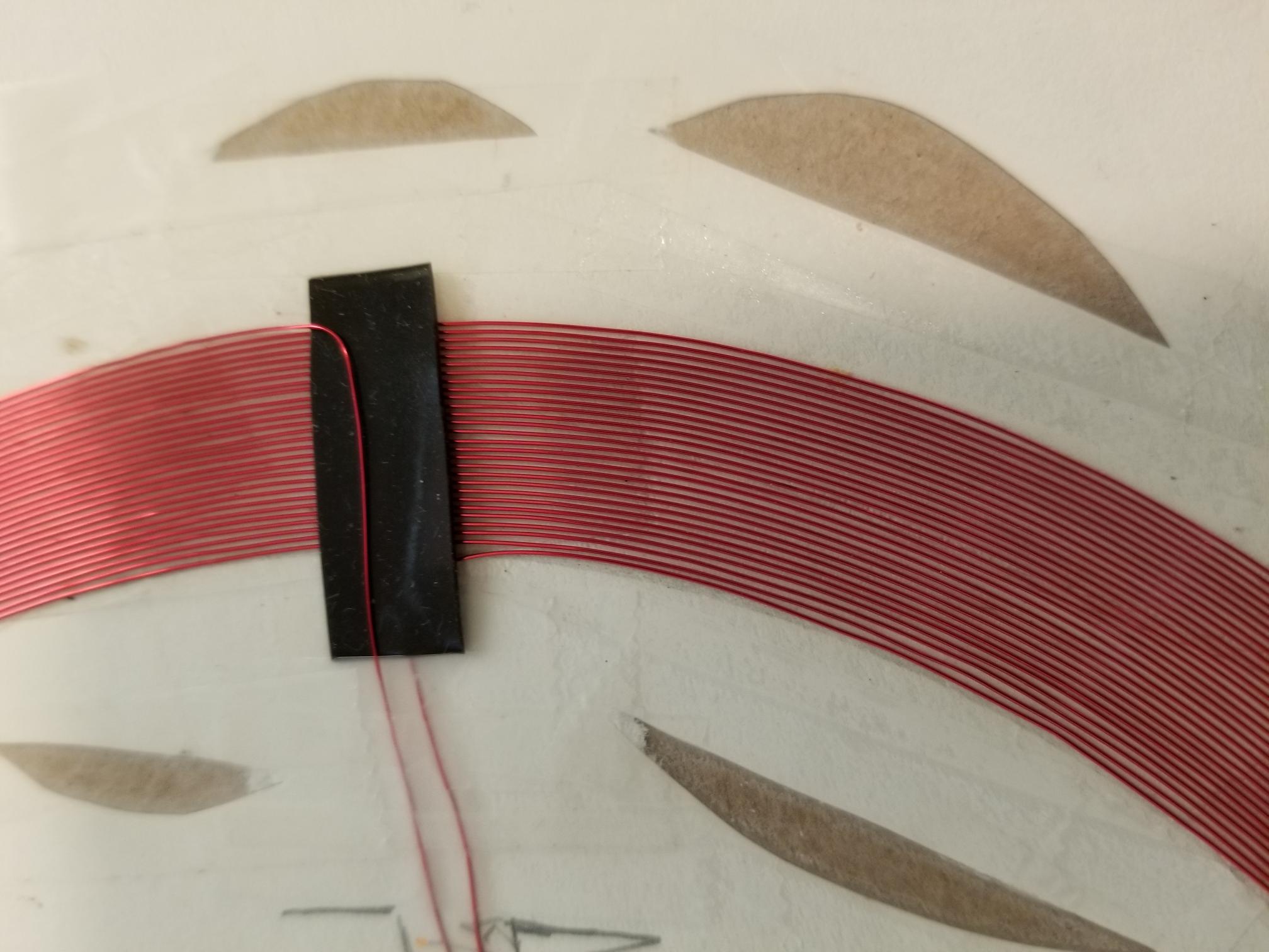

                                I tried eyeballing the first few wraps on this coil before i started using a space wire you can see some wobblyness there but the rest stays pretty consistant.
                                The black spacer is silicon flex tape I use to insulate the - wire where it passes over the coil . It has a suposed 8000 volt rating.
