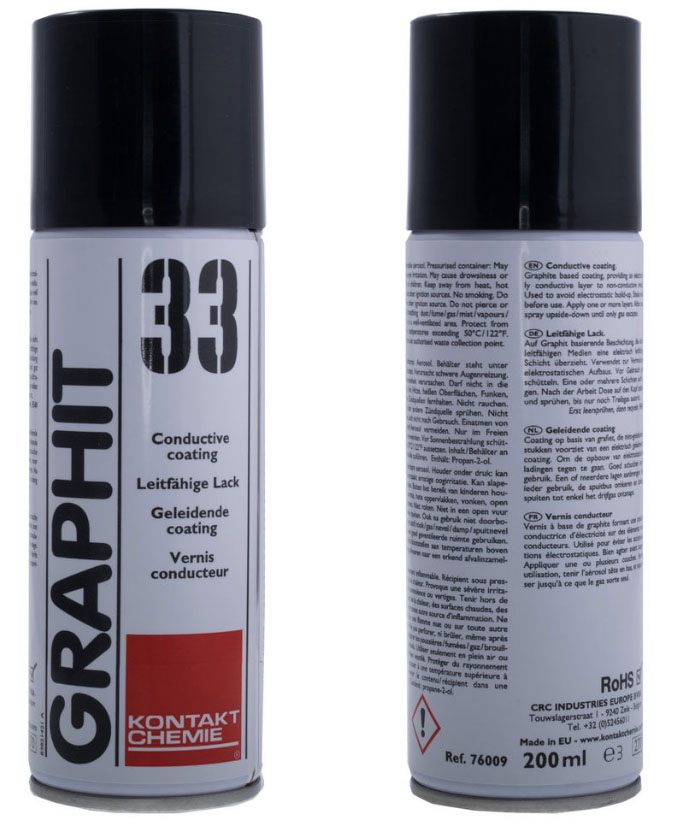

                  foil shield is killing all sensitivity. i see nothing of excellent. just he splitted the coil from foil thats right and did not fill by epoxy also right.
                    foil shield is killing all sensitivity. i see nothing of exellent. just he splitted the coil from foil thats right and did not fill by epoxy also right.
                    I have used foil tape for shielding without any huge loss in sensitivity. However, Eric recommended some conductive fabric tape which is better -> https://www.ebay.co.uk/itm/UK-20M-Co...72.m2749.l2649
                    • There are a number of ways to shield
                      coils, including foil, wire wrap, metallic
                      tape, and conductive spray coatings.
                      A simple method is to wrap the coil
                      with aluminum duct tape, the kind easily
                      found at the local home
                      improvement center. This is the tape
                      that is true aluminum, not the silvery
                      metallic-looking fabric duct tape. Standard
                      duct tape is slightly conductive,
                      but not enough for shielding.
                      i took this cutting from Carl text. you see the material is not foil, but aluminum duct tape.
                      also take attention on word slightly conductive. so really it is just a micro thin aluminum film on dielectric base practically NOT conductive.
                      while we see fat copper tape in this PDF the man used.
                      here in Europe, on continent, we use GRAPHIT 33 https://www.youtube.com/watch?v=GitaTiM1A3A
                      Belgian made.
                      The world-famous graphite mineral, due to its unique properties, including high electrical conductivity, is used in various industries and, accordingly, a number of necessary goods, let us consider one of the types of which, using the Belgian aerosol product Graphit 33 as an example, consists of highly purified colloidal graphite .. .
