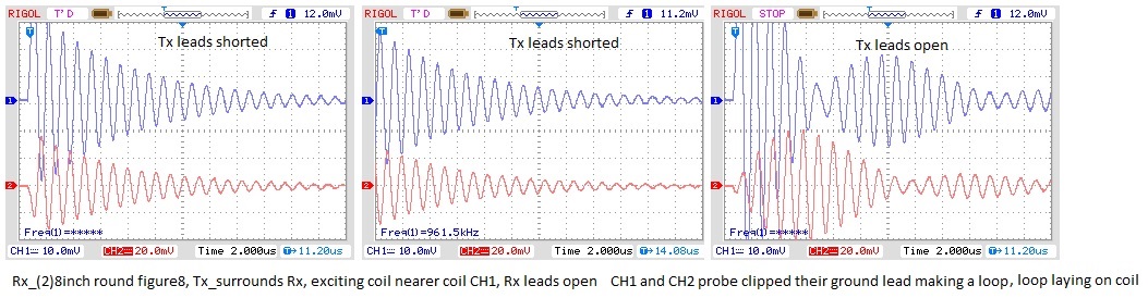

              • I also wonder what your SRf wave form on your Rx section looks like compared to the mono eights I have?
                • Hi Green,
                  Thanks for the wave forms.
                  Pretty much what I was thinking I would see. Your Rx coils coil behave the same way as the Eights I have.
                  That is Im seeeing a longer more seems more even voltage drop. Thinking this is due to the way A eight cancels if I could compare it to a twisted pair in that it evens out the end signal.
                  I have to ask Are the two channels both sides of your Rx Coil or is it Tx ch1 and Rx ch2?
                  I was thinking there would be a slight time difference between the two RX coils hitting SRF together. Your wave form is stepped between Channel 1 and 2. Rise and fall times are same but one waveform lags. Not sure if im looking at tx or both Rx coils though. If its both Rx coils then I think thats what im seeing.
                  Im wondering if that extra time is there if it helps to stimulate the target longer?

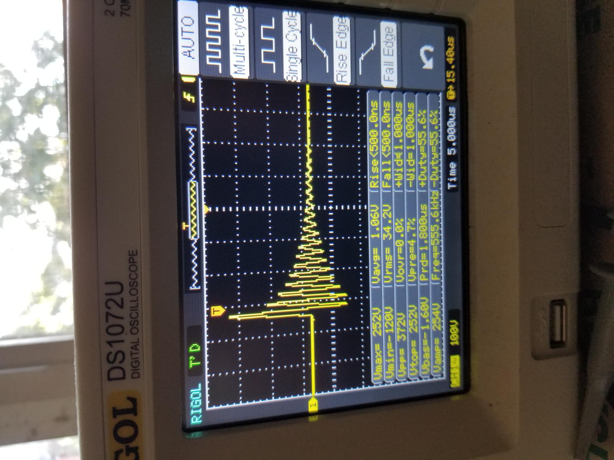

                  Here is a picture of the wave form for the eight planar I did.
                  Long decay time
                  The other picture below is the TDi folded mono.
                  Ive hooked it both shield and non shield connected and no matter the way Srf seems to be locked in Im wondering if there is a cap inside Maybe?

                    • I have to ask Are the two channels both sides of your Rx Coil or is it Tx ch1 and Rx ch2. Both sides of the Rx coil, they are opposite phase. If I flip the CH2 pickup loop over they are in phase. The Rx coils are the same(balanced) so the frequency is the same. With Tx leads open it also oscillates but at a different frequency causing a beat signal(right picture).
                      I see you are connecting the test coil to your Tx circuit. Have you tried connecting the scope probe to it's ground lead making a loop, laying the loop on the test coil and position the test coil near a operating PI coil to excite the test coil? If you try, the test coil ground lead should to be connected to one of the test coil leads since the test coil is floating. I have forgotten more than once and have connected it to circuit common(wrong).
                      • A 5 ohm, 300uH coil at 1MHz should have a Q of about 375. When measuring SRF, cycles(for amplitude to decay to .37 of start)=Q/pi. (375/pi=119). The measured decay is a lot less cycles. Is it due to measurement method or Q at SRF isn't a simple calculation? What should Q be at SRF?
                        g3rbj.co.uk/wp-content/uploads/2014/07/Self-Resonance-in-Coils. suggests Q at SRF is a lot less than at 1/2 of SRF.

                        • Hi godigit, have you tried storing the scope screen in bitmap, paste in Paint and save as a jpeg file?

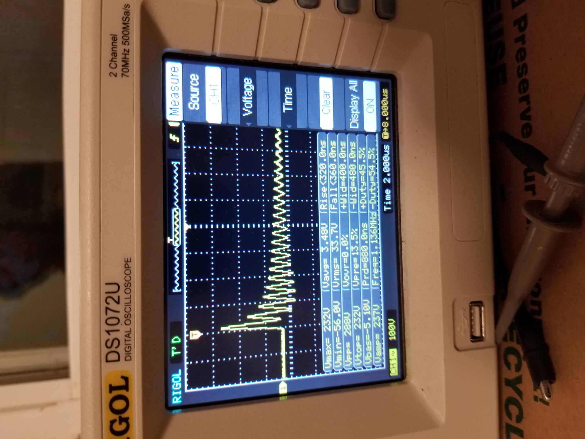

                            On the third scope shot with beat signal.
                            Im wondering that if we think of the coil as a non terminated transmission line "it is not connected to ground". then would the beat oscillation be what is called mirroring?
                            That is the signal gets to the end of the line and bounces back at half amplitude. I watched a vidio a while back on this but a square wave was used.
                            Im not sure if thats it just thinking maybe.

                              Not saying what is right or wrong. Looking at your scope traces, I assumed your test coil was connected to your PI because the peak voltage is over 200V. I get mV the way I do it. I get a lower SRF if I connect the scope to the coil vs using a loop to pick up decay.
                              Think the beat frequency is two coils oscillating at different frequencies, amplitude adds when in phase subtracts when out of phase.
                              I'm thinking coil Q at SRF isn't important with a PI but not sure. Mostly a learning experience, read a formula for Q for decay in a filter book written by Don Lancaster. Couldn't find my book and posted the formula wrong the first time, correct(Q=pi*cycles to decay to 37% of start amplitude). When I try a spice simulation the formula(Q=pi*cycles) matches(Q=X/R)spice doesn't know it's SRF. Q=X/R, R might not be DC resistance due to skin effect, don't know what all effects Q at SRF of the coil.
