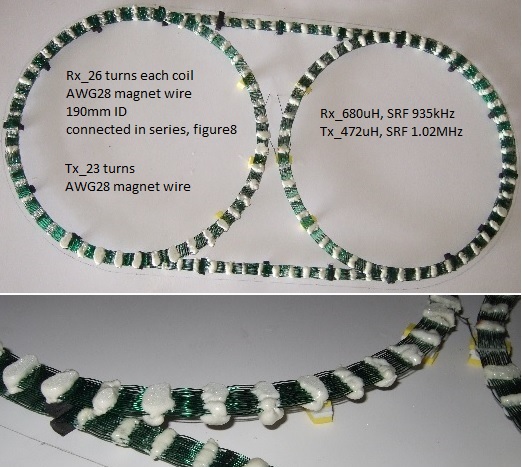

          Interested in what your learn with your coils. With my figure8 Rx coil the two round coils are connected in series. Rx inductance is the sum of two round coil inductances. Neither round coil is balanced with the Tx coil like a DD. To balance, either round coil is positioned to give the opposite signal of the other. How are you using bandwidth and Q to relate to PI coils? I'm thinking Tx resistance effects charge current profile. Coil + circuit capacitance effects Rd which controls discharge rate.
          • " How are you using bandwidth and Q to relate to PI coils? I'm thinking Tx resistance effects charge current profile. Coil + circuit capacitance effects Rd which controls discharge rate."
            Part of testing these coils has helped me to understand how to adjust SRF of a coil. So thats easy some might say. but what if you need a coil with a exact resistance and Srf range you have to engineer those perimeters out of a specific length of wire. Calculators could be played with for various wire diameret wrap and size combinations to get what we need. But capacitance and inductance are kinda locked in by those perimeters say if you are building a bundle coil as a example.

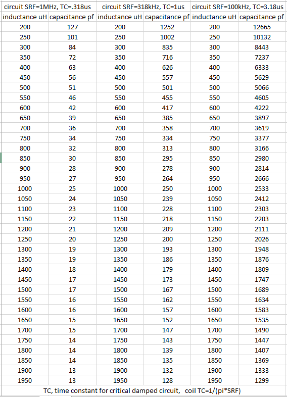

                Thanks for the data and the explanation of Q. Wasn't relating Q to SRF. What procedure did you use to measure SRF? Your coil with no spacing has a lower SRF but a higher Q, which is better. Both are close enough to be the same. How fast does the coil need to be? Tested some 8 mesh nuggets(7/gram)awhile back. TC's varied between 1 and 2us. Smaller nuggets could be less than 1us. bbsailor suggests the coil TC should be 5 times less than the target TC. For a 1us TC target, coil TC should be .2us(SRF=1.59MHz). Assumes no added circuit capacitance, coil lead probably add at least 35pf. Tx circuit needs a MUR460 diode in series to isolate the mosfet capacitance. Need to add shielding. [Think target not detectable if coil TC is greater than target TC, Coil TC doesn't need to be 5 times less, probably should be at least 3 times]? Made the chart reply #109 with circuit SRF 1MHz, shouldn't be that hard to get circuit resonance of 1MHz. 1.59MHz could be difficult. If you add 35pf(lead capacitance) to your above coils, SRF would be close to 1MHz. The center chart data is for circuit resonance of 318kHz(1us TC). Is 318kHz good if not looking for small nuggets, very low TC targets? Probably not hard to get 318kHz.
                If trying for 1MHz SRF. Is there any reason not to try for maximum inductance?
                Some thoughts for discussion, maybe correct maybe not.
                I'm using the figure8 Rx because of less noise pickup and reduces ground signal. Get better detection distance with my detector, don't know if I'm doing something wrong with mono coils. Disadvantage, need to make 3 coils to make one detector coil. Would be good to know how to design a coil for the application with mono coils and not have to build three coils for every try with my coil.
                    Some questions and thoughts.
                    If we decide we need a circuit SRF of 1MHz(TC=.318us), should the amplifier have a frequency cutoff of 1MHz or would the MPP amplifier with a frequency cutoff of 300kHz be just as good for 1 to 2us TC targets?
                    If desired target TC's are greater than 3us, would it be better to design for SRF of 318kHz(1us TC) instead of 1MHz(TC .318us)? I have three other nuggets, 4grain(3.1s TC), 10grain(6.7us TC) and 18grain(5.7us TC)? Maybe can make a 318kHz coil that would detect the three nuggets better than a 1MHz coil? Are there desired targets with TC's less than 3us other than gold nuggets? Maybe gold chain and micro jewelry? The lower SRF would reduce the signal for some unwanted low TC targets. I've been trying to get the circuit as fast as I can, maybe for the challenge. Wondering how fast I should be trying for.
                    Should the amplifier frequency response be the same as the Rx coil frequency response? With an IB coil, does the Tx response need to be as fast as the Rx response?

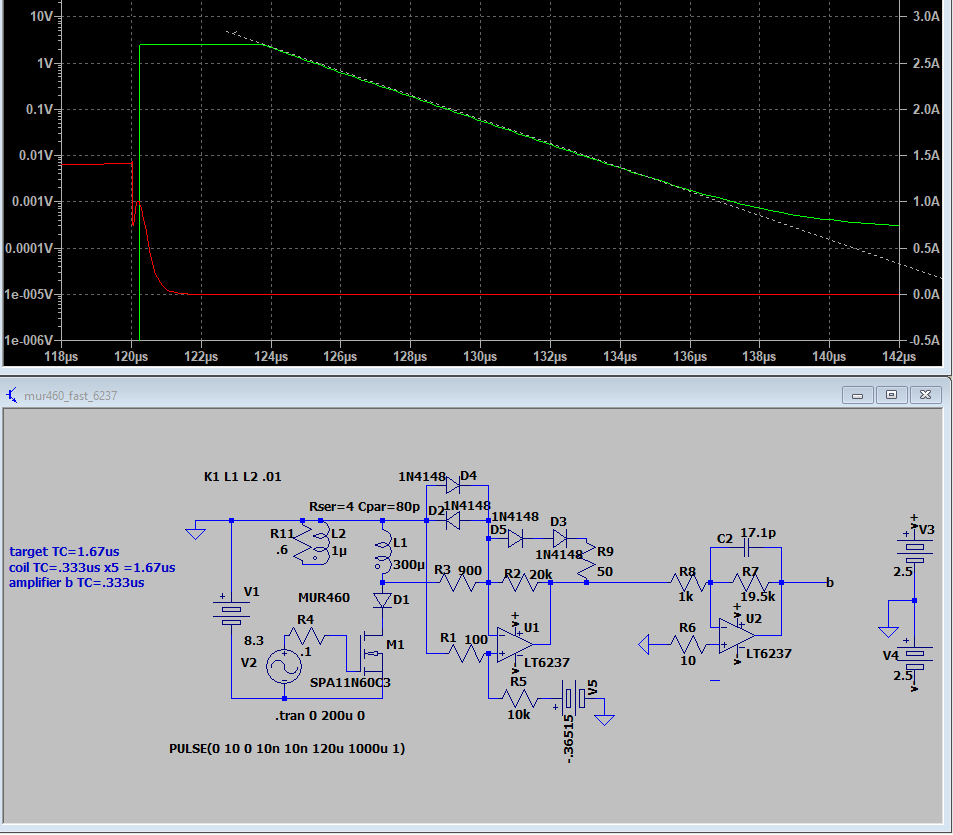

                      The amplifier should have more bandwidth, rule of thumb is 10x for no distortion, than the coil delay else it will not accurately follow the decay curve.
                      The TX Turn-OFF response Must be fast. Else it will stretch out the decay curve and also not allow the target's Decay to produce the largest signal.

                            Tried a circuit in spice. C2 sets amplifier TC, 17.1pf for amplifier TC=coil TC=1/5 target TC. Change C2 to change amplifier TC, 85p for amplifier TC=target TC. Don't know if simulation would match real circuit or if the simulation is correct. Amplifier TC=coil TC looks good. Changing C2 to 34pf doesn't look to bad.

                              So how fast does a coil have to be in order to be a five us coil after the shielding and cable are added if using a cable.
                              Im still trying to wrap my head around the Chart but it looks like you are saying I have About 35 pf to play with for shielding? As all the coils allready have leads.
                              That would make the coil capable of .2 us TC ?
                              " Is there any reason not to try for maximum inductance?"
                              Good question. I will be curious to see how the three different coils act. Really inductance was the perimeter adjusted the most. Capacitance very little, Surely not enough to justify the extra effort of two line width spacing.
                              Here are the specs for the first two again to compare with three.
                              Coil1
                              No spacing between wraps.
                              5.9 ohms
                              390uh
                              1.389 MHZ Srf
                              33.664 Pf
                              Q 576.559
                              Coil two one wire spacing.
                              5.9 ohms
                              340 uh
                              30.469Pf
                              1.563Mhz
                              Q 565.10
                              Third coil two wire spacing.
                              5.9 ohms
                              298uh
                              1.667Mhz
                              30.588pf
                              Q530.5
                              They are all so close so back to your question why not go for max inductance in a case like this anyway?
                              Ive been procrastinating on getting a test unit up it involves breaking down other projects right now. having a hard time deciding the victim. Figured might as well get a few coils done in the mean time .
                              Have you tried a figure 8 mono with your Detector?
                              • Hi godigit, Interesting tests. I haven't tried a figure 8 mono, just the figure 8 Rx with oval Tx. Very small nuggets are one of your desired targets? I'm interested in how short a delay you can get the MPP. I've been thinking amplifier TC should be close to coil TC. MPP has a 1us TC?
