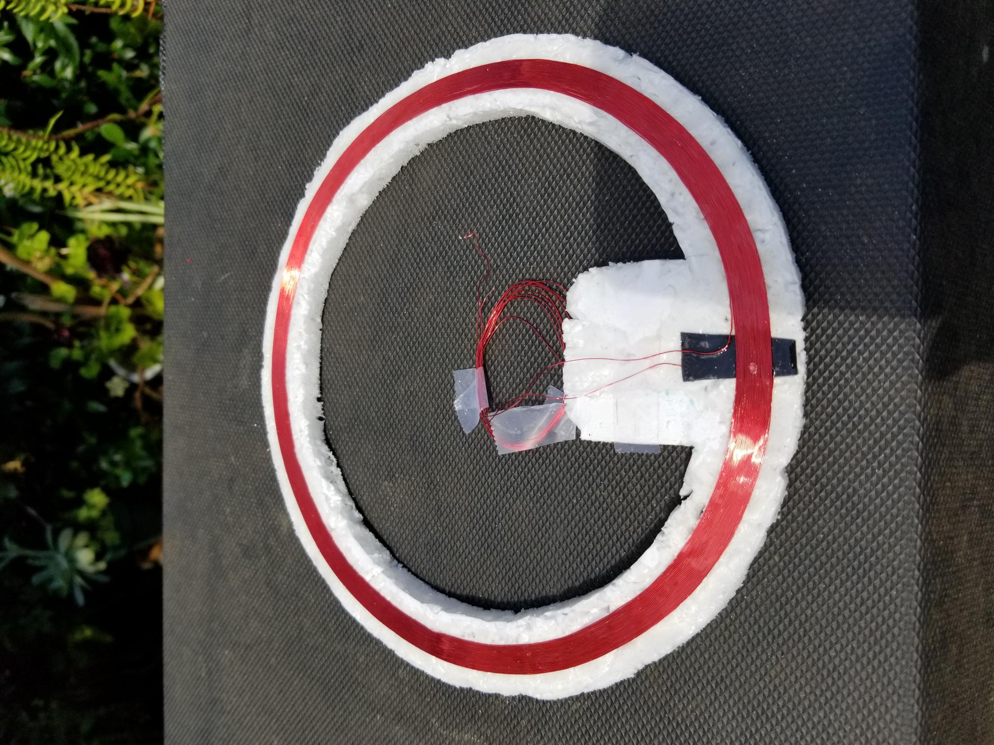

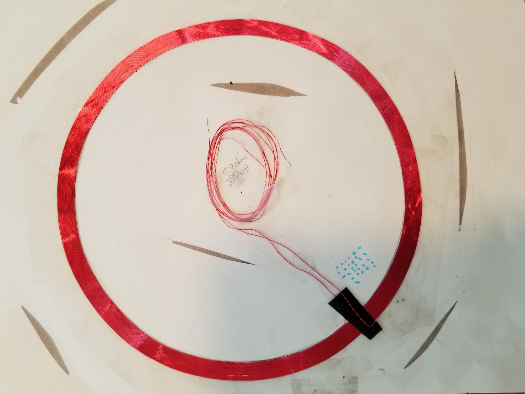

                          Hi Green,
                          Ive been using the calculator form Q here on the forum. Most of the time its within a wrap or two.
                          For the first tests im going to use 30 Awg single strand wire. I figure the extra spacing is kinda like using a wire with better insulation but good old cheap magnet wire.
                          Coils are 6.5 inch inner diameter.
                          For now I will be forming on paper with double sided tape and transfering the coil to foam.
                          I just finished the first one
                          Wire length is 54 feet with leads
                          Calculated inductance for a 6 .5 inch I.D coil with 28 wraps came out to 410uh.
                          The actual coil is measuring 390 uh 5.9 ohms so pretty close.
                          Hoping to hit a target point of 300uh after adding one then 2 lines of spacing to the coils.
                          This is the coil on paper.

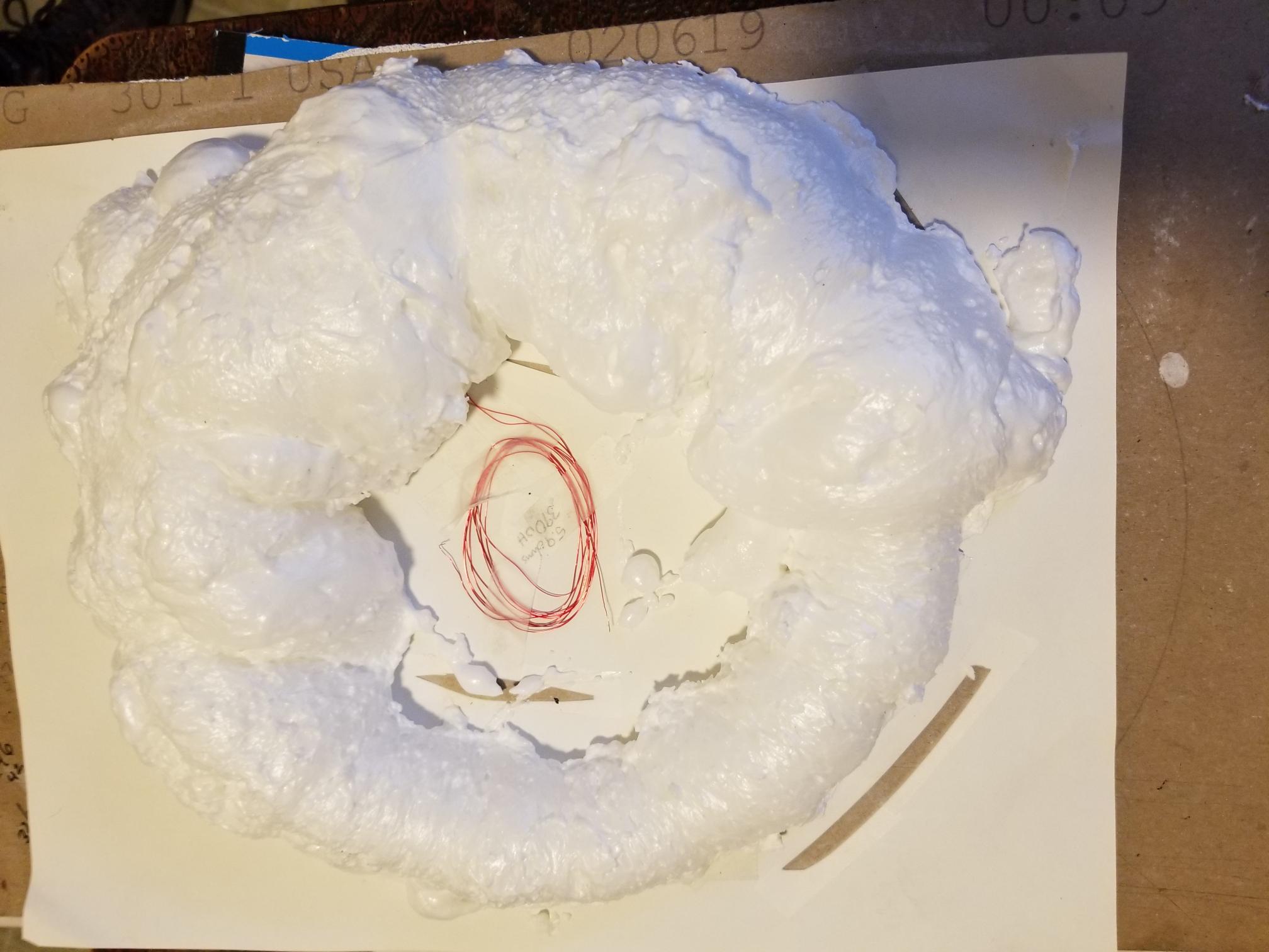

                          This is foamed. I got a little out of hand.
                          Here it is trimmed out and with a coat of super corona dope over the windings. Its still curing.
                          Beacuse of the over use of foam and the coil only had the rigidity of a peice of paper the coil itself is not perfectly flat. It sits pretty flat but the surface has rolled a bit. the outer diameter is about 2 wire thicknesses lower than the I.d. it has maybe a 5 to 8 degree nice even tilt.
                          I need a better transformer for a foam cutting table I made. this way I can wind directly onto a cured formed slice of foam.

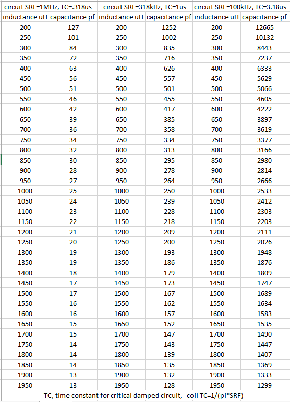

                                Theory tells us that to fully stimulate a target, the TX decay pulse time constant needs to be 5 times faster than the target time constant. The TX pulse TC for a 2us target would need to be 2 divided by 5 or .4uS. The TX decay TC is calculated by dividing the coil inductance by the effective damping resistor (Rd) value. bbsailor reply#92
                                Thinking about a larger coil. Coil I'm using now is Rx_(2)8inch round figure8, Tx surronds Rx. SRF(Tx and Rx) close to 1MHz. Should be good for targets above 1.6us TC. Thinking larger coil not good for faster TC targets, maybe .318 MHz SRF(1us TC)good for targets with TC greater than 5us might be a place to start. Is there a disadvantage to making the coil with the highest inductance other than weight?
