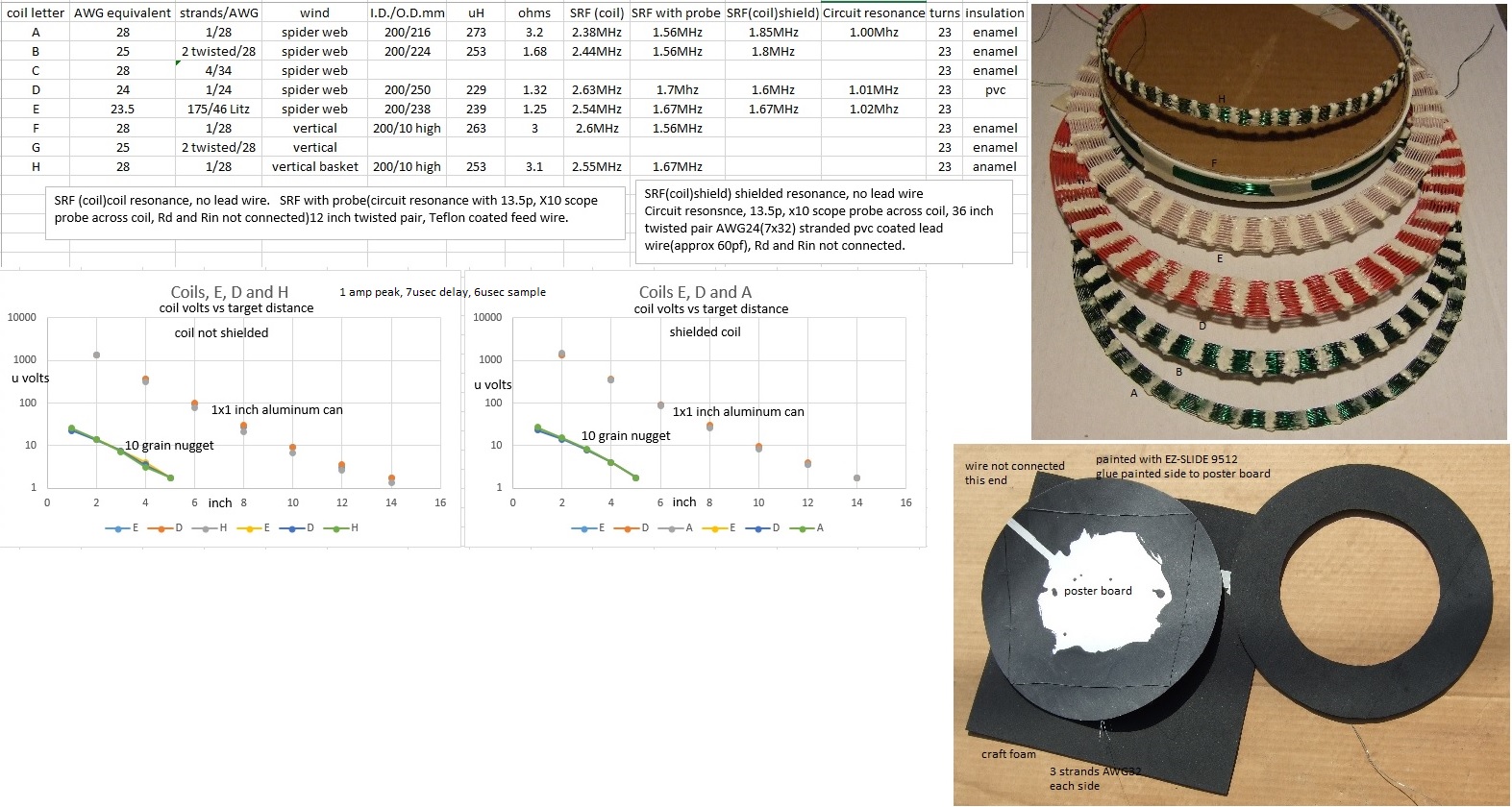

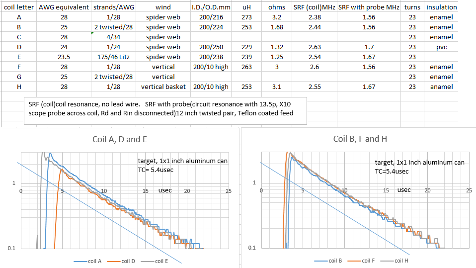

                  Its hard to tell for me on the litz 4 graph, at the bottom where the colors all come togeteher they mingle and to me it looks llike coil B is 1 usec faster. but coil E has a faster rise time. wonder if thats partially due to the low inductance?
                  As far as a magic coil no I think thats allready hear they cost 1700 Bucks. I just wanted to try adjusting coil perimeters a different way using one peice of wire length to see what the different capacitances and inductances do. Been messing with designing or moddind coils want to twist my own wire so i should learn what each varyable does, such as larger wire mass with lower inductance, Will it just slow down the coil? Who can answer that for me. I have no tutor i have to learn imperically.
                  Maybe im just making nice antennas.
                    Litz_4, vertical coils F and H have highest signal at 5us. Litz_7, vertical coil H has lowest signal at 14inches. Think coil diameter is some of the reason, vertical coils have the smallest mean diameter. Smaller coils are better at short distances(target was close to get good signal when recording), worse at longer distances. Litz_4, vertical coils F and H come out of saturation sooner than coil B. Think coil E(Litz)is the fastest because the larger wire used in the other coils act as a target causing longer time to come out of saturation, only about 1us difference between Litz and AWG28(AWG24 longer time)made a spiral coil with AWG19 magnet wire(over 10us to come out of saturation).
                              Thanks for explaining I was looking at the graph wrong realized that later after I posted.
                              Started to make the verticle test coils then decided it was not practicle for the test. With the increased spacing and 28 wraps the coils would be too tall.
                              Still trying to decide between flat spiral or a verticle stack 7 high 4 wide.
                              Both have advantages but thinking the flat will be better for testing where the inductance is concearned.

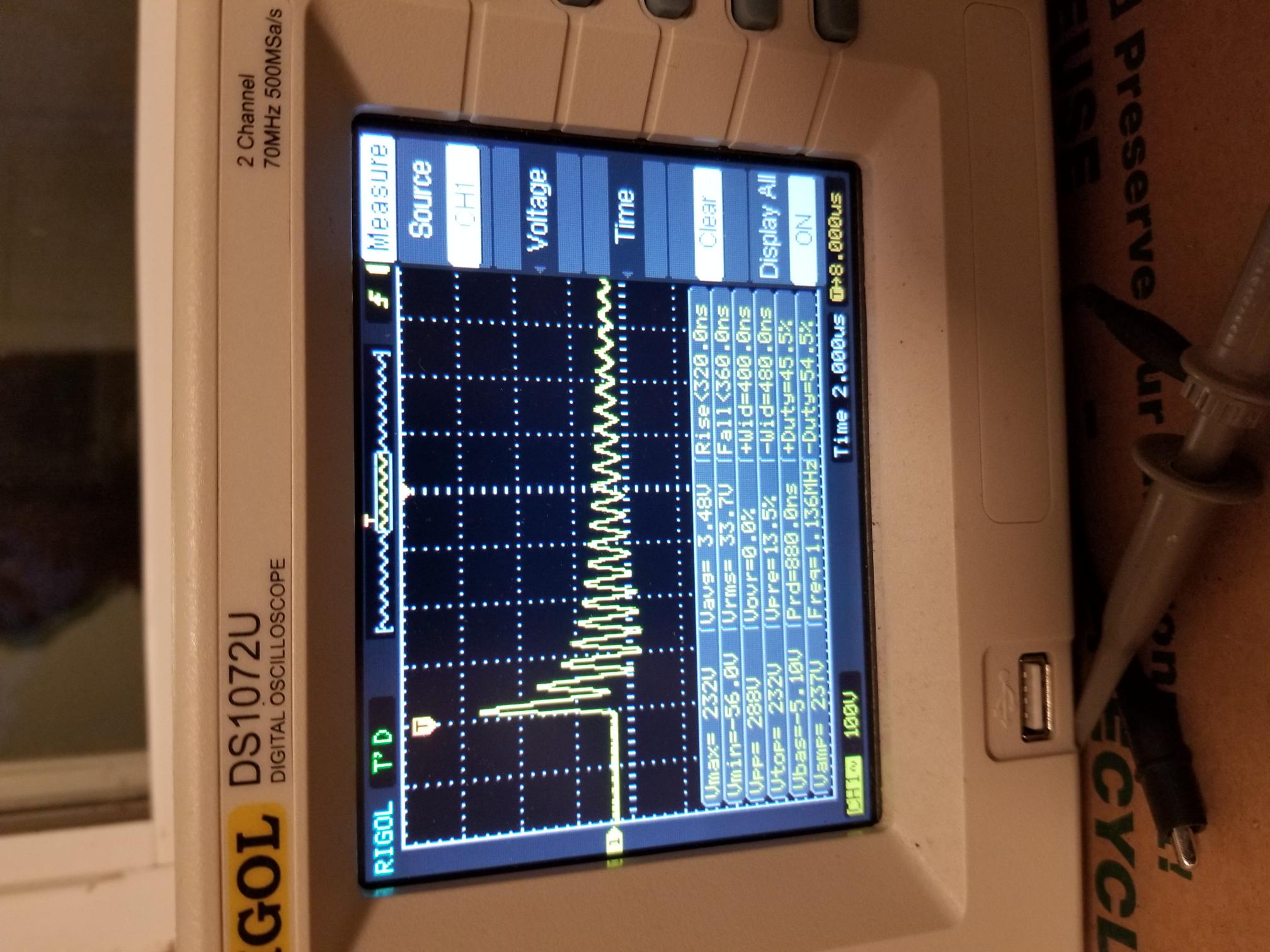

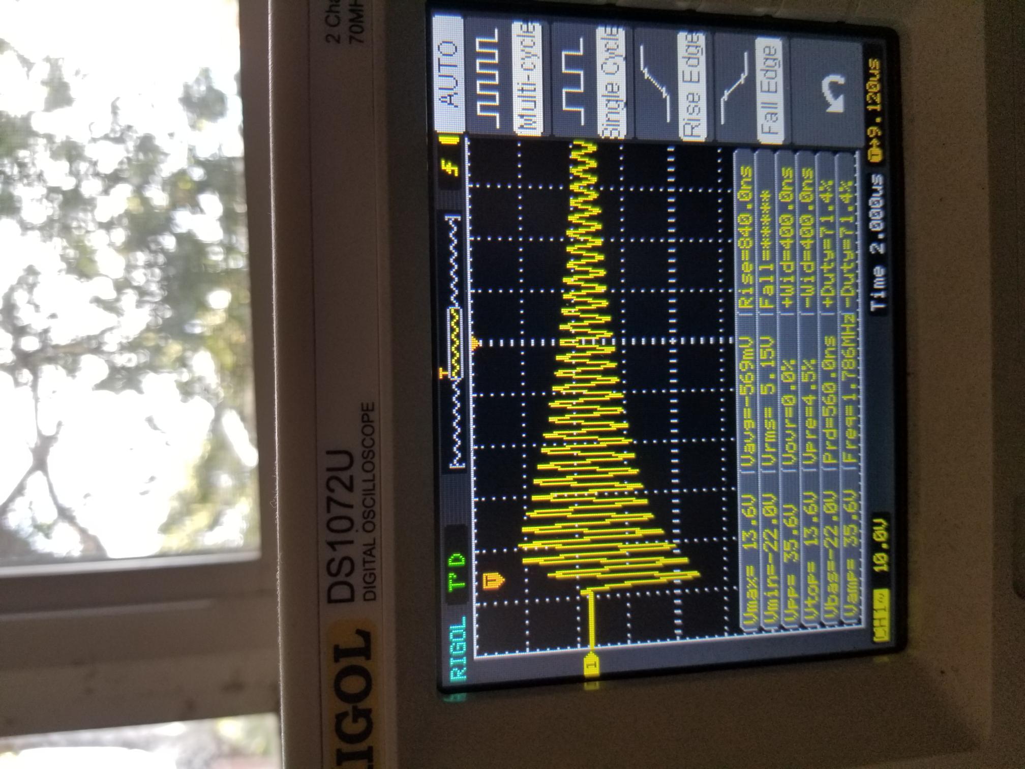

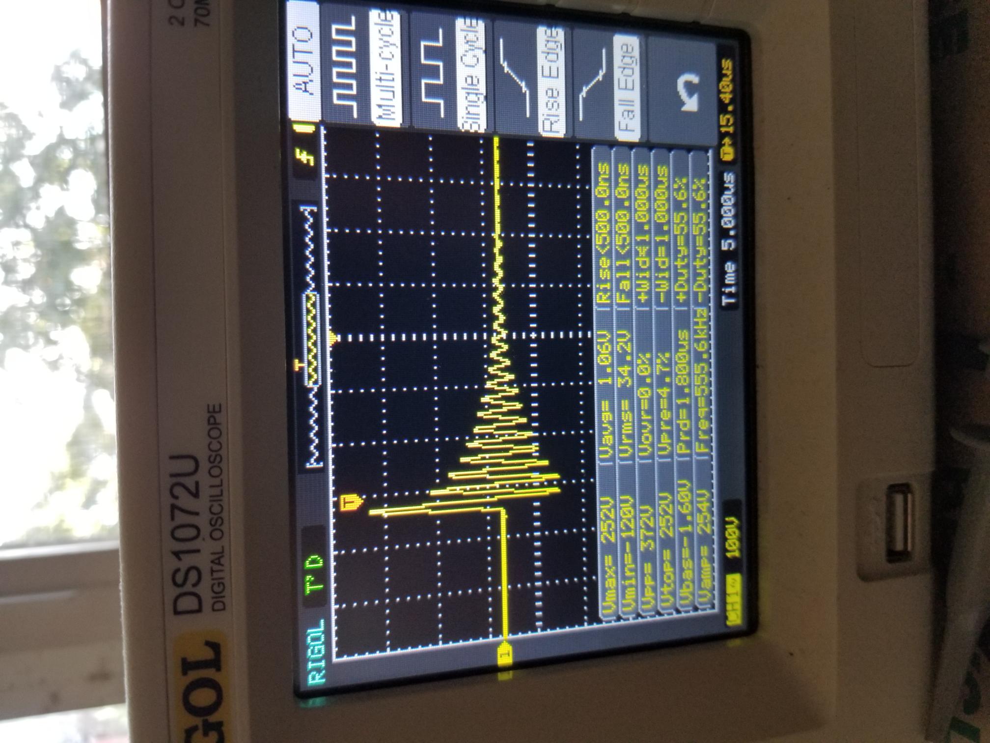

                                I re- wound the spool coil with a layer of silicon flex tape between every five wraps it is .040mills thick.
                                Both the inductance and capacitance dropped and the srf rose.
                                original Spool coil
                                540 uh
                                588khz
                                135.6pf
                                spacing added
                                384uh
                                1.136mhz
                                51.1pf
                                this is the 8 coil with too much spacing notice the low voltages
