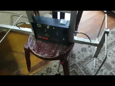

  • Front panel is done with UV printer.
    I gave myself freedom to make funny panel setup and use that logo.

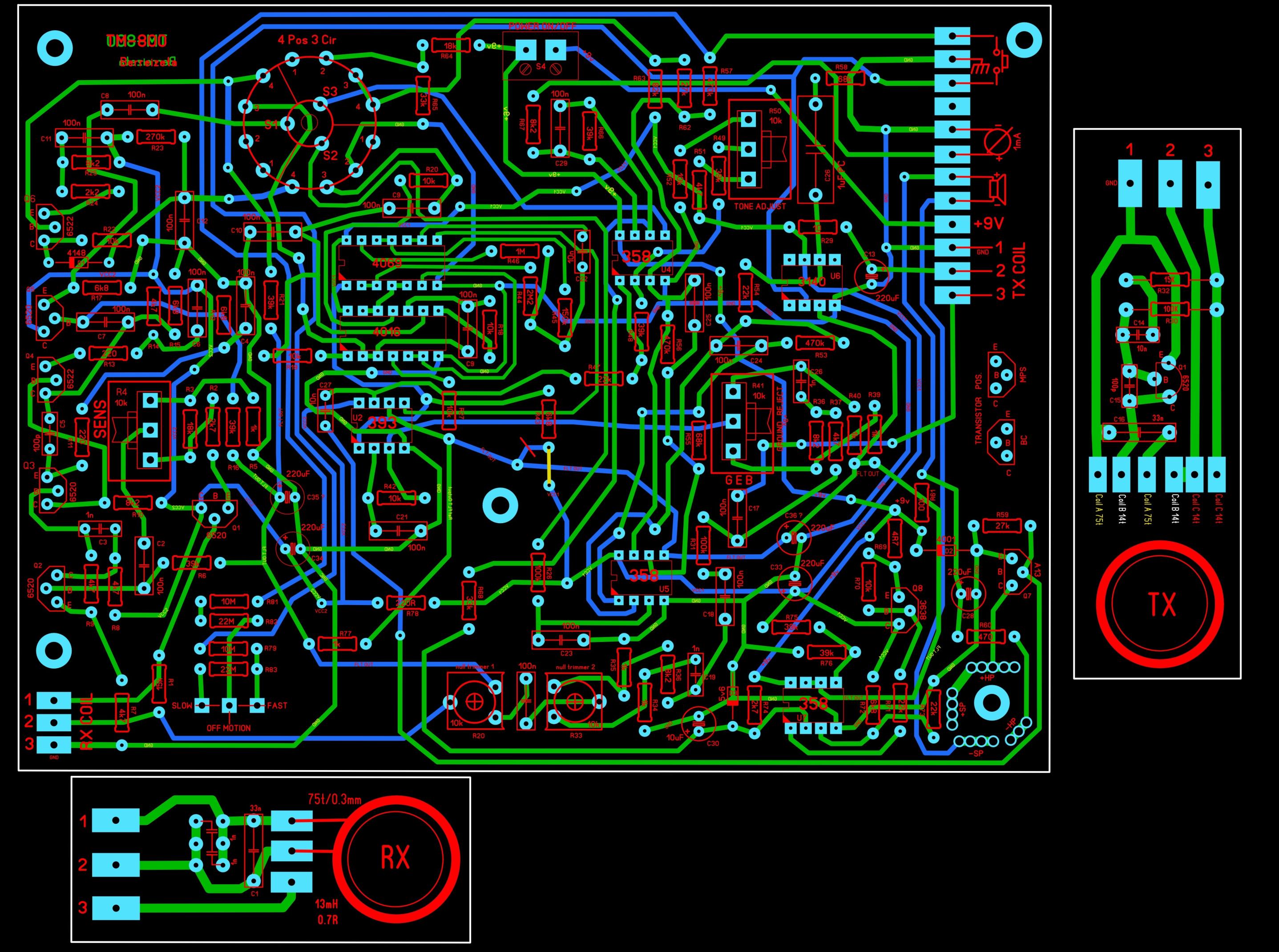

    • PCB :
      • test

                  There was only one mistake on pcb draw,
                  Berreizeta noticed it in one of the previous pages.
                  Thanks Berreizeta !!!
                  Click image for larger version  Name:	CROSS POINT.png Views:	0 Size:	113.9 KB ID:	415085
                  Once i spotted that post; I corrected it by cutting the trace and put the wire (simple fix).
                  Now with connectors in place I see quite good behavior.
                  GEB is pretty "strong" and restrictive, so the GEB pot is approx at 1/5 on the video.
                  "Fast/Slow" autotune works by the book, excellent. "Off" (non motion) is pretty stedy for quite a while and than starts singing (normal).
                  Only problem I have right now is the headphones jack; I put wrong one and it took me 10 minutes to figure out why it has no audio in speaker!?
                  I have to replace it or omit it.
                  Also I have to finish few small mechanical details and than it is finally over!
                  It was about the time... because I completelly forgot it until today.
                  • Can you use a pot lid for test?
                    If it is above 1 m, the device is good (at least in the air).
                    • Probably some of these days.
                      I have few minor mechanical details to finish and as I mentioned; headphones jack to replace or to omit.
                      Alu pipe on video is 2cm diam and very thin walls ~1mm.
                      Just for skim testing.
                      But it looks promising.
                      This device is not finished yet.
                      It was forgoten and abandoned for several months.
                      Now I got some new enthusiasm and drive to finish it as soon as possible.
                      Once is done I will perform better tests.
