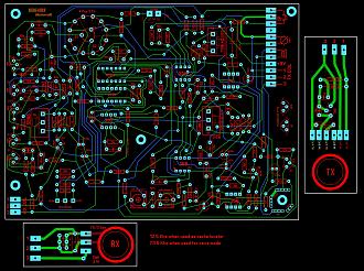

    Click image for larger version  Name:	TF900 pcb all.jpg Views:	0 Size:	828.7 KB ID:	412450
    • Pcb based on Ivconic model
      • Corrected (I think...

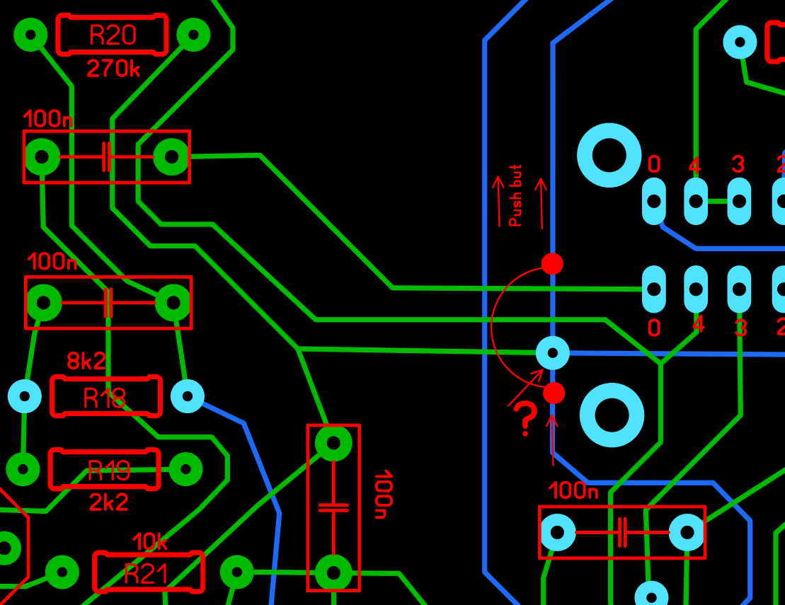

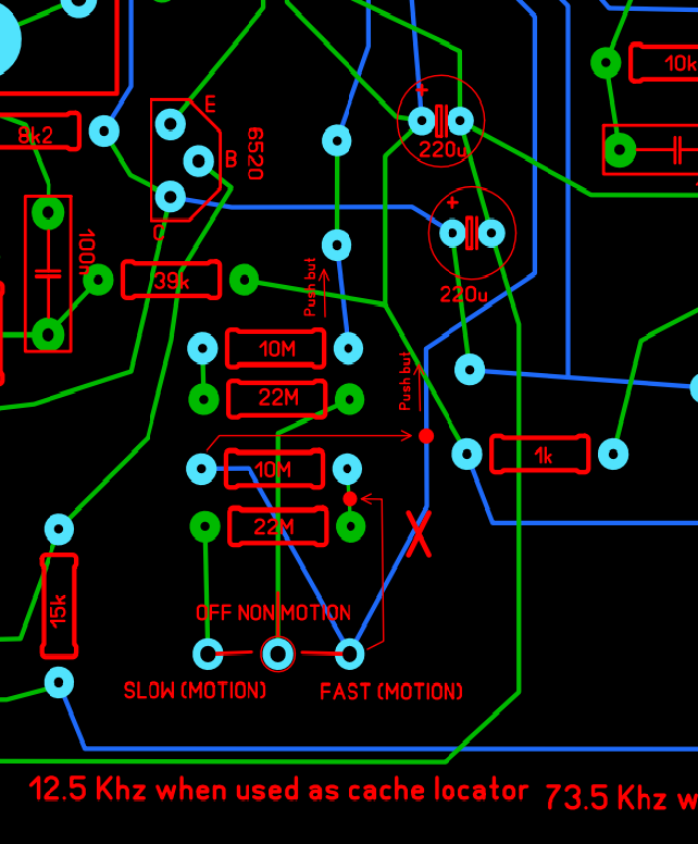

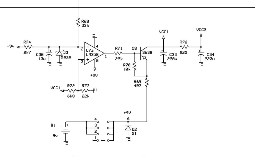

        • Hi,
          Could this 4P3T + 1 switch power on/off serve? :
Name:	ROTARY SWITCH.png
          • Looks like a 3 Pole, 4 Position rotary switch. No additional contacts for power.
            • Only S4 Power on / off, (top-right)
              I think it will work properly ..., I hope

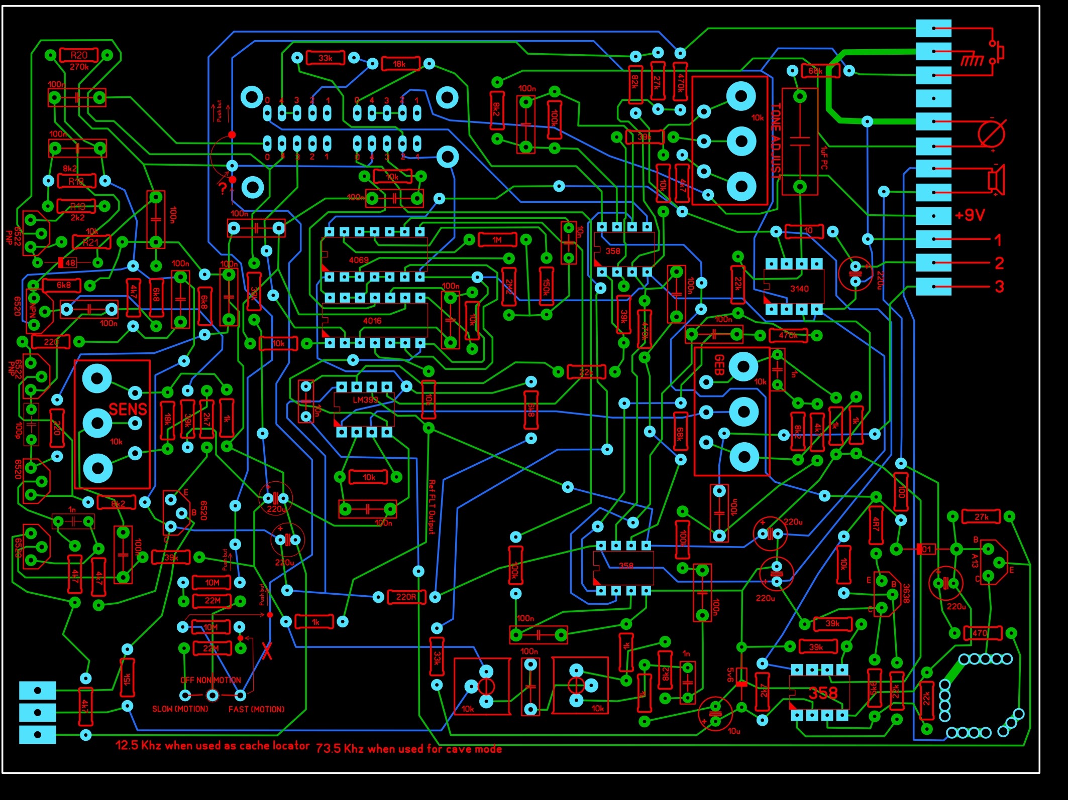

              PCB before the last revision :
Name:	TM00 PCB ALL.jpg

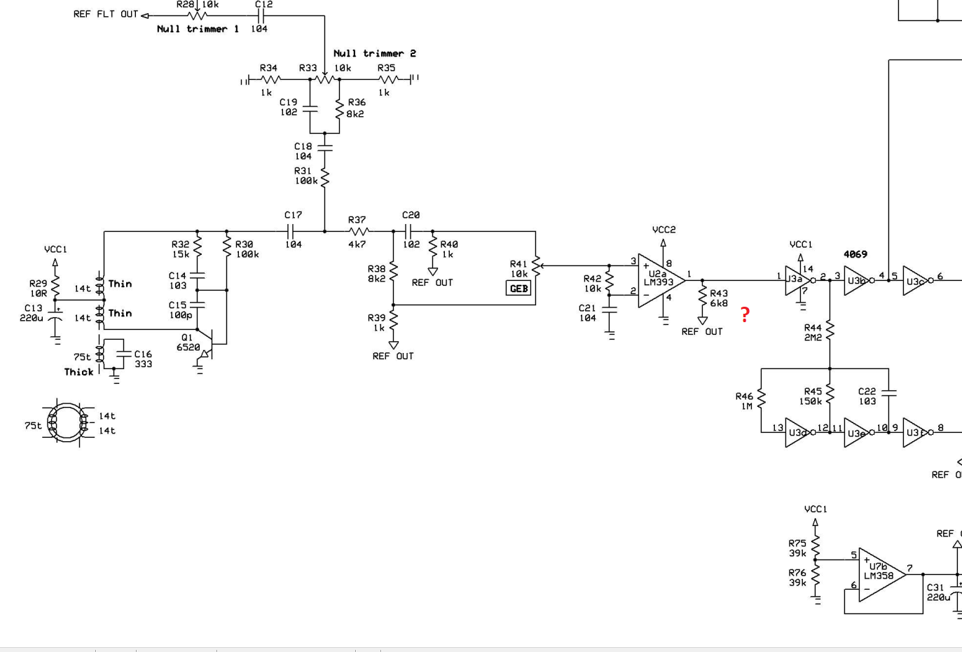

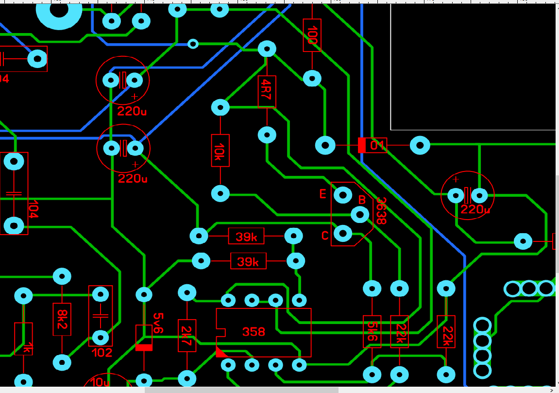

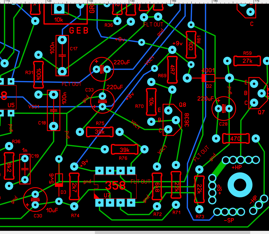

              • Hi,
                A possible correction in 3638 emitter -> 4R7 and 10k resistors :...:
                PCB Ivconic
                Click image for larger version  Name:	PCB IV 3638.png Views:	0 Size:	124.7 KB ID:	412561
                Scheme
                Click image for larger version  Name:	TM800 SCHEME.png Views:	0 Size:	81.0 KB ID:	412562
                Correctión ?
                Click image for larger version  Name:	PCB BERRE 3638.png Views:	0 Size:	247.4 KB ID:	412563

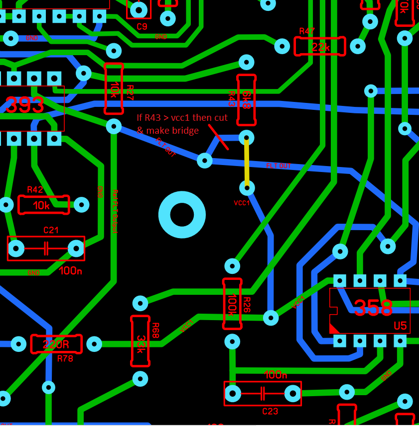

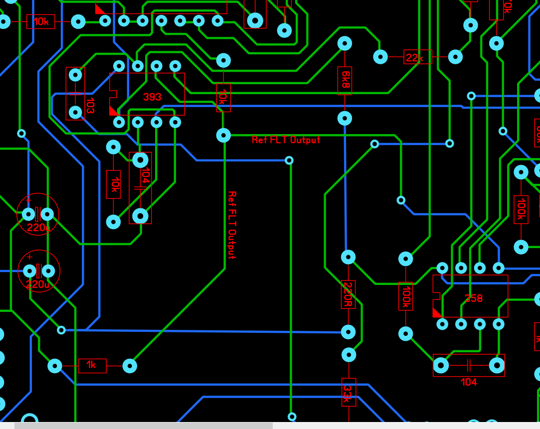

                • An other correction :
                  R43 - 6k8 to REF OUT :
Name:	R43 6K8 FLT OUT SCHEME.png
                  PCB Ivconic 6k8 -> 220R (+9v)
Name:	PCB R43 6K8 FLT OUT.png
                  • Solution to R43 6k8 to > FLT OUT
Name:	R43 6K8 FLT OUT.png
                    • Better, I leave pcb like this, and after testing, if R43 goes to FLT OUT or VCC1, it can be easily modified
Name:	R43 6K8 FLT OUT OR VCC1.png

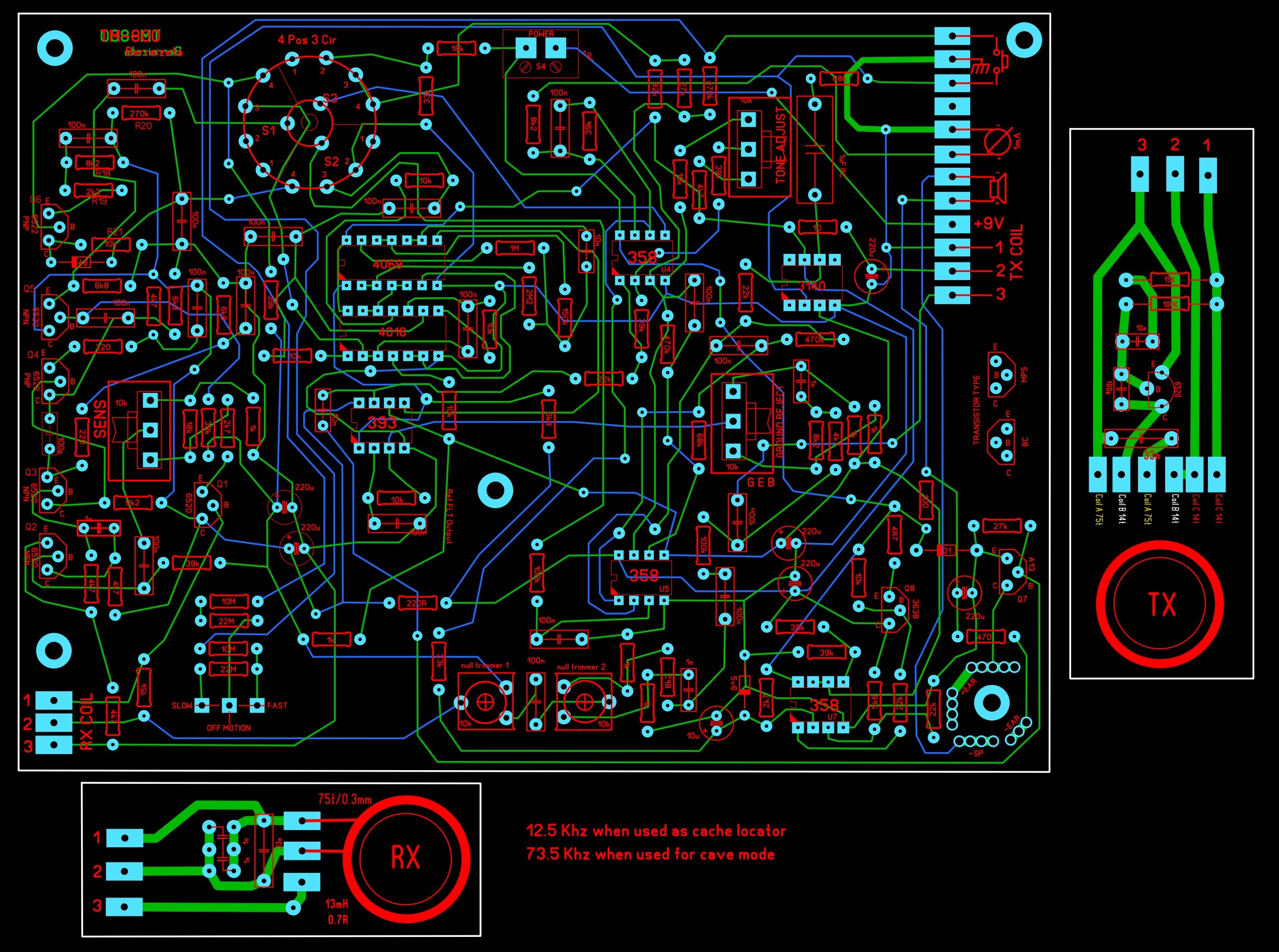

                      • Finished ! :
                        TM800 PCB ALL.pdf
                        • Hi berreizeta
                          Have you finished making Tf900? And please announce the results. Thank you​
                          • Hi to all. If anyone has completed this project, please post the results here. Tanks
